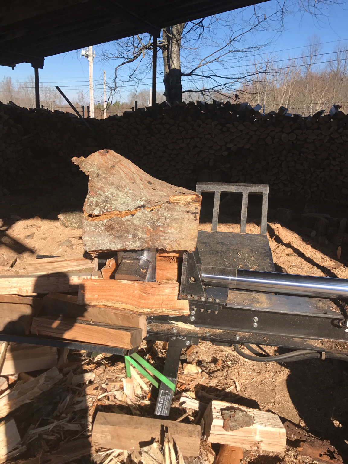

I've got a 5" bore on both of my splitters. Splitting nice straight grain red oak that's a waste. Unfortunately it doesn't always pan out that way. And you say it's a processor. That implies a several way wedge. Sometimes I have to take my 4 way off to get a piece split with that. My homemade splitter has a 5" bore 22" stroke cylinder that I bought at a salvage yard for 25 cents a pound. How tall and how wide is your beam? I understood your other thread to be it's 28" wide. If you insist on using the 4" cylinder, use 2 of them. That's a little bit stronger than one 5".

Here's a nasty piece of sweet gum that was all my 5" cylinder wanted. Here's another nasty piece of oak through the 4 way. I later had to remove the 4 way because I couldn't push a nasty piece of hickory through it. IMG_0783.JPGIMG_0784.JPG Unless you don't actually plan on splitting anything or plan on running 4500 psi hydraulics, give up on the 4" cylinder idea.

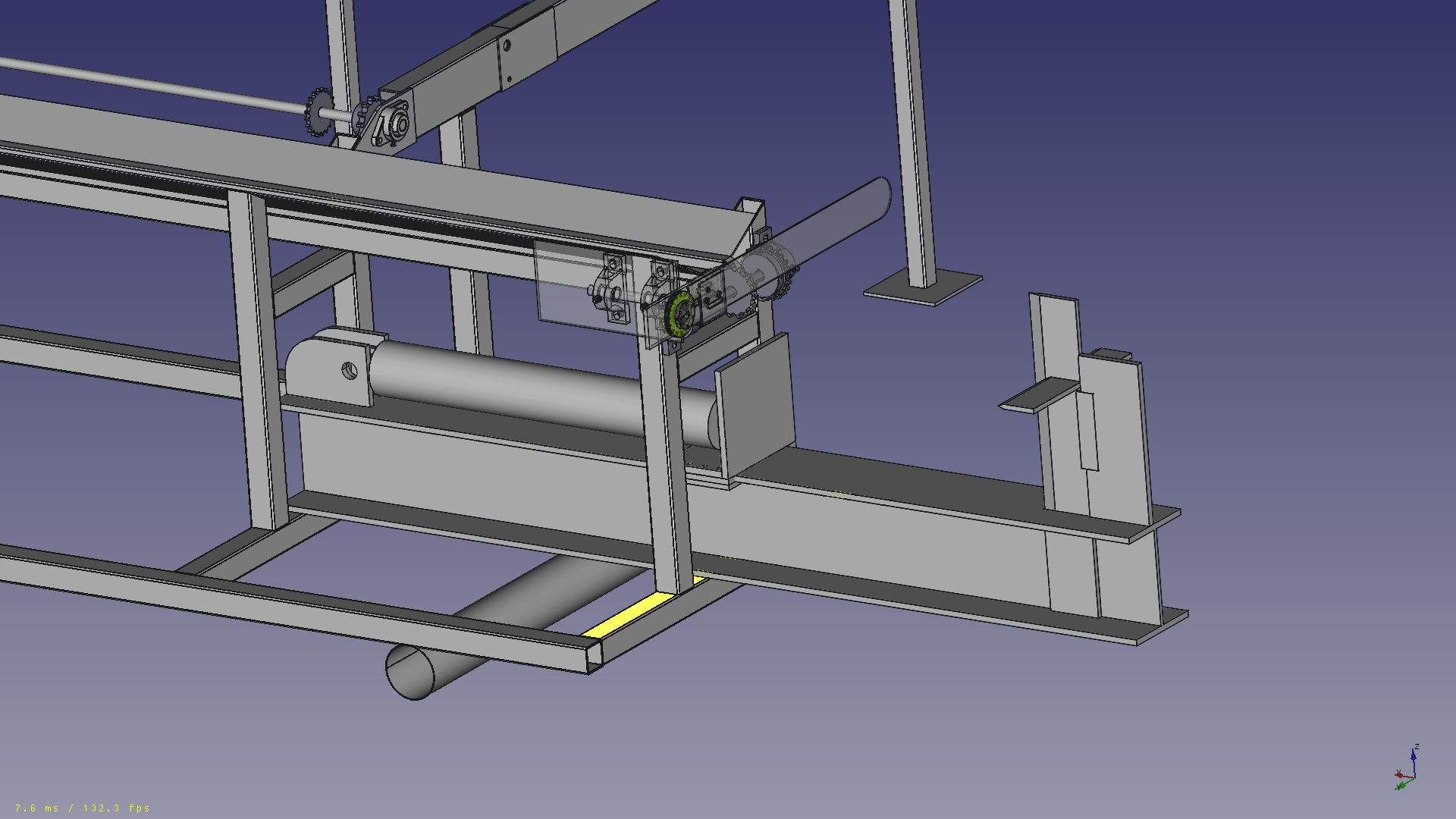

Thank you all. Muddstoper, no intend to use anything out of specs man!
Ok, I abandon the idea of 4". probably going to 5" I
I understand the bending forces on the beam. I think that by keeping the cylinder as close to the beam as possible will limit that stress. But what about twisting? Is it a big stress? I do not get how the twist force is generated. maybe from weird knotty logs?
I believe the trunnion mount will cause less bending forces since the distance between the rods is only 3.5" right?
Thats a rough CAD of the splitter part, no much detail yet though. :)Screenshot from 2017-12-11 00-08-28.png

If you were only using a single way knife the beam probably wouldn't twist. It's hitting a tough place on 1 side of the horizontal part of the 4 way that makes it twist.

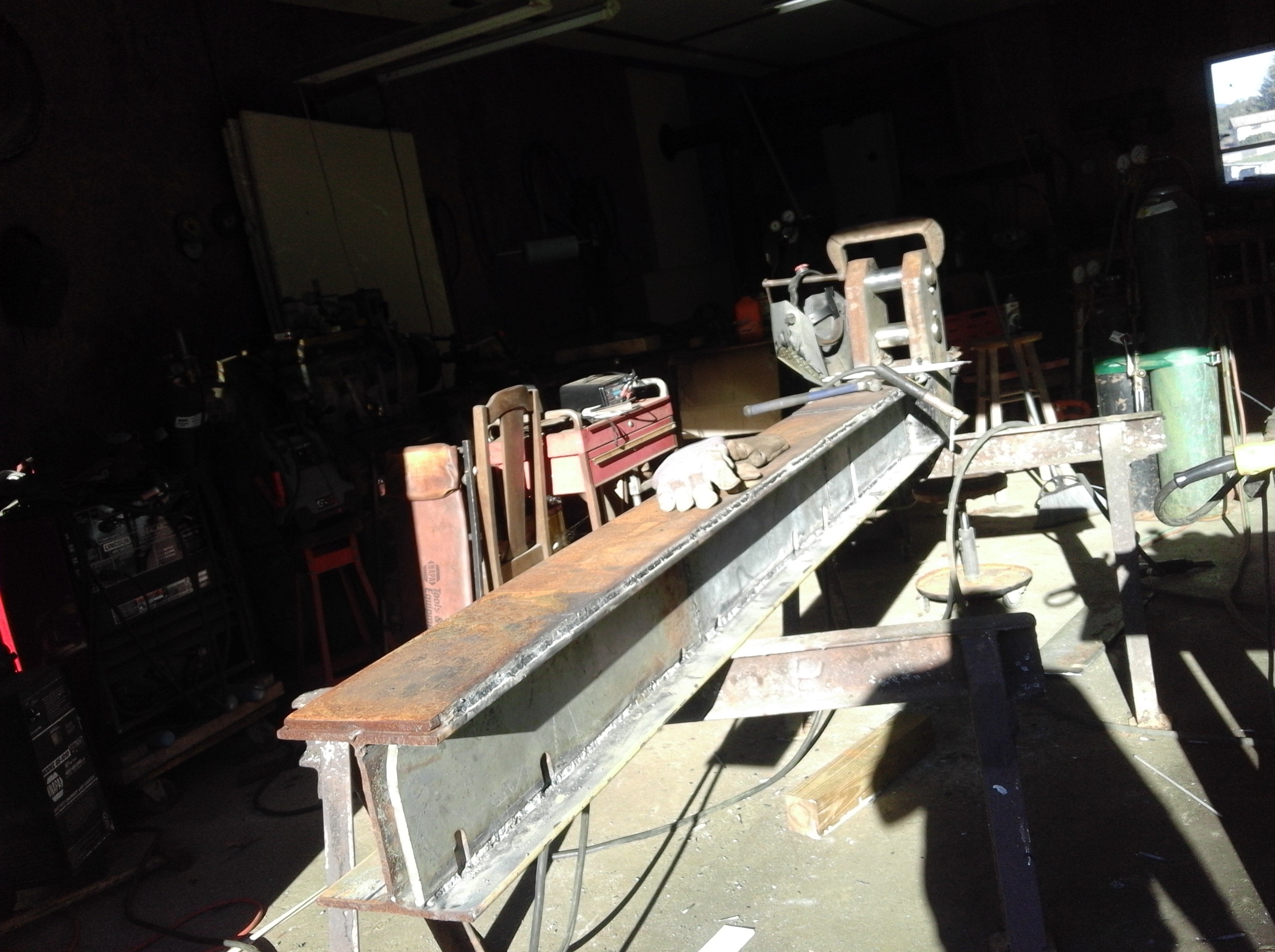

The first pic is a 8x8 by 32lb beam. You can see how I plated the top and boxed one side of the beam. I also boxed the other side.
The second pic is of the boxed wedge just hung on the beam. It will be reinforced a lot more before it over with, but the box is setting on a 36in widex 3/4in thick plated that extends about 2ft under the bean and is also fully welded to the beam. I dont know if you can tell in the pick how I gusset welded the cyl base supports into the beam. Those supports are 2in thick.

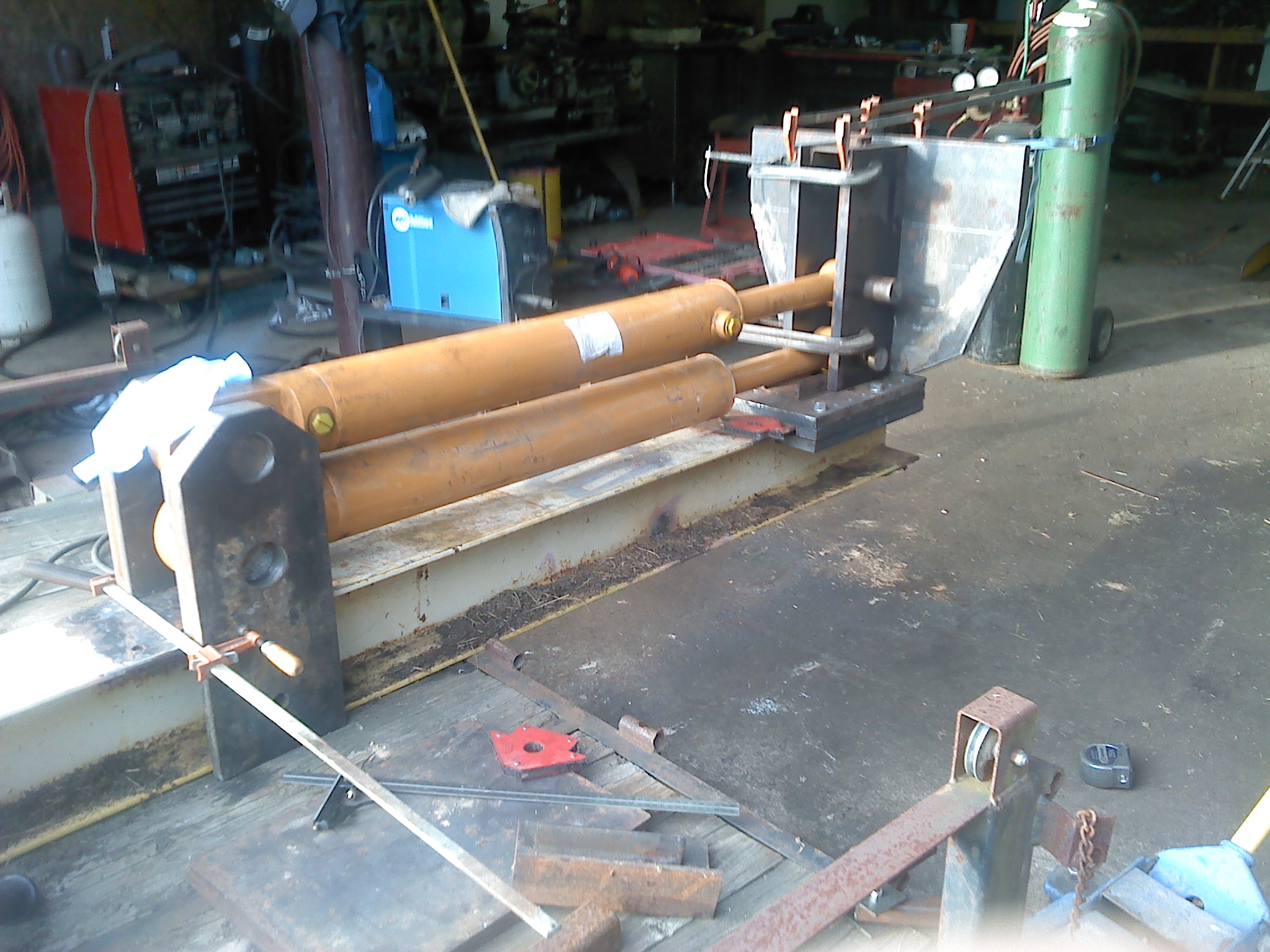

Here was my original plan for a beam. It would've been nearly indestructible. And I had the materials to do it. I abandoned that idea when I found an already built wood splitter for 25 dollars. It had a 3.5 cylinder and a single way wedge. I removed both of those and "upgraded"IMG_0794.JPG

That plating you did on the top surface gave me an idea: Do the whole length but the very end were the horizontal 4way wedge is. So I will lower the four way down and out of way if I split small stuff that need to be splitted only in half.
But where is the limit guys? What is the point that "overbuilding" something just adds unnecessary weight? It looks like I will have to learn the FEM module to analyze the stress on the metal.

I had to put my box wedge ahead of of the hbeam to be able to raise and lower it, hence top plating all the way to the end of beam. My other splitter, I just plated to the adjustable wedge so that when the wedge is lowered, the 4way is below the top of the beam the same as you are suggesting. Of course my wedge is a 6way so even lowered all the way, I am still splitting 4 ways.
I look at over building as insurance against breakage. On a normal splitter, over building leads to a heavy machine and makes it hard to move around by hand. With a processor, it doesnt matter how over built or under built it is, you still aint going to move it by hand. My truck wont care if the machine is a few hundred lbs over weight because of being over built, but my back will care if I have to rebuilt the machine if something breaks because it wasnt strong enough. Reason for over building my processor beam, twin 4.5 in dia cyl's pushing 50 tons.
