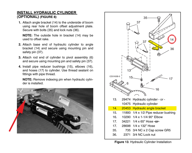

I wish to add a hydraulic cylinder to my Woods LR-700 Landscape Rake. I have everything except part 20453, which is the mounting bracket for the hydraulic cylinder. Woods no longer has this part and I have been unable to locate one.
Before fabricating something to work I thought I'd ask if there are there any other Landscape Rakes or Rear Blades that use a similar type bracket? Unfortunately, I am not a welder. I posted this in hydraulic section earlier.

A welding shop should be able to build you the bracket. You may have to bring them the rake and drawing so they can make measurements. Make sure they put the rear cylinder mount at the same height as the rod cylinder mount on the rake, so it does not bind.
