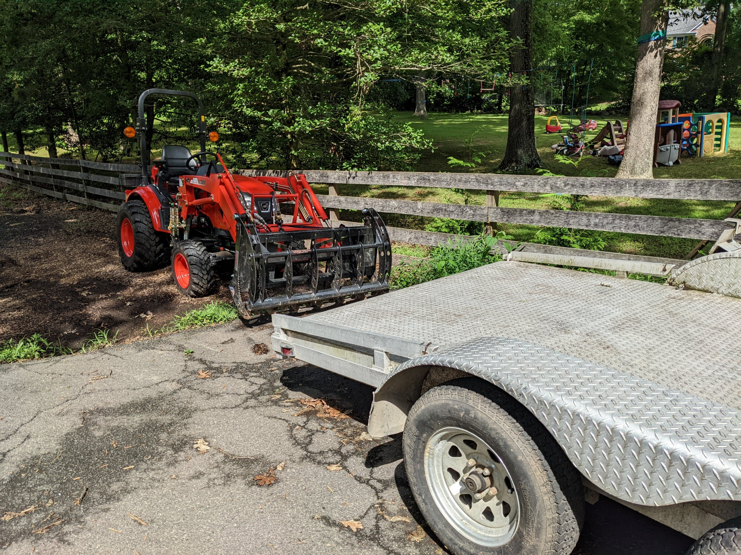

@MichiganIron - Is there a way to bypass this thing to verify this is the issue? I've already spent half a day trying to get a dead tractor lined up with my borrowed trailer before realizing the loader/grapple isn't going to clear the ramps.

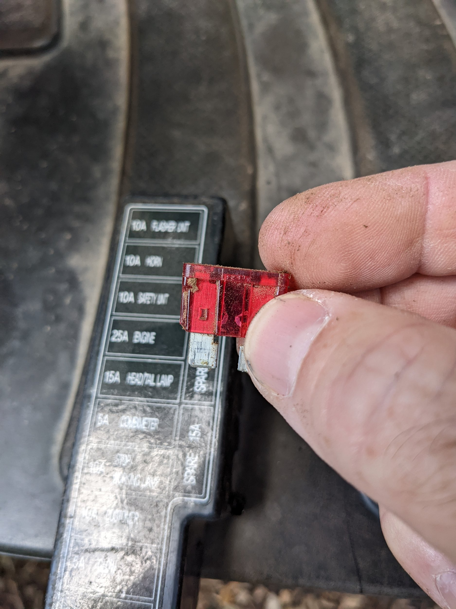

Which slot do you think this fuse belongs to??
So clearly the Safety Control Unit is significant bottleneck on this model of tractor. Obviously my issue was just a fuse but it still concerns me that if this control unit goes **** up my tractor is dead. Then the question is whether Kioti still makes replacement units when/if that ever happens.
/ CX2510 No Start - SOLVED #28
KISS...
KIOTI still stocks controller units for 15 year old tractors. I would not be concerned about the availability in the future. A blown fuse is usually a symptom of an issue, not always the cause. That is obviously the safety controller fuse. Best to try a new fuse and work with your selling dealer for a replacement Safety Controller if the issue continues. You cannot start the tractor by simply jumping the starter motor since the Safety Controller also controls the fuel solenoid signal. Certainly annoying, but at least you know it's a simple issue to deal with. Blame it on there being too many attorneys running around. Manufacturers are forced to address as many situations as possible.
Nope. And it may not be the box either. It could be anywhere in between along the harness(es), a chafe, a rodent chew, a pinch, maybe even water/corrosion in a connector.
But in general, a fuse won't blow without a reason.

So in this case it'd have to be between the fuse block and the 12v+ pin (1) on the unit right?
/ CX2510 No Start - SOLVED #32
If the fuse blows again, take a good look at the harness running along the left side of the clutch housing directly behind the clutch release lever. It's a tight spot to get to, but the harness runs in the corner of the clutch housing right behind (and close to) the release lever. If it comes loose of the harness loops, it can get rubbed by the clutch linkage.
