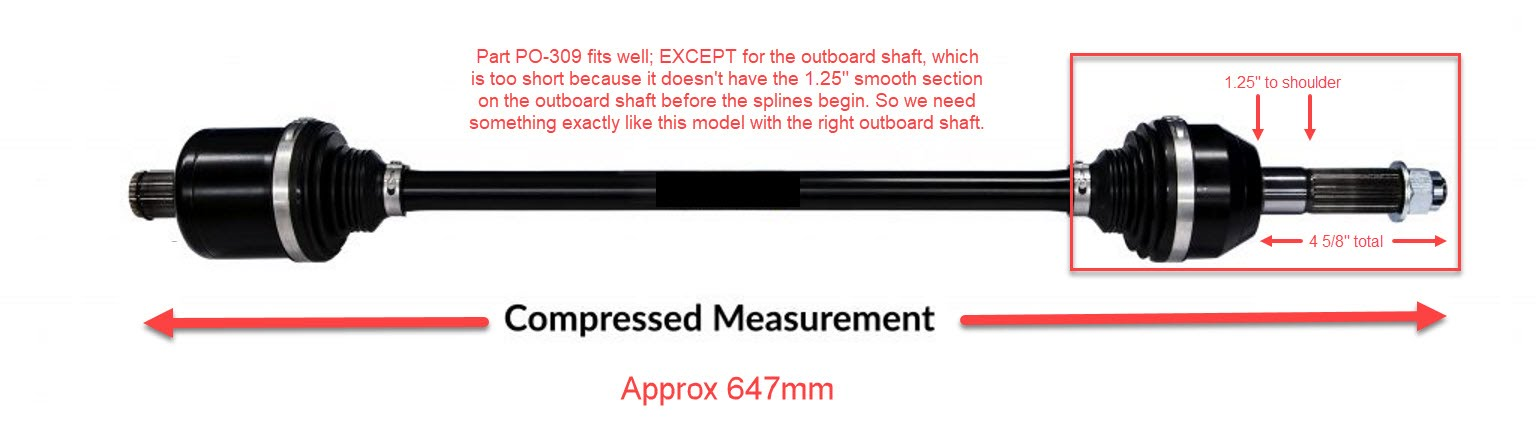

ANYONE got a match on equivalent CV axles for the TH4400?
They are not the same as the Sportman but are SUPER close, the outer shaft is just a bit longer on the smooth part before the splines start so they don't come through enough to install the castle nut.
Front CV axle measurements:
25.5" compressed
27" extended
Inner shaft: 1.75" overall length, 22 splines
Outer shaft: 1.25" smooth section to taper, 20 spline, 4 5/8" overall length
DOES NOT WORK - TRIED: ATVPC (parts connection) - eBay - fits except for outer shaft too short to fit through wheel hub
Front CV Axle Pair for Polaris Ranger 500, 700, XP 700 4x4 6x6 2005-2007
From <Security Measure>
Rear CV axle measurements:
21" compressed
23" extended
Outer shaft: 1.25" smooth section to taper, then 20 spline, 4 5/8" overall length
TRIED: NICHE industries - fits except for outer shaft too short to fit through wheel hub
DOES NOT WORK: NICHE Axle Front Drive Shaft High Strength for 2005-2006 Polaris Sportsman 400 450 500 600 1380234 1332422 2 Pack
From <https://www.amazon.com/gp/product/B07XWG7QJ4/ref=ppx_yo_dt_b_search_asin_title?ie=UTF8&psc=1>
