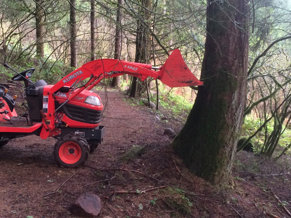

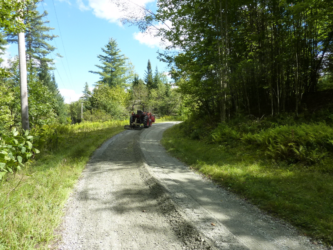

Good picture Bruce, sure makes that BX look powerful.:laughing:
That is very good. I missed it the first look. Thanks for point it out Steve. Or maybe that is just a rubber tree.

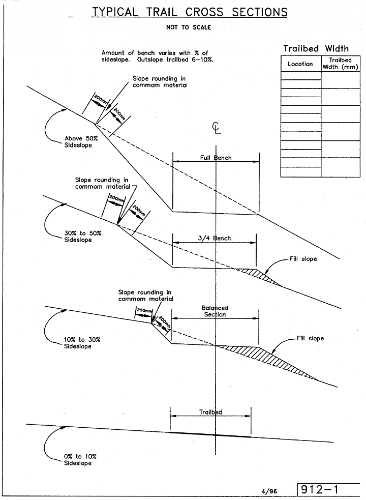

You'll want to get an actual slope measurement so that you can properly plan how much of your "bench" needs to be cut into the hill. The forest service (and pretty much everyone else) uses these guidelines for cutting side hill trails.
/ Cutting side hill trails #30

FWIW:
12" slope in 60" is 11 deg
18" slope in 60" is 16.6 deg
24" slope in 60" is 22 deg
Most people are really bad at judging the amount of slope by eye.

And in % slope those are:
12" slope in 60" is 20%
18" slope in 60" is 30%
24" slope in 60" is 40%
Especially from the seat of a tractor.
