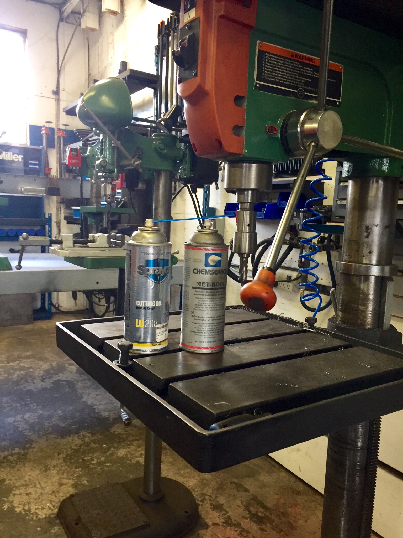

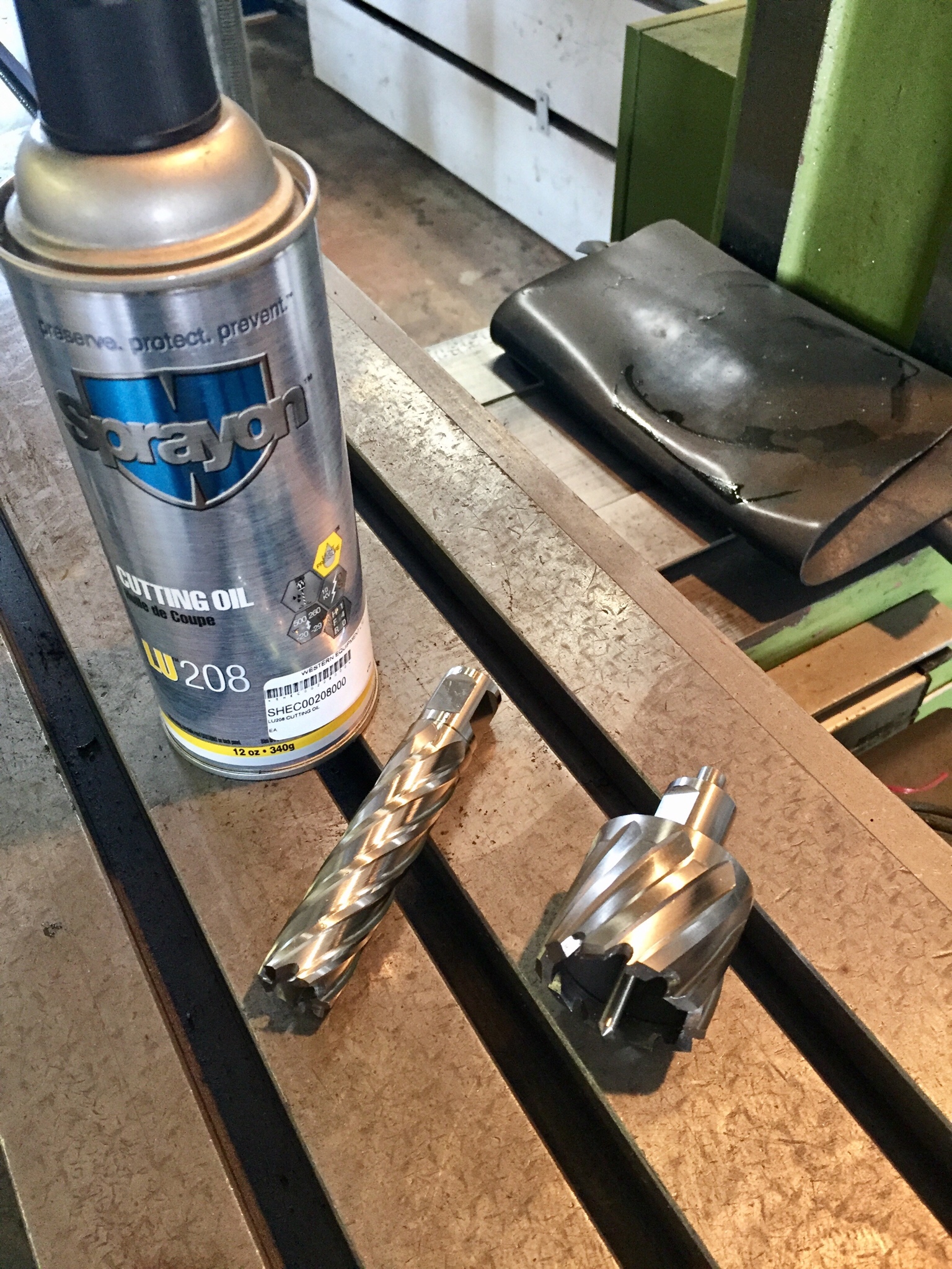

Here are my two favorites.
Terry
/ Cutting Lube #10
That looks quick and easy but still messy and $12 per can.
Using the nozzle I can apply it sparingly, but messy, yes.
(I'm also quick and easy, but cheap).
Terry

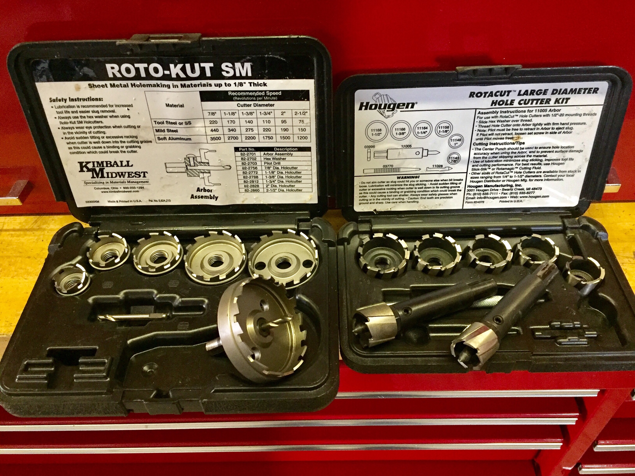

bigtlller I use sheet metal cutters (shallow annular cutters) for holes
in material 1/8" and thinner. A stream of compressed air is all I use to keep the cutter cool and to clear chips.
For annular cutters up to 3" DOC I use the aforementioned spray coolant. It is a clingy foam and works well on horizontal holes.
Terry
