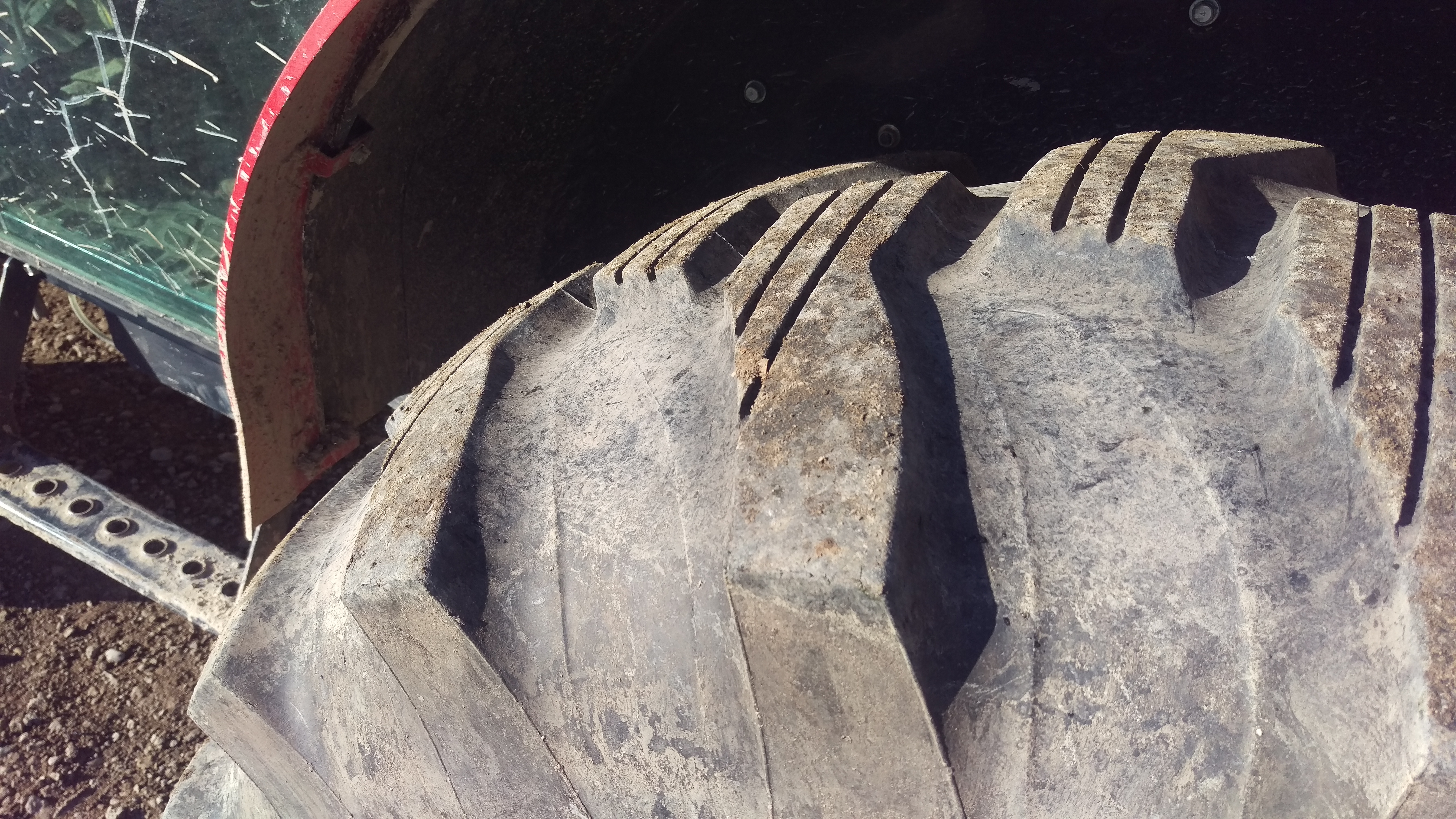

Well after making a pattern of the lugs I felt that a double grove on the rear would lead to chunking so I came up with a different pattern that would give me a double grove where the lug was thicker and would also allow for the most traction. On the front tires I used a pattern that was shown earlier in this thread, if it doesn't offer enough traction to prevent sideways slide I can always add another grove.

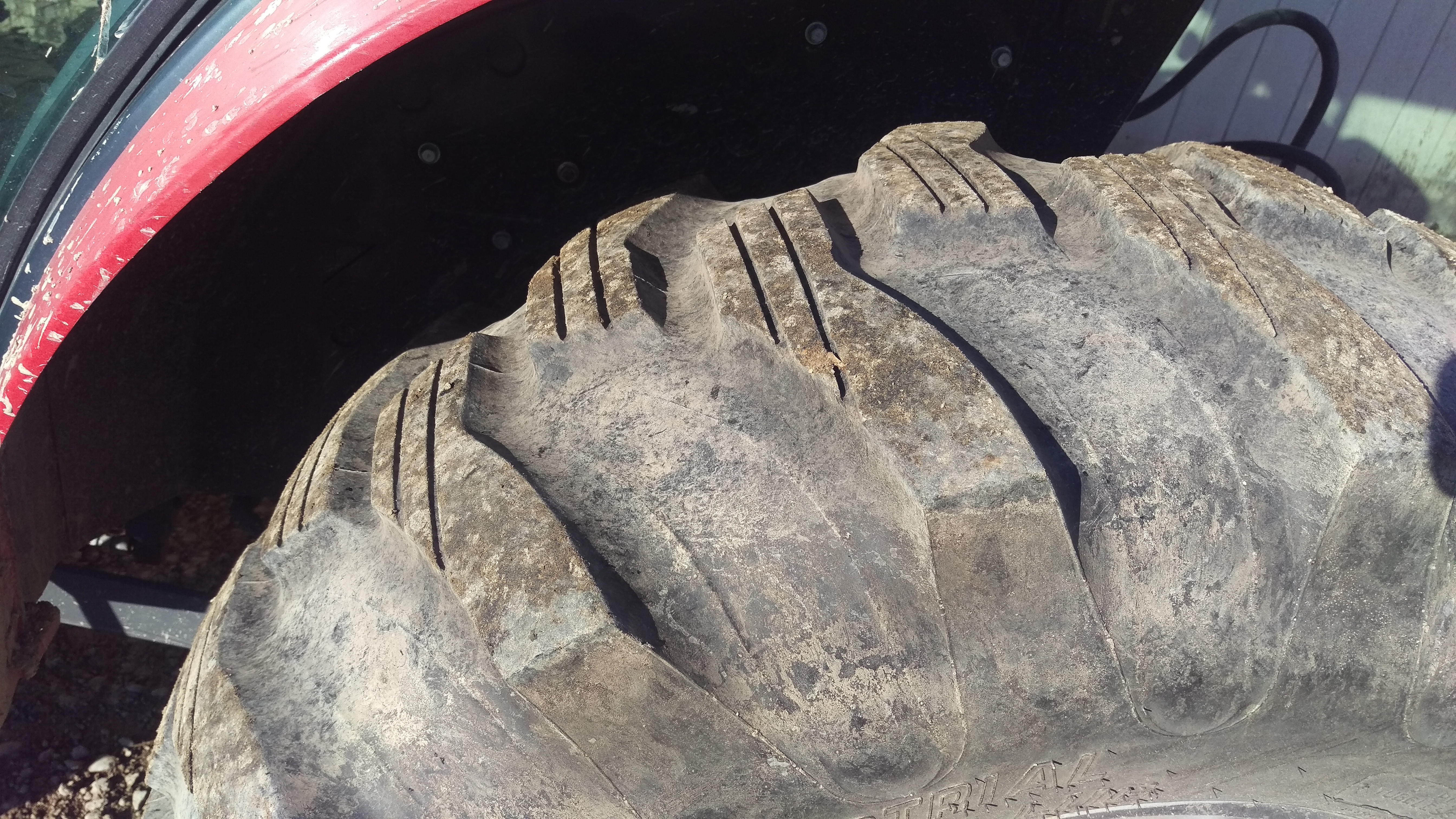

Gradehound.... I understand what your saying about the backhoe, but I don't have the backhoe on in the wintertime. When I'm plowing the most I have on the back is my log winch, have a few tight spots to get into so I keep as little on the back as possible.
The blade I use on the front is an old Myers that I've modified to make it as short as it can be.
I'm not sure how the plowing will change this year because I now have the rear tires filled which I didn't have last year.
I guess we'll see, but I think I'm going to do two groves in the rear and three alternating groves in the front.. hopefully I'll have time to do it this weekend....
Try it with the grooves you made in the fronts. Can always add some sipes or more grooves if needed. Can also always add a few hundred pounds to the frame in front of the front axle. It's tough having a blade on loader arms. You can only make it so short and with the short wheel base of the tractor there is a lot of lateral leverage!
Filling rears will neither add or remove weight from the front so it should have no impact on steering except that you'll be able to push harder before the rears spin and that could cause the front to slide out first when it wouldn't have before.

Someone had asked for a pic of my "double grooved" rears ... Finally had a chance to snap a pic...

Nice cuts. Did you have any trouble lifting out at the end of the cut? I can see that plunging in is easy due to the shape of the cutting head but pulling up and out would seem to be a bit of a trick or twist of the wrist.
   / Cutting / Groving / Siping R-4 for snow #500
Thanks for the compliment dickfoster.....It took a little practice to end the cut like you say, but a combination of tilting the iron forward on the tip along with a twist of the wrist seemed to deliver the best results.
