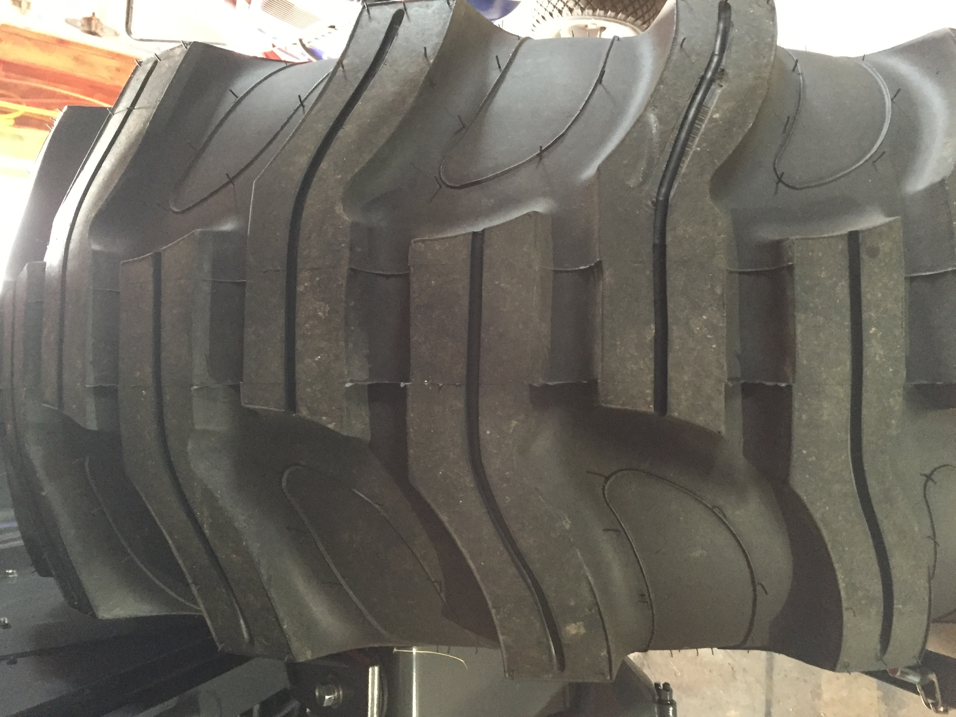

For the sake of science, you should groove the tires on your new machine...
Ok, since it's in the interest of science!
Here's the rears on the new machine:
   / Cutting / Groving / Siping R-4 for snow #482
I plan to do mine this weekend, but I'm considering a double groove on my rear tires. I haven't settled on a pattern for the front tires yet.

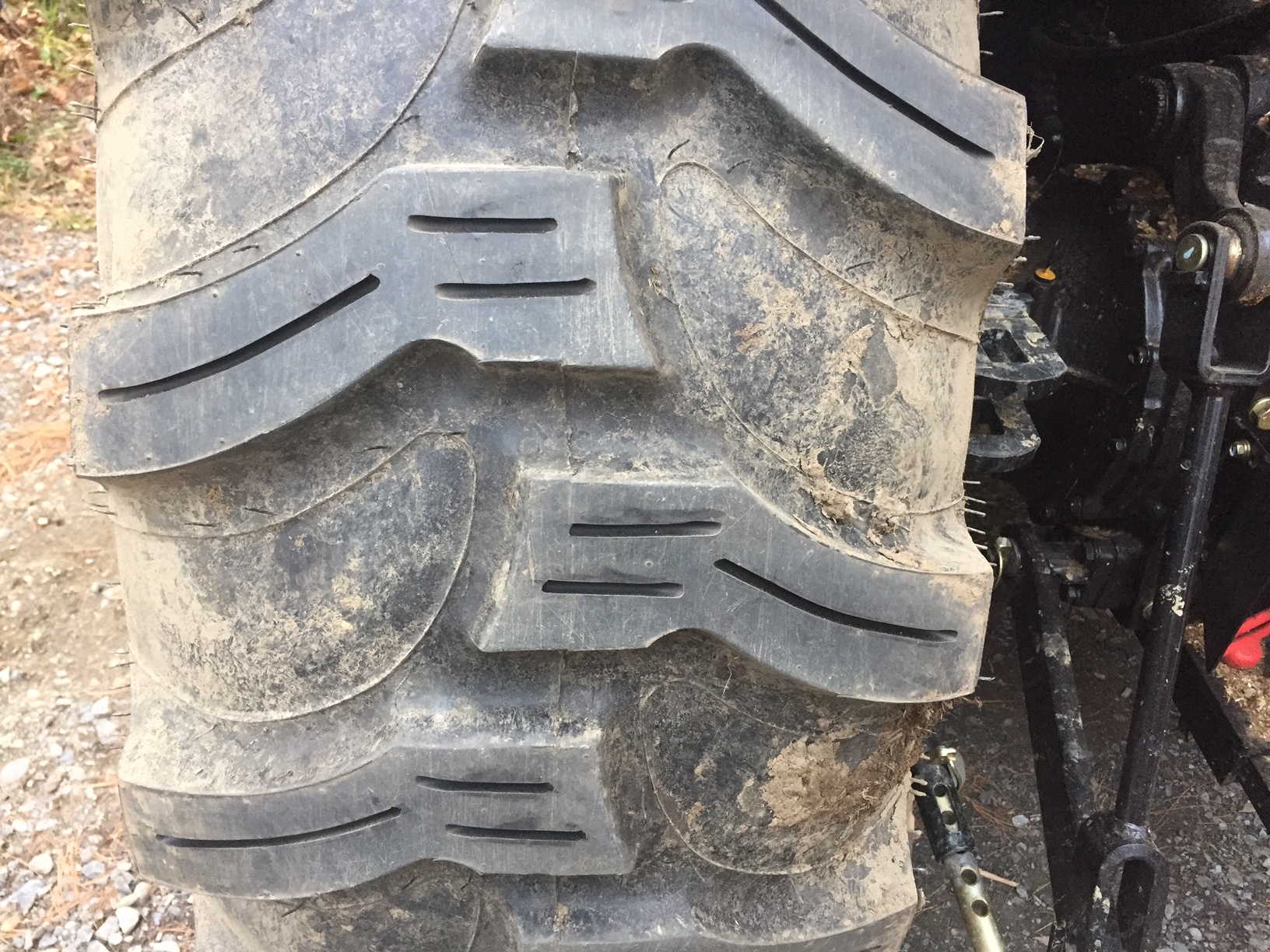

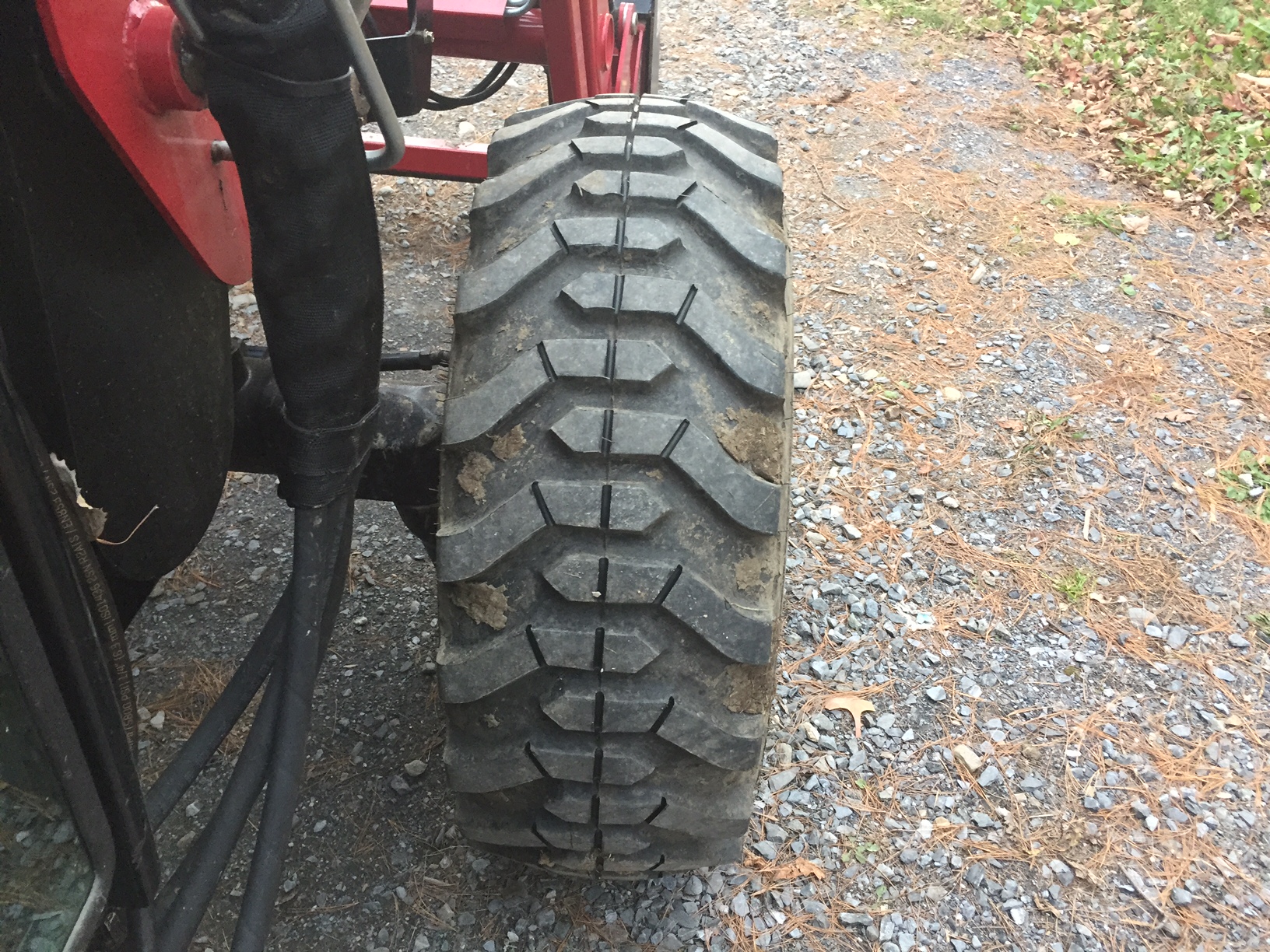

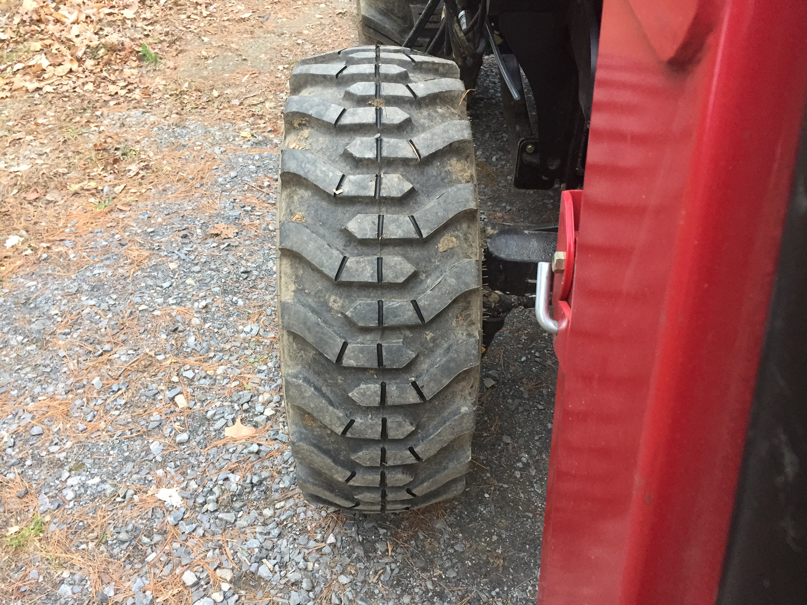

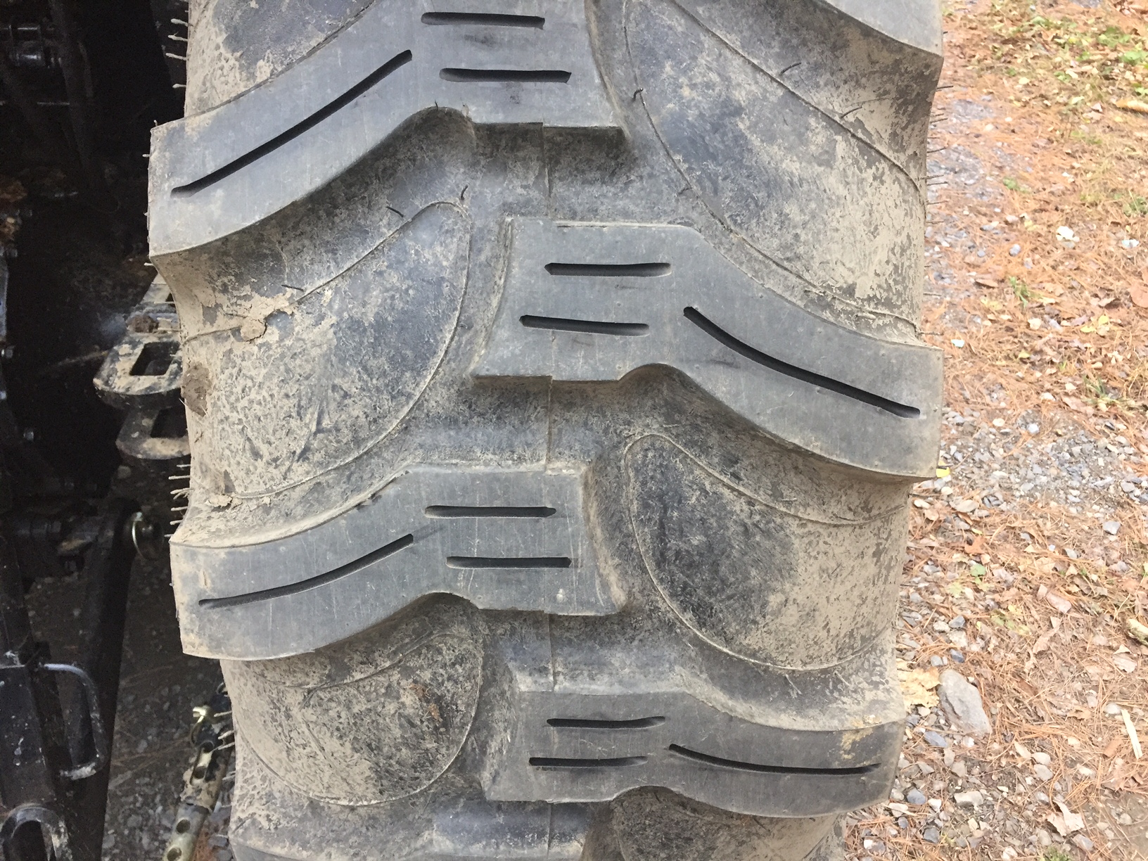

Well after making a pattern of the lugs I felt that a double grove on the rear would lead to chunking so I came up with a different pattern that would give me a double grove where the lug was thicker and would also allow for the most traction. On the front tires I used a pattern that was shown earlier in this thread, if it doesn't offer enough traction to prevent sideways slide I can always add another grove.
