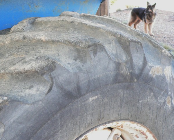

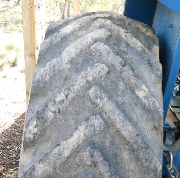

I was just about to buy the chain and shackles to try to improve the grip on my Ford 6000 tyres but there is very little clearance between the tyres and the guards and fitting spacers onto these monsters would be a real hassle. As you can see in the pictures the rear tyres are badly worn but I can't justify $1500 a tyre to replace them when the beast is only used to grade the roads and clear the fallen branches etc in the scrub.
We don't get much snow here even though winter temperature goes down to minus 12 C - the problem is lack of traction on the dirt roads and in the bush especially when reversing up a steep slope when the rrear wheels just spin. This is why I found the discussion about siping very useful so I want to give it a try if you experts suggest it. Do you think a single cut along each tread bar would do, OR maybe longditudal cut plus a couple of 90 degree cuts?
Unfortunately, siping tools here are over $400 and the US ones don't run on our 230 V without a transformer, so options seem to be:
a) a butane torch with cutting tip - a bit small for the job
b) an electric soldering iron with modified tip - might work
c) a router - scary
d) a Dremel-type multi-tool with a cutter tip - might be best
Comments and suggestions most welcome

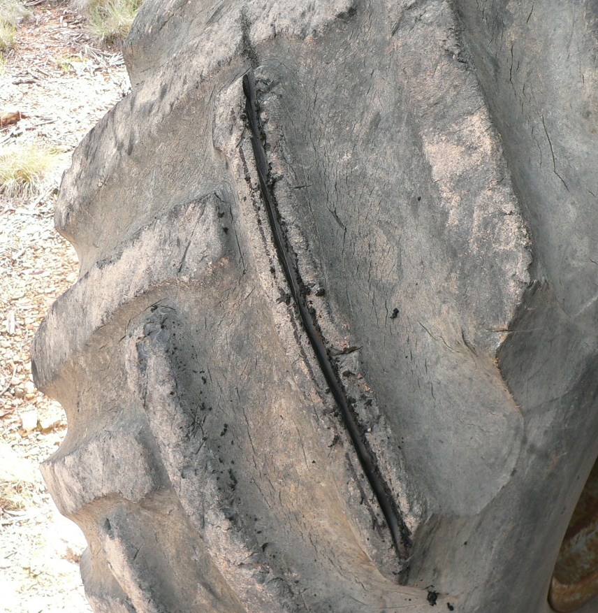

Actually - since last post, I think I have solved the tool issue - tried a 4" angle grinder with a nice fat cutter -It seemed to work well - slow but created a neat groove about 4 mm wide and 4 mm deep. However - the guard had to be removed to stop hot rubber building up between the disk and the guard. Later I tried a 4" abortech cutter in a 5" grinder so the extra clearance meant the guard could stay on - it did a much better job - faster, less heat. less mess and a nice clean cut
My other question remains - one cut or two and what about perpendicular cuts? The picture shows I made just one off centre. Would two weaken the tread too much?
Cheers
Alan
