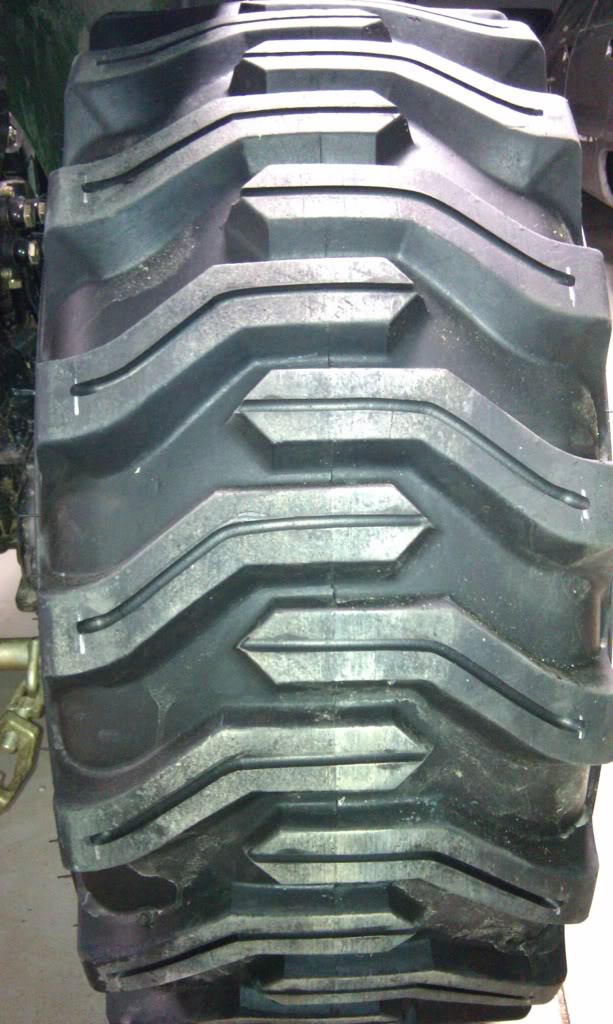

Sorry about being slow on answering your questions.....Yes, it is a 2520. I used two different cutting heads. The front tires and the outer lugs on the rear tires were done with a #4. I used a #6 on the rear center lugs......very happy with the setup so far.

It's been nearly a year and I wanted to give a report on how the tires have held up with the grooves - they have held up well. There has been no chunking or tearing anywhere on any of the tires. I've pulled logs and pushed over trees. I've pushed into piles until the wheels spun. I've spun the wheels on dirt and on hard packed gravel. The tires are plenty stout even with the grooves.
As for traction, traction has been helped in every situation. But the most noticable improvement is certainly in snow and ice. The least noticable is in mud where I don't think small grooves or sipes really help in a noticable way. The extra biting edges do seem to help on hard packed dirt.
So far I have about 80 hours since I gooved them and I'm very happy that I did. If I do ever notice any detrimental effect from grooving them I will be sure to report it here.

After slipping down and not getting up the hill the last snow, I grooved my tires like the first poster. WOW! We had 6" of wet snow last nite. I pushed snow down AND back up (6' FEL!) I used the #4 groover set 1/4" deep. Took about 1.5 hrs for all 4 R4 tires. This is worth doing. My hill is very steep blacktop and the Deere crawled right up.

I just ordered a Grover with #4 &#6 cutters hoping to avoid installing rear chains, but I did order ice cleated chains for the front.
Question.
Did you use the same grove pattern Or something special?

I did mine like this front and back.
