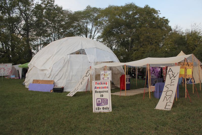

We run a theme camp that we take to Burning Man regional events in the southeastern US. Well, in principle, we take it to "events in the southeast," but in reality, we have only ever taken it to Alchemy, the Georgia regional, which is our home burn. In the years when we've had the dome, we have only gone to Alchemy and not any other regionals. If we were going to another regional, we would consider taking it. The dome is used as a common area for the camp, to hold workshops on various topics, and that sort of thing. At night, it's kind of like a night club or dance club.
Covering the dome was really challenging. The dome is 50' in circumference across the top. One common way of covering such a dome is to buy a decommissioned parachute silk of appropriate size. This works really well at Burning Man, which is held in the Black Rock desert near Reno, NV, because it almost never rains. The silk provides shade, but isn't really waterproof. We intended to buy a 60' square tarp, but every place we found that had them listed for sale actually showed out of stock when we tried to order it. Ultimately, what we ended up doing was buying three 10x30' tarps and a single 40x60' tarp. The 10x30' tarps make a "belt" around the base, and the 40x60' tarp makes a "hat" over the top. This still leaves some un-covered area near the door where rain can be an issue, but it's adequate.
The doorway is created by removing one of the horizontal poles from the second layer, leaving a diamond-shaped opening. We found that people tended to trip over the narrow bottom of the diamond, especially if they were... shall we say, not completely sober... so I fabricated some custom struts to create a doorway with vertical sides and an A-shape at the top. It compromises the dome's structural integrity slightly, but the tradeoff is worth it.
Here's a pic of the dome at this year's Alchemy.
The "front porch" off the front of the dome is a single 20x20' tarp with custom poles (just 2x2's really) and guy lines holding it up. It's not part of the dome, though.
