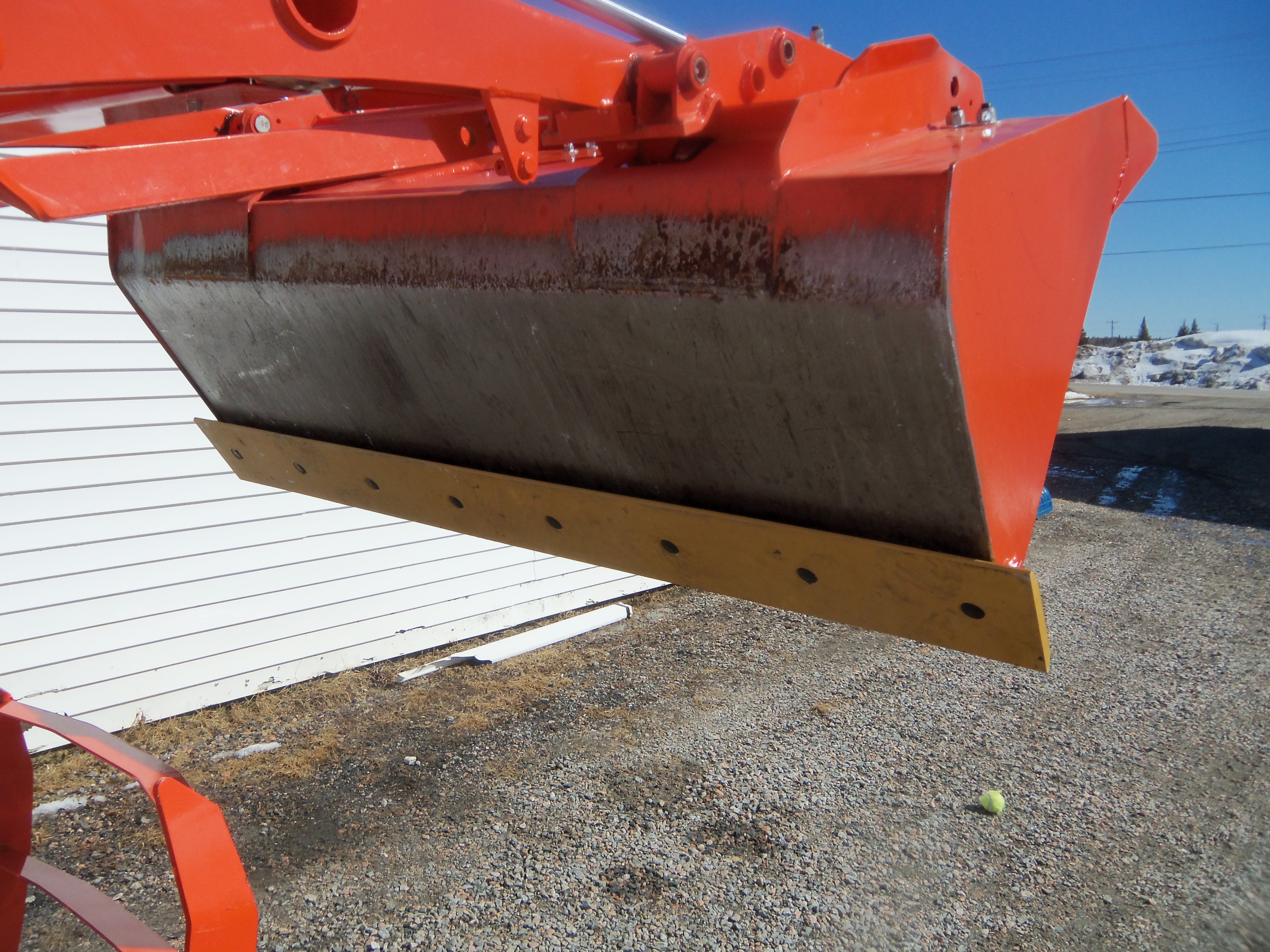

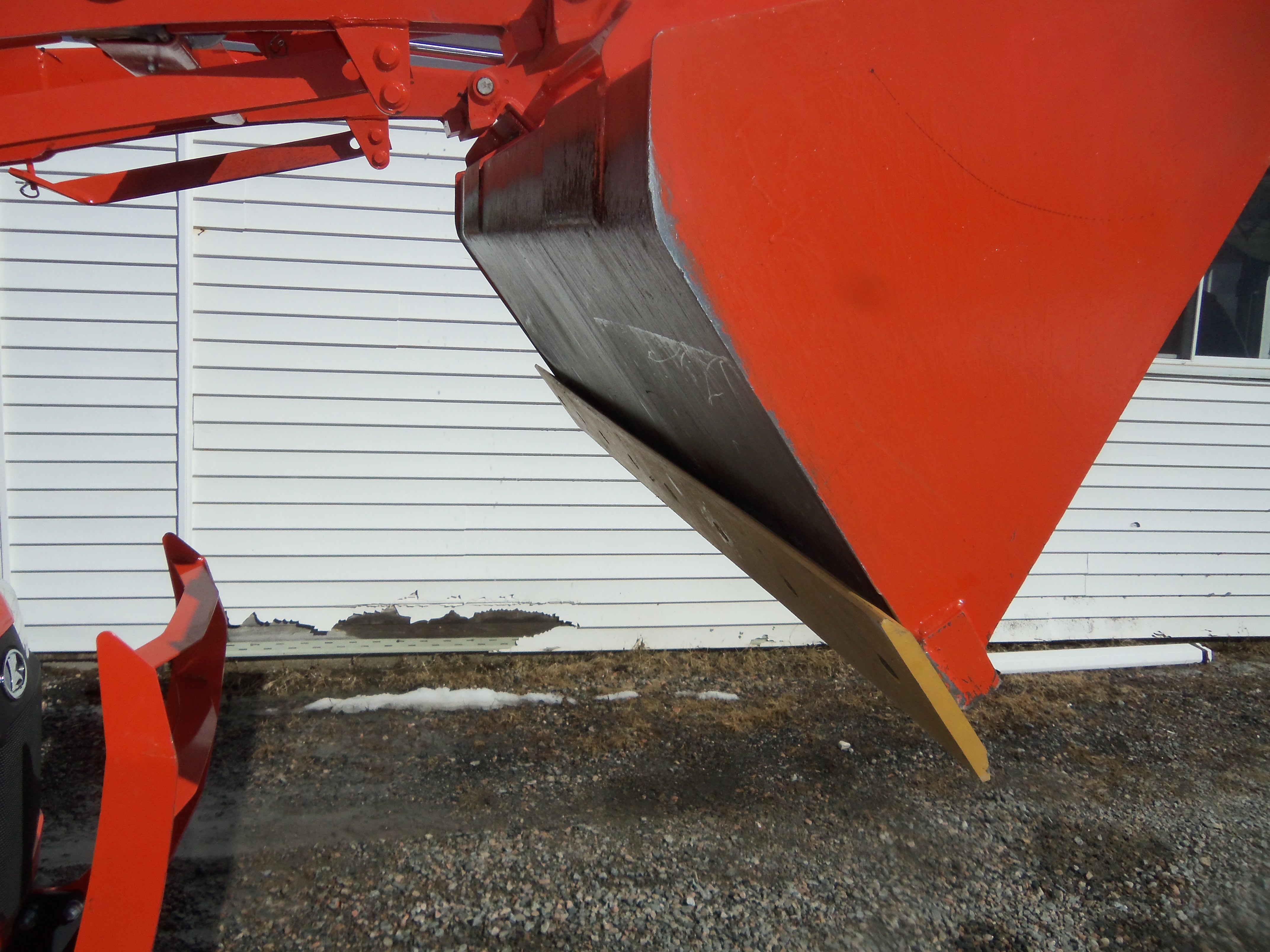

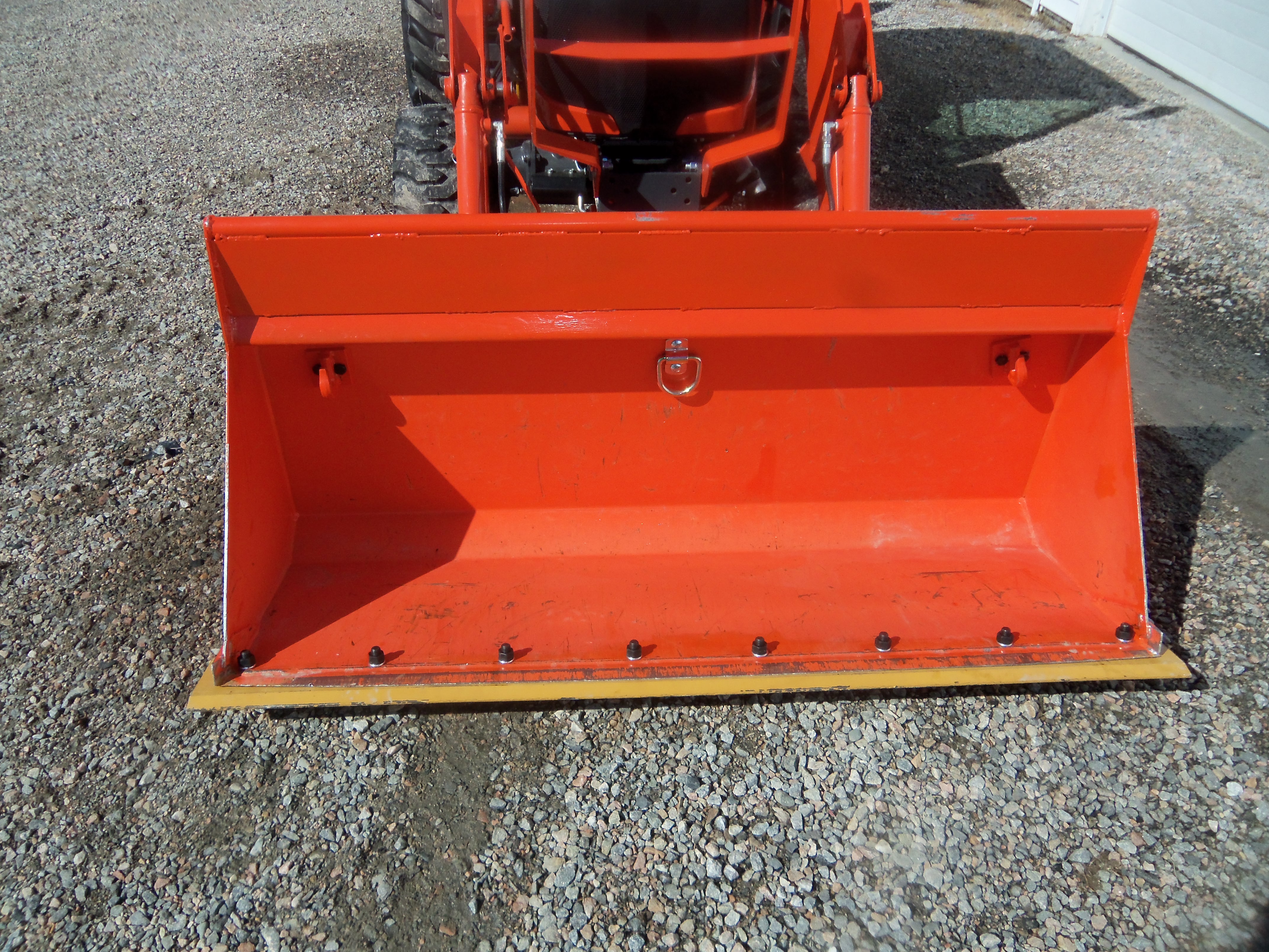

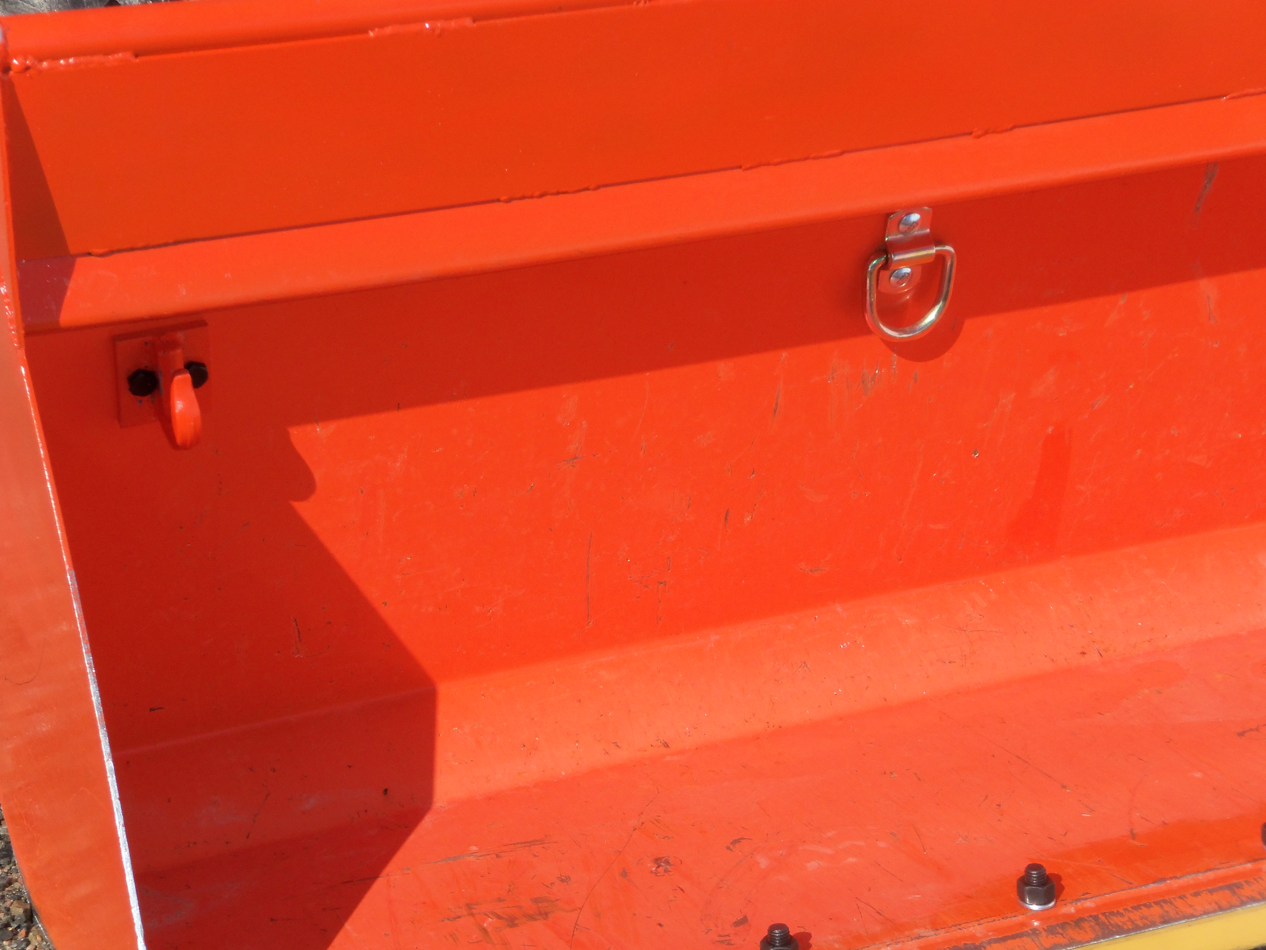

Well go my cutting edge on the bucket today look good .Only thing am wondering if I shud add some steel bars under or behind to make it even all the way maybe a few flat bars . I also added some hooks and ring inside the bucket. Where good to go now .:cool2:

nice work & equipment
had you considered a bolt on tooth bar, or is the edge more suited to your work?
as far as excavation, have never looked back on mine or missed the bucket edge itself.
good job, hope it serves you well
