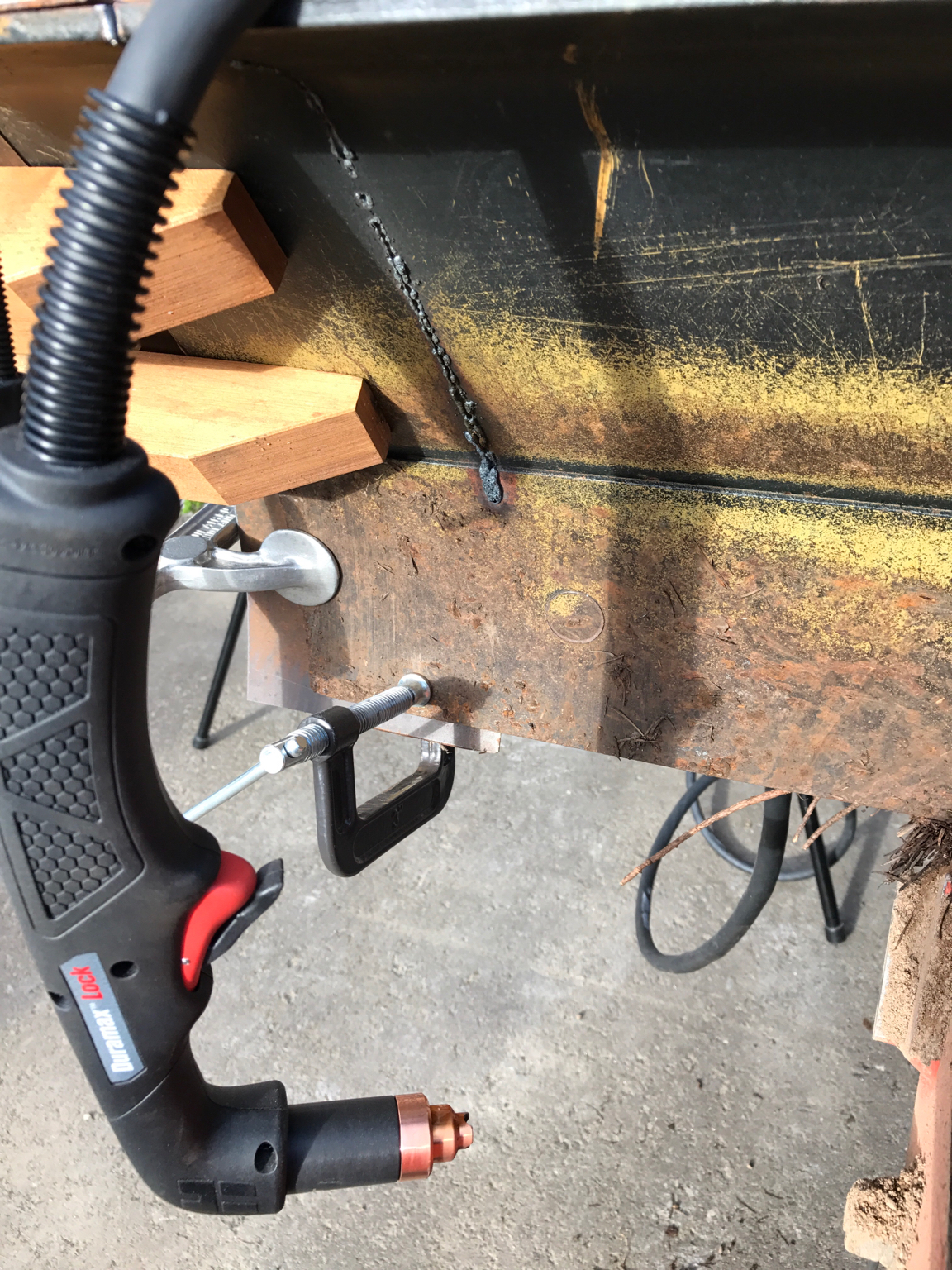

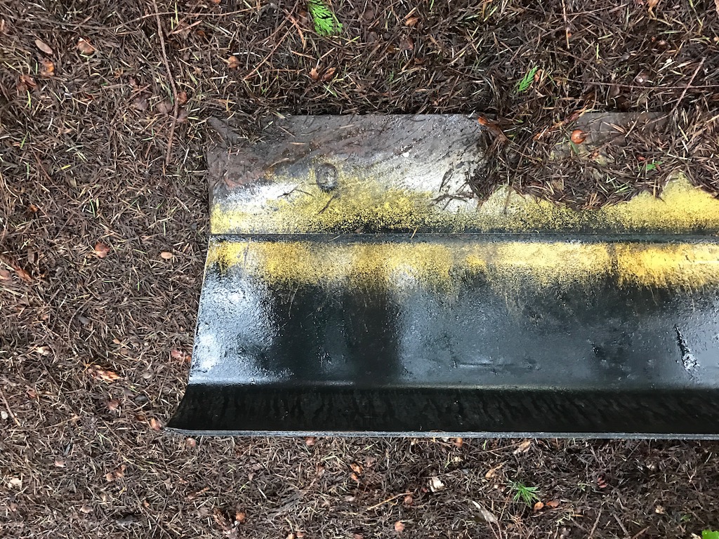

Job done! Took longer than I thought only because my welder, plasma cutter, and air compressor are all sharing one 220v outlet. What a pain! I really need to put in a sub panel and bring more juice to my shop.
Plasma easily cut the 1/4in but struggled with the 1/2in. Got some ideas why but think I will start a new thread in the welding forum because I don't think it is a simple solution due to the tapered thickness of the cutting edge.
What plasma cutter do you have? You can just max it out and go slow to go slightly over the rated thickness...assuming it is a hypertherm. Mine is rated for 1/2 but it will cut 5/8 fairly cleanly if you're patient.

I have the Hypertherm 45xp and turned up to the max. Several potential issues. First I am running a 100ft extension cord from a dryer outlet so maybe that doesn't help. But I didn't trip a breaker. I was going very slow and it started cutting fine at the ends (1/4in thick) but when I approached the thickest (1/2in) it didn't want to cut it. Lots of rust and paint... does that matter? Tons of dross that I had to grind off.
I was thinking maybe the 45xp auto adjusts for thickness when it starts and if the material thickness changes during the cut, maybe it can't adjust on the fly? I was drag cutting and it was hard to pull smoothly on the rougher and sloped surface. Until now I have only cut thin clean material that is flat and horizontal. Lot's to learn.

Dragon, your PM45XP should have less problem with that thickness than my older PM45, and mine will cut up to 1" material - it's REALLY slow at that thickness tho, rated speed is 4"/minute with 1" material -

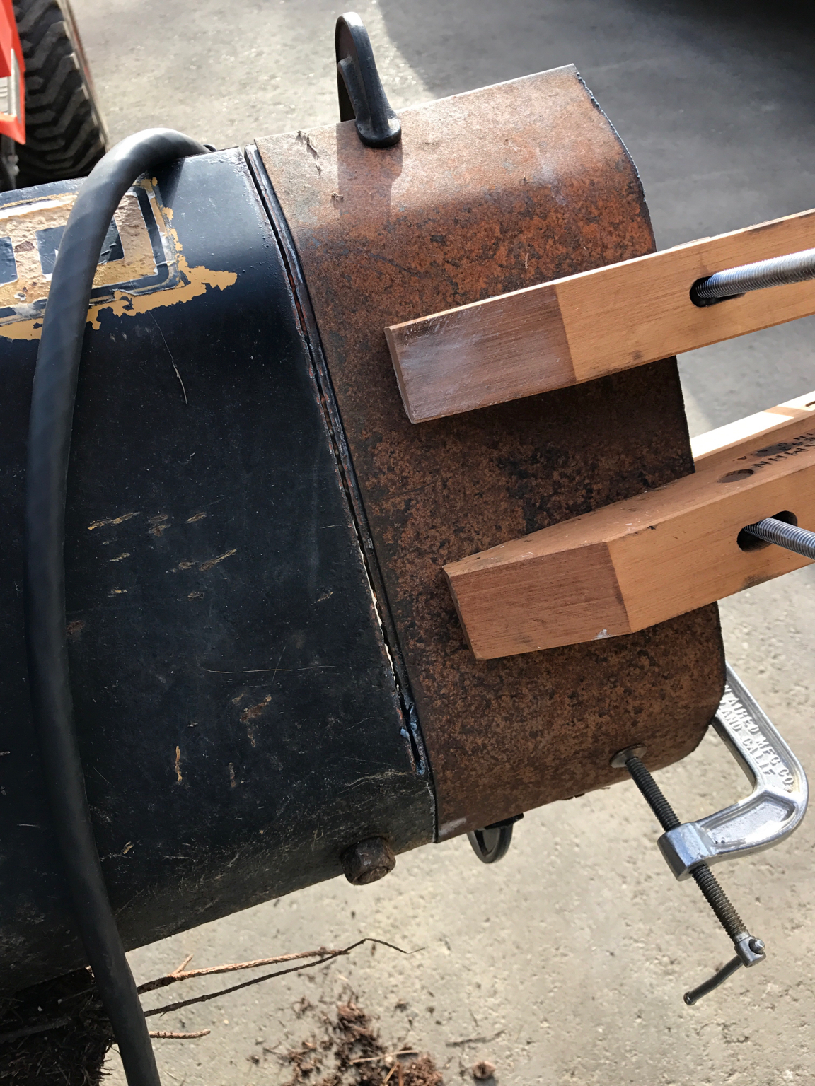

Also, those bolts look like standard plow bolts, they have a square shoulder between the head and the threaded part - if you got a nut a bit loose, it's possible you pushed the head out just far enough for the shoulder to MISS its square hole - whatever, when you put the cutting edge (most of it) back, I'd recommend making sure the square holes are good (might be able to mig 'em a bit tighter if not) and find a REAL fastener place that has new plow bolts... Steve

Steve, the bolt holes were rounded enough that they spun. I did put them back in and they cinched up fine so I guess I'm good to go. I probably should have cleaned it all up and painted before reassembling but it just a dang blade that gonna get tortured some more. Maybe I will take it apart and paint it Kubota orange and the cutting blade black just to give it some love.
Something isn't right with my cut though. Maybe the cutting blade is hardened steel and harder to cut??? I am confused. I have some 1/2in mild steel plate scrap that I might try and see if the results are different.

Ok, same machine as mine but newer. Hardness shouldn't matter, I've cut through sockets and spring steel just the same as mild steel. I will say that when I cut my scraper blade it was the first thing I cut with my plasma cutter and I knew the bolts would spin like yours so I just left an extra 1/8" and burned though both layers then cleaned it up with a flap wheel. Since then I've cut the scrap cutting edge for another project and had no issues.
Practice again on the scrap piece you just cut off. I suspect it is just a case of your tip sticking to the metal and then "jumping" as you drag. If you jump or go too fast you'll see the sparks shoot back up at you for a split second rather than a nice consistent shower down through. On really scabby steel I will run the grinder down where I want to cut to smooth it out which helps you drag cut smoothly.
How heavy is your extension cord? If it is only #10 wire then you could be dropping too much voltage at 100'. My extension is #6 wire and about 20' long from a 100 amp sub panel in my garage.

A Plasma Cutter doesn't like dirty metal. Mostly for the reason Ranger mentioned above. Hard to be steady with tip movement when it's catching on every rough spot it comes to. I flapper wheel everything first to get a smooth "slide" of the tip.
I was pretty sure you were going to end up taking the cutter edge off. I like my Plasma Cutter a LOT. One of my most valued tools in my shop. I NEVER try to cut two layers at once. All you are doing is ruining expendables.
As to your electrical limitation. I have my Welder and Plasma Cutter mounted on a cart. The cart has three 220V plugins. One long cord that I plug into an outlet. The two machines are plugged into the cart terminals. So I can switch from one tool to the next without any change of cords.

Thanks guys... yeah it was difficult to smoothly drag on the blade. I will clean next time. I do think I have too much voltage drop and that is main culprit along with my unsteadiness at very low drag. Think I will go out and measure my voltage without load but I assume it is really the voltage under load that matters and not sure how to check that.

100' of #10 copper at 240v AC is estimated to drop 6 volts when pulling 30 amps. Add in whatever is between your dryer plug and the panel and you're probably closer to 8 or 9 volt drop from the panel. While that is more than the recommended 3% voltage drop, I'd be surprised if it is causing problems for an inverter based cutter.
You're correct that measuring open circuit voltage isn't going to tell you much.
Also check your nozzle. I burnt my first one up pretty fast before I added a filter dryer to my air compressor.
