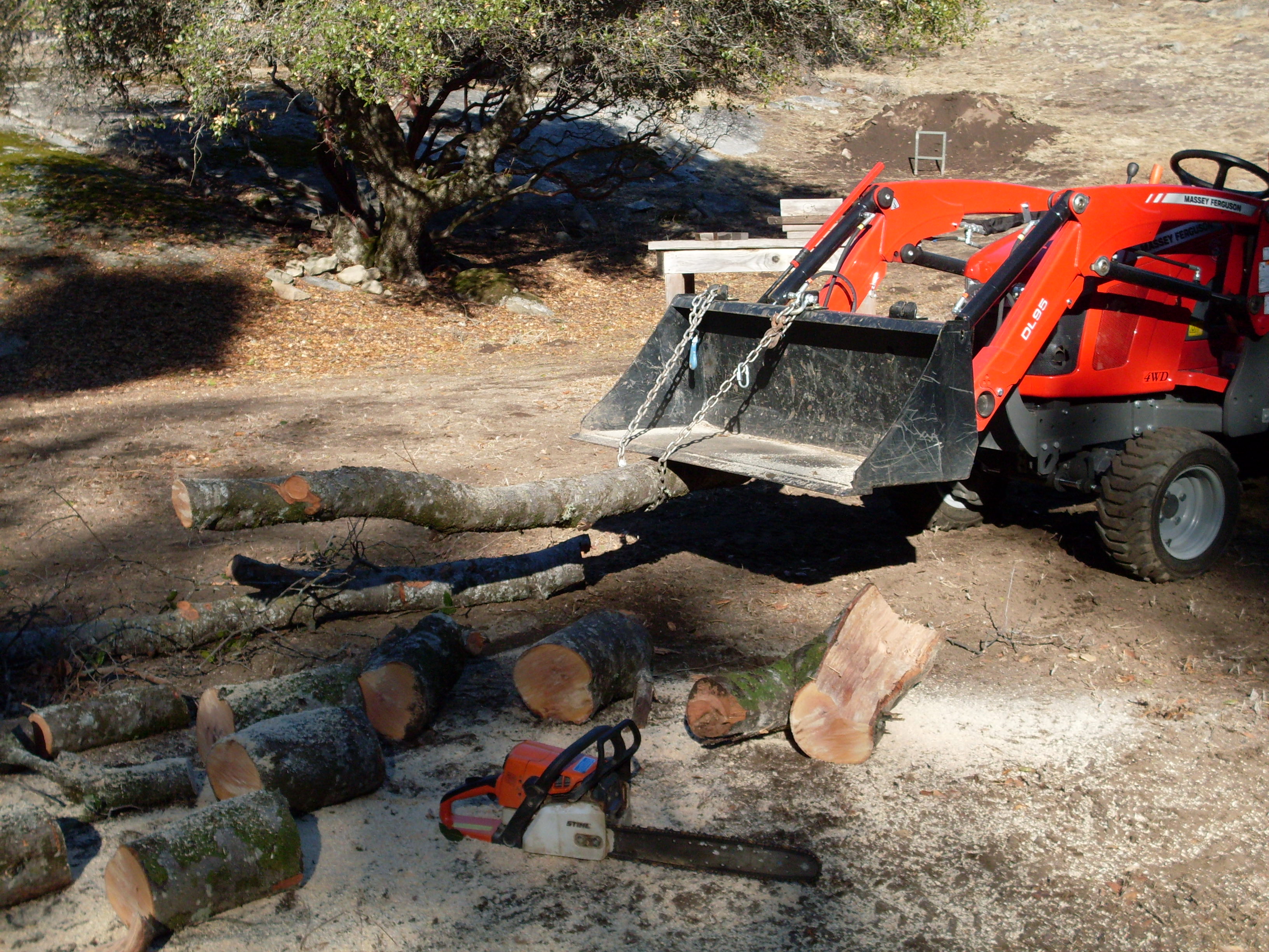

This was my solution to not having a "timberjack" to get log up off the dirt.... You can cut from any side....
Dale

I do this as well. Big logs just get lifted up waist high with the loader and the other end on the ground. Can't imagine doing it any other way. Sadly my tractor will only lift 1000# with the loader.
