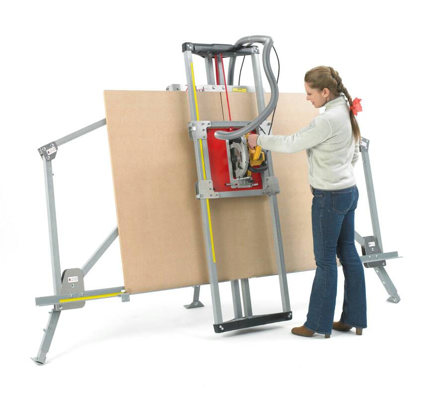

You're cutting vertically so you really just let the saw cut with gravity. There are stops on the right side so you make one measurement, set the stops (like a fence) then slide over the panel to the stops. Then you start the saw and slice down. Pull out the cut piece, slide the leftover to the stops, cut again, repeat.
Imagine a table saw laid over on its front side. But with stops instead of the fence and the panel stays square because it's in a track at the bottom near the floor.
You get perfect square cuts, no lifting, easy readjustment, and works much faster than any other method.
You could probably make 12 cuts in under a minute with a panel type saw. All perfect, square, and exactly the same.
One man job.
   / Cutting 4x8 sheets #47
They also allow the saw to twist 90 degrees for longitudinal cuts.

Is that a panel saw or track saw or are they the same thing?
They appear to be different.
Panel saw is what we're talking about. Track saws have the saw on a track which you can use on a flat table.
They also are plunge cut so you can start into the middle of the wood or flooring type jobs. The track allows perfect straight cuts but the panel saw is for production and the track saw is more portable.

So track saw = measure, mark, clamp, cut one straight line. Do it over again for another straight line.
Panel saw on the other hand can make multiple identical cuts, same as a table saw, but with less effort than a table saw.
