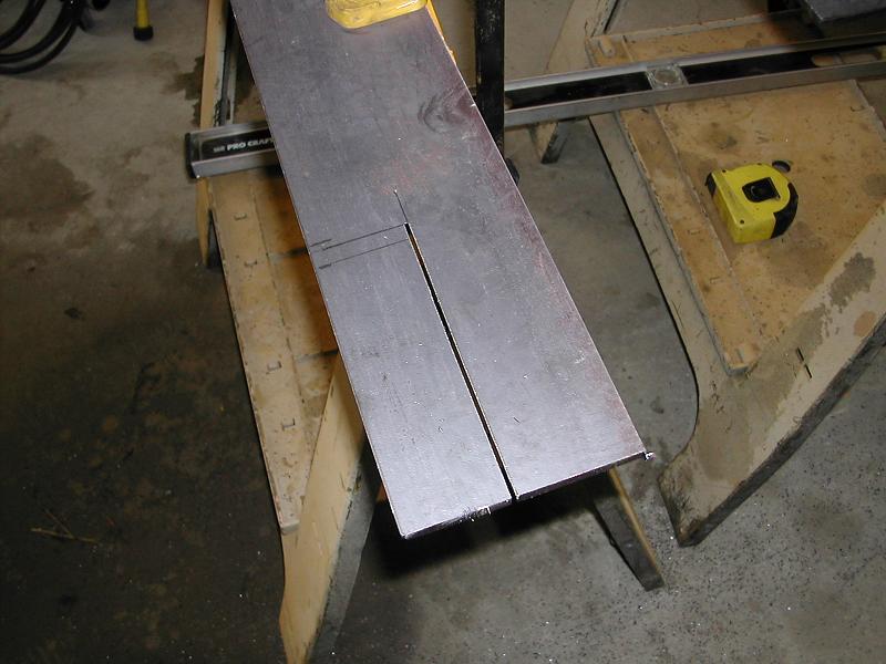

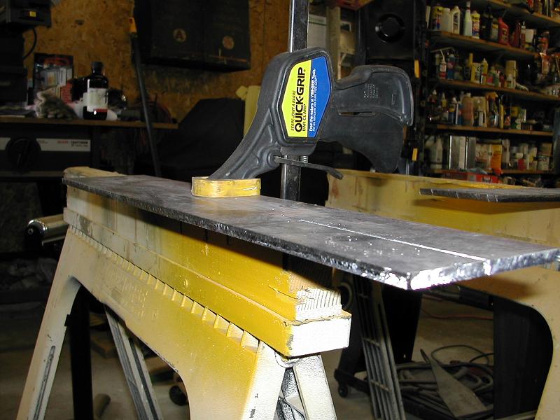

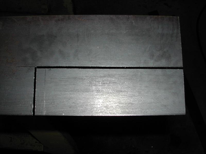

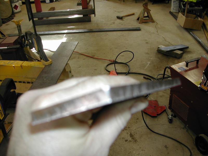

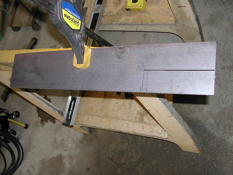

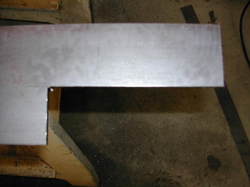

"Even with 3/8" plate, you will be hours and hours trying to grind through it. If you want to use a 4 1/2" grinder you better get a few cases of disks and set aside a few months."
No, no, no, it will not be fun or fast but if you're in a jamb "it" can be done within hours using a walmart 4.5" grinder and a several cheap walmart discs. My grinder is still working just fine. The cuts will not look as good as those saw pics. The borrowed hypertherm plasma cutter couldn't do the 1/2" though it was great on thinnner metal, it was not a new model.
Sometimes you have to make do with what you have and if all you have is a 4.5" grinder this is not an impossible task. There are much better tools.

Took a metal/masonary blade and mounted it in a Black+Decker circular saw.
I had a piece of 3/8 plate 23x30 inches. I needed it 23x21 inches.
I got 2 straight pieces of wood and clamped to it for a track to guide the saw.
I set the depth on the saw to just barely touch the plate and made a pass.
Then I increased the depth slightly and made another pass.
And again, and again, and again, and again, ad infinitum.
I know I made at least 50 passes across that plate.
The last few cuts the saw started making a real bad noise.
But I did manage to finish cutting the plate. Real straight cut too.
But that saw is dead. Real dead.
Let me assure anyone considering taking this route.
You don't want to do this. Or get a cheap throw-away saw like I did.
Pooh Bear
