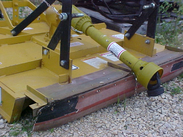

I have a 5' KK and made mine out of a semi-truck mudflap cut in two pieces ( 4$ ).. and 7' of perfed 1.5" metal angle iron from TSC.. and a handfull of 1/4 inch nuts, bolts washers and lockwashers.
5' of the metal wa sthe front bracket.. the mudflap attatched to it via bolts.. drilled out the mudflap with a drill to start the bolts.
The other two 1' pieces were the bracket to attatch the front piece to the mower. I used the 3pt pin bolts and a small bracket bolt. I drilled out the holes in the perfed metal to 1/2" and then slid on.. added a nut. then hung the front piece on.. made it really adjustable.
If this had been a howse.. the mudflap could have been bolted right to the cutter with predrilled holes added by the manufacturer.
total cost was about 22$ and an hour to build, and about another half hour to install and adjust for tire clearance..
chain ones I see for over a hundred bucks..

Soundguy, does your guard setup work to keep all the stuff from blowing out the front end? I have a cutter with chains on the front, and after about a hour of mowing, im covered. Your setup looks like it may keep the debris from blowing out better than just chains.

</font><font color="blue" class="small">( Soundguy, does your guard setup work to keep all the stuff from blowing out the front end )</font>
Yes... I've mowed with a chain guard at work.. and tons of dust and fiber sized stuff makes it out.. not to mention, swing around, etc.. there are some pretty big gaps in chain guards.
I mowed this weekend with the 1954 ford NAA, and the operator seat is just a steel pan.. no back protection.. and the geometry of thos tractors pretty much puts you in a 30' arc with the back of the mower.. so pretty much.. lotsa stuff comes out to meet your back and backside.
I mowed some thorny woody weeds, and was pleased to say that nothing flew out at all... didn't even have a dirty shirt afterwards.. unless you count sweat... /forums/images/graemlins/grin.gif
Also.. given that my project was about 22 bucks.. I'm even more pleased with it... and it is adjustable to fit different tractor sizes.. as I can move the guard furhter in or more out for tire clearance. The mudflap hangs over the top as well, and catches the hi angle stuff. Also.. the 3/8" thick flap is heavy duty, and durable.. and won't rust.. all the hardware is galvanized.. so it looks like it is in business to stay.
If my other tractor and mower setup were similar.. I'd make one for it too.. but as it is.. up on the NH 7610s.. there is no way the mower can spit out something to hit my back..

Cool.. the mudflap was 4$ from a truck stop.. the perfed angle iron was at tsc.. 15$ or so.. has the holes in it already.. I simply had to ream a couple out to fit the 1/2" bolts on the pre-existing braketry.. but that was easy stuff. The rest of the hardware was a little baggy of 1/4 inch nuts/bolts/washers/lockwashers. I used a drill and small bit to dre drill the holes in the flap.. made it soooo easy. And that standard flap cut down the middle, covered my 5' KK hog perfectly.
