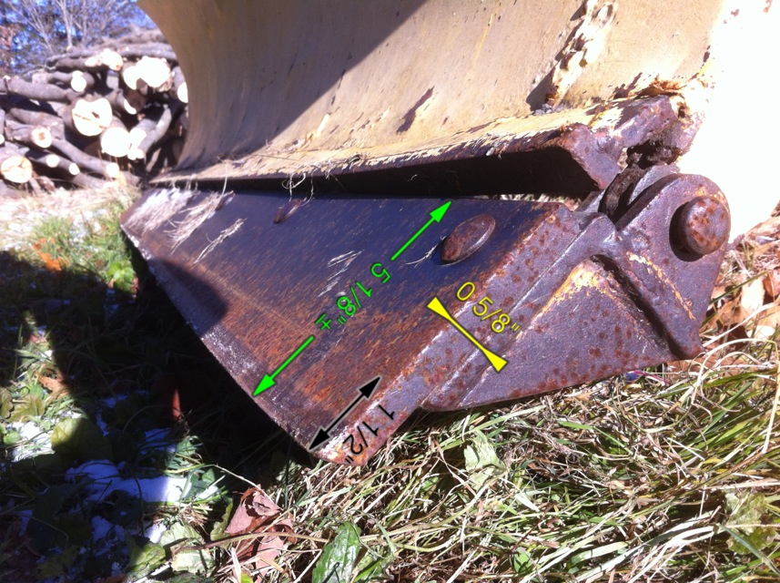

How do you guys who have slipped a pipe over a snowplow cutting edge cut the slot? I have an oxyacetylene cutting torch and thought to use that. Also have 4" grinder but that seems too slow. And do you cut the slot undersize a bit and beat the pipe on? Do the snots from the torch help the pipe "fit" correctly? The pipe is 2" nominal and the edge is maybe 5/8". 2013-11-24 12.21.49.jpg
I thought to weld tabs on the end and bolt back to the blade somewhere, though it's a Fisher with a trip edge. Any tips there?
Thanks, Jim

I had my local steel yard lazer cut the pipe for my blade. They just made a slice-cut but it was a real bear driving it on the blade even with a 12# sledge. I angle cut the corners of the pipes (Y) at the split-cut so that helped to get the pipe started on the blade. I had a spare pipe cut this summer, but this time I had them take 3/8" out of the slice.
I removed the outer-most blade mounting bolts. Made 2 tabs and welded them on the backside of the pipe after bolting them to the blade. I also added an oversized nut for a spacer under the tab before I welded the tab to the pipe - otherwise, I would not be able to remove the pipe without first cutting the tabs off.
I think taking a pipe and welding tabs on it and bolting the assm. to the front or rear of the blade is a lot easier than slitting a pipe and dealing with that. My application did not allow me to do that without more work, so I went with the slit pipe method.
Looking at your blade, I think I would just take a pipe, weld tabs on it and then bolt it to the front or rear of the blade using a few of it's attaching points.

If I welded the tabs on and bolted to the back, say, wouldn't a frozen rock or divot dislodge the pipe? I guess if the tabs were good and stout and bolted in each edge bolt location. Maybe bolting onto the front would be more secure?
The slot would seem to have the advantage of the full bracing of the cutting edge. Evidently you had enough trouble getting your slit pipe onto the edge to sour you on that method.
How long has the pipe been on your plow? Any wear that concerns you? How much service has it seen - long or rough drive, etc.
I appreciate your response; please pardon the barrage of questions.
Jim

I didn't have a torch, had a friend that had one, and asked if he would do it. He did it, but not with a torch. He cut a slot 3/4" to 1" in width with one of those dual blade counter rotating saws. (I'm buying one of those after first of the year.)
Fit like a glove...first try:
Here it is with tabs....paint drying. When I bought this tractor used, it had two holes already drilled in the bottom of the bucket, so took advantage of the holes already there. I probably would have put them into the side of the bucket, had they not been.

I suppose it could, but don't think it would if they were welded securely. Personnally, I would install it on the front edge since that's the direction of travel....although I have seen them installed on the rear of the blade. I think the key here is to not lower the pipe too much, which should help make for a more secure mounting. Hitting a frozen rock, etc, the blade should just jump over it unless it's a huge rock - that's been my experience.

I agree with this too - especially the slit pipe, but whatever works is the key here. What I like best about the "bolt-on", is that the pipe can be removed in a matter of minutes if need-be.
I put the pipe on last fall and it's still in service. The only real wear is on the most outboard edges of the pipe, mainly from when the plow is angled. I figure that when I do wear through the corners, I'll just repair them with the welder.
I plow our road which is not quite a 1/4 mile and do several neighbor's driveways as well as my own....all of which are gravel.
