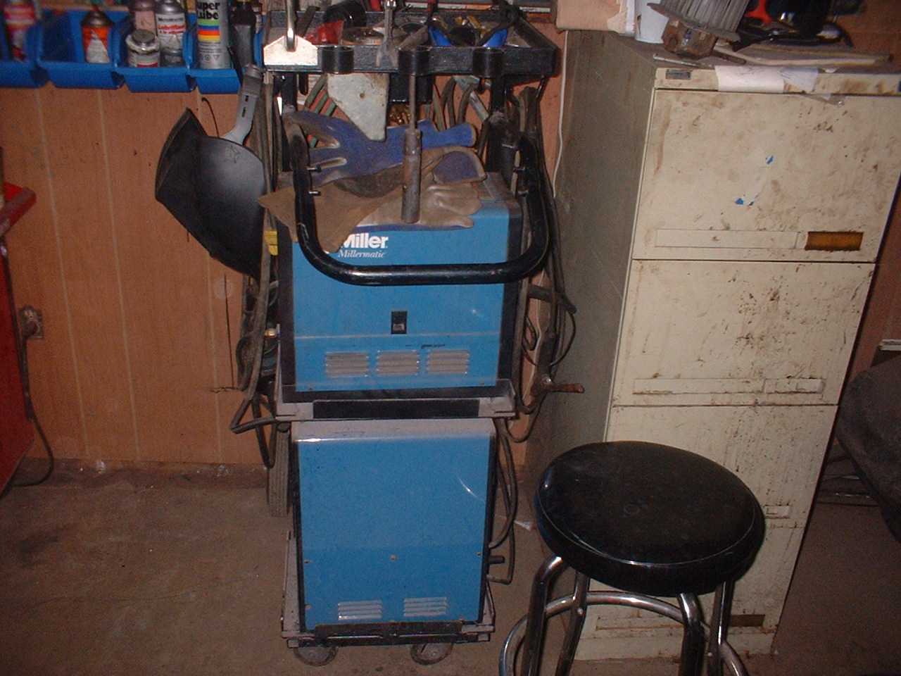

I built myself a welding cart that carries my OA and both welders. I like having all my welding stuff all in one. OA and shield gas on Bottles on the back and welders on the front.
It works good, but if it was going outside id put pneumatic casters on it instead of urethane.
Sorry for bad pic but its the only one i got.

Very interesting Scooby with all of them together.
How tall are your tanks ?
