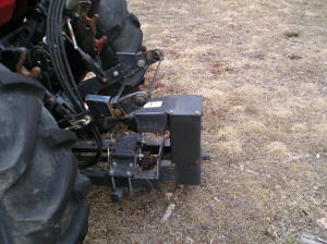

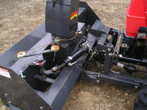

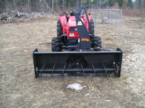

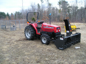

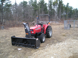

Hey wh22366,
I have just the solution for you, check out the pics. Its for sale too :D
Admit it, it would look nice on your tractor. :)
Dennis

I've been tempted to look for a MF front blower, but I still remember the time another guy and I hung one on a 1440. The conversion from loader to blower wasn't quick. What's your experience?
Wayne
/ Curtis cab #6
My blower is made by Erskine. My driveway is gravel and about 1000' long, I use my truck to plow. I have installed the blower several times with no problems. I roll my loader off and drive up to the blower and hook it up. Sometimes is takes a little to line it up, but I have had no major issues. I have moved it around without taking the loader off, I just raise it up over the blower. I have had a few people look at it, but it still sits here. I may use it if we even get a good ole' New England winter. :D
