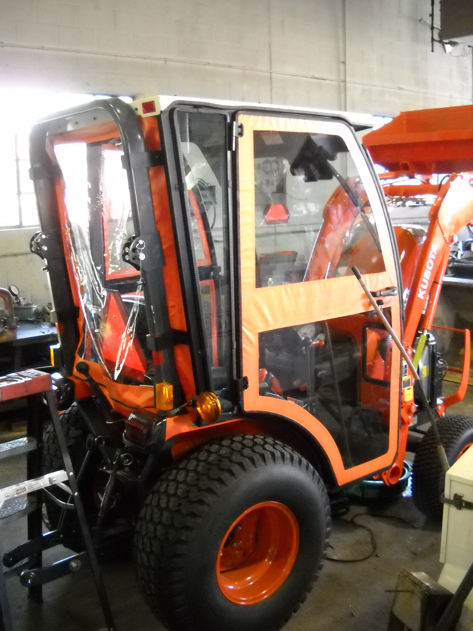

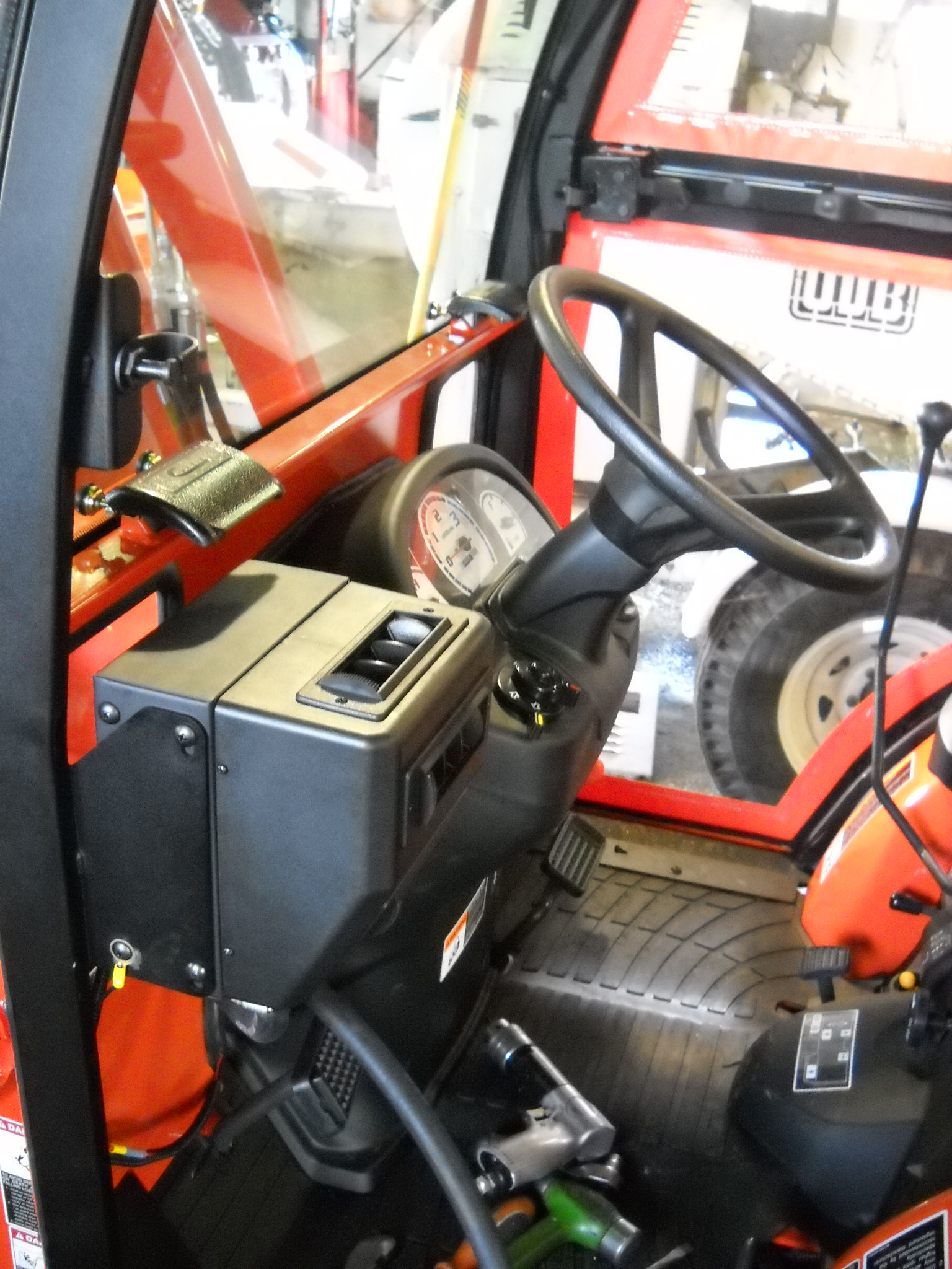

Does anyone have a Curtis cab installed on one of the 2X20 series?
I am about to pull the trigger on one of these cabs and just wanted some feedback (mainly bad - besides the price).
I sat in one being installed recently (pic) and I was surprised how spacious it was inside - I am still not convinced that it is worth the money but when I look at what else is available (for ~$1K) I can not justify it when the less expensive alternaties appear to be not much more than vinyl and snaps.
If anyone can give me good, bad and ugly on the Curtis it was be greatly appreciated,
~jim

I have a L3400 and would like to know about them also. I'm not too sure about the vinyl sides lasting all that long in my own opinion but.... That heater would be nice to have!!!

I do not have your tractor model but I did install a Curtis Cab on my BX24 which looks to be not too dissimilar in size. The design of the parts in the photos you provided is consistent with what was used in my cab. Overall, I was very impressed with the construction, quality, and engineering of the cab. As you noted, it is pricey but I came to the same conclusion as you that the alternatives were possibly not worth the money. Here are some of my thoughts since you asked.
* I have the hard side model. This absolutely requires the use of hearing protection when sitting in the cab. The soft side model may not be as resonant.
* Because of the installation of the BX24 backhoe, the cab came with a soft rear panel that can be unsnapped and rolled up. If you are going to install this panel, do it before it gets cold. I did mine at the start of winter ( I live in SE Minnesota) and I had to place the tractor outside with the sun beating on the rear panel along with a 110V heater inside the cab in order to get the rear panel pliable enough to snap on.
* I too harbored thoughts of lifting the cab off for use during the summer months. I quickly abandoned this idea after completing the install. There are too many connections and interlocking parts to make it worth my time. Instead, I just remove the doors for the summer ( they just lift off two hinge pins) and use the rest of the cab as a canopy.
* I did not encounter any point in the install where the parts did not fit correctly or holes did not align. This was a very pleasant surprise as I expected I would have to shim parts or ream holes like is so often the case with other large assemblies.
* Although the instructions say to use two people I was able to complete the install by myself. More difficult? Yes, but possible.
* The Curtis accessories are overpriced. You can make/buy equivalents cheaper.
* I do not have the heater option. I find that the coat I wear to get to the shed to get the tractor is sufficiently warm in the cab once the wind and blowing snow have been eliminated. I have the front mount blower on my unit.
* I used the bracket intended for mounting the heater to mount a toolbox instead.
* If you have a front mount snow blower you will need either the electric or hydraulic options for rotating the chute. There was not a hole through which to pass the manual chute rotation rod.
* The package the cab comes in is about 1 foot thick, 6 feet wide and about 6.5 feet tall. If you are hauling this yourself you will want good straps to tie it down and take the corners slowly.
* The poly material used to wrap the parts in the package makes a great cover for tender plants and herbs on those late spring and early fall frost nights.
* The hardest part of the install was the windshield wiper. Trying to align the splines of the drive motor with the wiper while holding the wiper spring open was a challenge. Resist the urge to beat on it.
I hope this helps.

I took a look at my cab and I think you will be able to do what you want: that is, take the whole cab off in the summer.
On my cab (again, it is on a BX24) there are four bolts that hold the cab to the floor pan and there are the four brackets that brace the cab to the rops. On my configuration I do not see anything that would absolutely prevent lifting the cab off. That being said, there are a few things that may affect your configuration that you would need to plan for.
* As I'm sure you already know, any electrical connections will need disconnects.
* On the BX24 the grab handles mounted on the fenders to either side of the seat seem to be a little farther out than the fender. When lifting the cab up it may be necessary to spread the bottom rear portion of the side panels to clear the grab handles. I don't know if this is the same as the 2X20 series but it should not be too difficult to overcome.
* On my install the floor pan bolts were placed through the holes used for those plastic dohickies (a great term when you don't know the real name) that hold the rubber mat down to the floor. With these taken out and the bolts removed, the rubber mat may flop, slide, pull up, or otherwise be a nuisance. Again, not a big deal.
* On my cab the instructions said to remove the rear yellow turn/hazard lights from the bracket on the rops and move them to the bracket provided on the cab. From your pictures it appears the same is true on the 2X20 cabs. The reason for this is that from the front the cab obstructs the view of these lights. I did not do this on my cab because I thought this would just be an invitation for them to break off. If you move the lights on your install then you will have to move them back when you take the cab off.
That's all I can think of for now. I hope you'll post pictures and your thoughts on the soft side cab after your install. Good luck

I sat in a B2x20 series that had the cab install complete, and the only thing I didn't like was that the tuck-a-way heater made getting in, and out more diifficult with some medical issues I have. It cuts the width of the floor pan on the left side to just about half I think.
/ Curtis Cab 2X20 #14
I agree. I wish there was a way to put it on the right,but between the loader control and the brake pedal, that is not really possible.
Aaron Z
