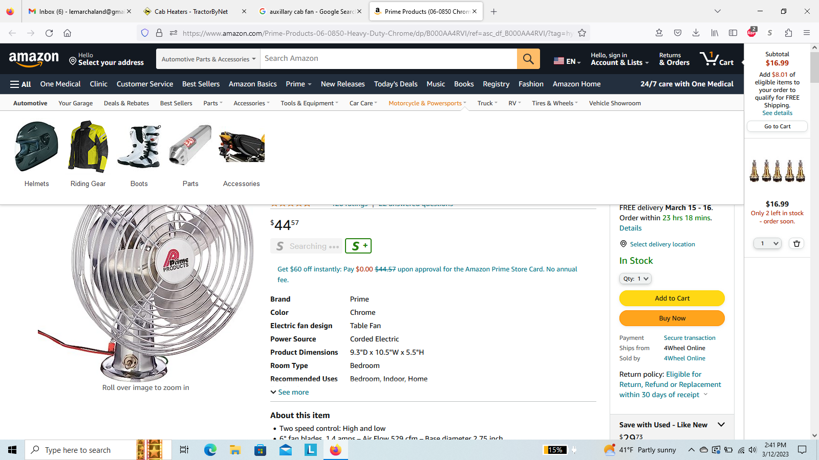

No matter what model heater you end up with, if you put a small 12v fan in the cab to circulate the air/heat, it will heat up much more uniformly. It will also help to reduce fogging.
/ Cab Heaters #3
Even with upper vents it is often helpfull to add an auxiliary fan to help keep the windows unfogged.
similar to this;
