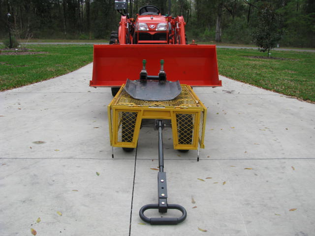

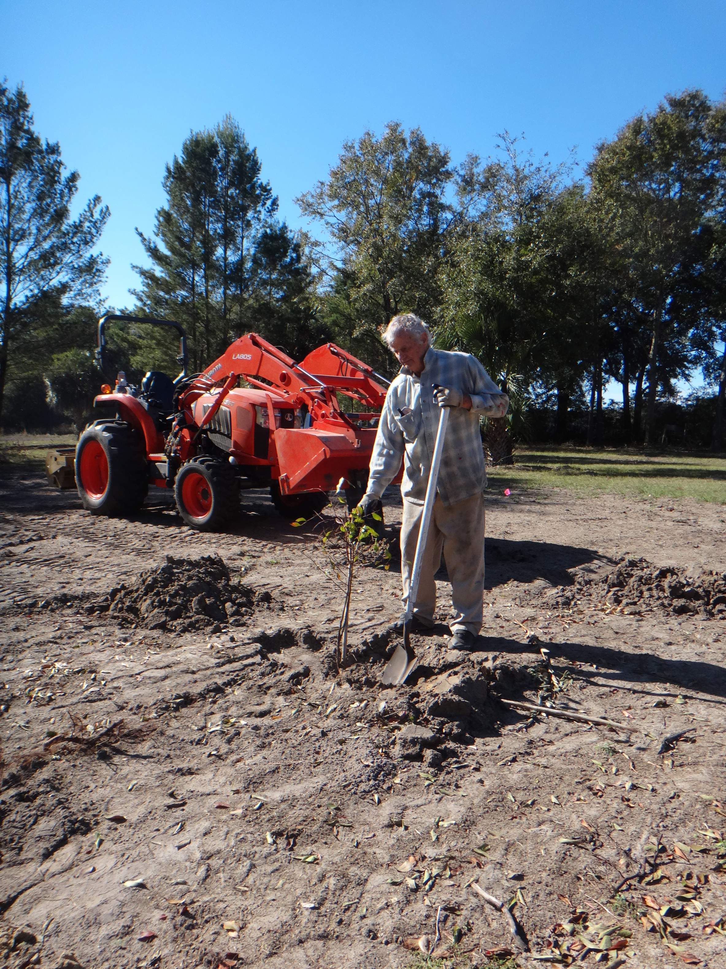

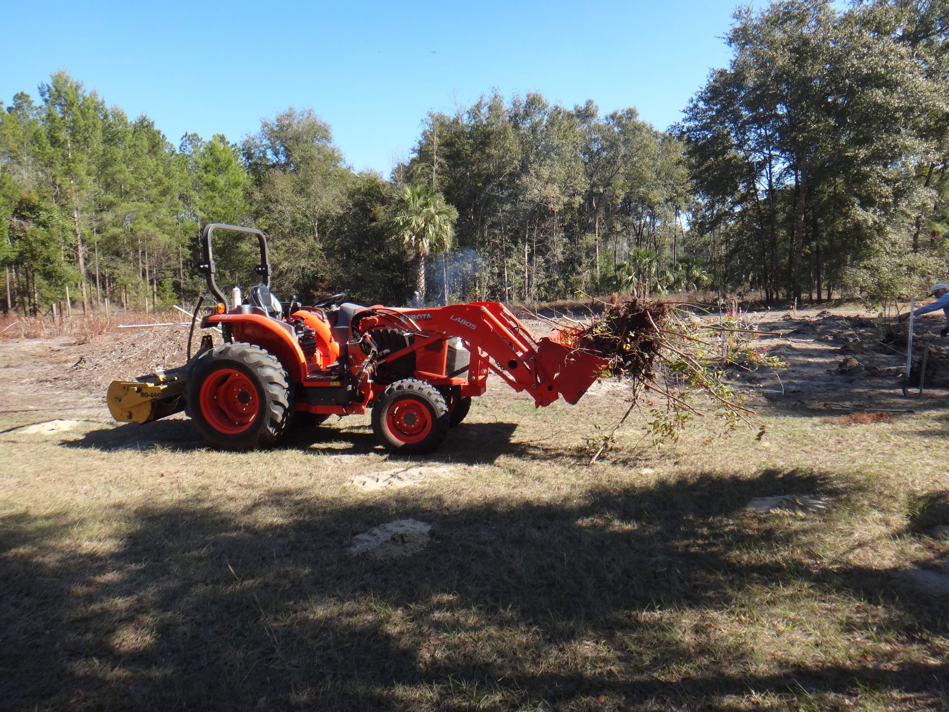

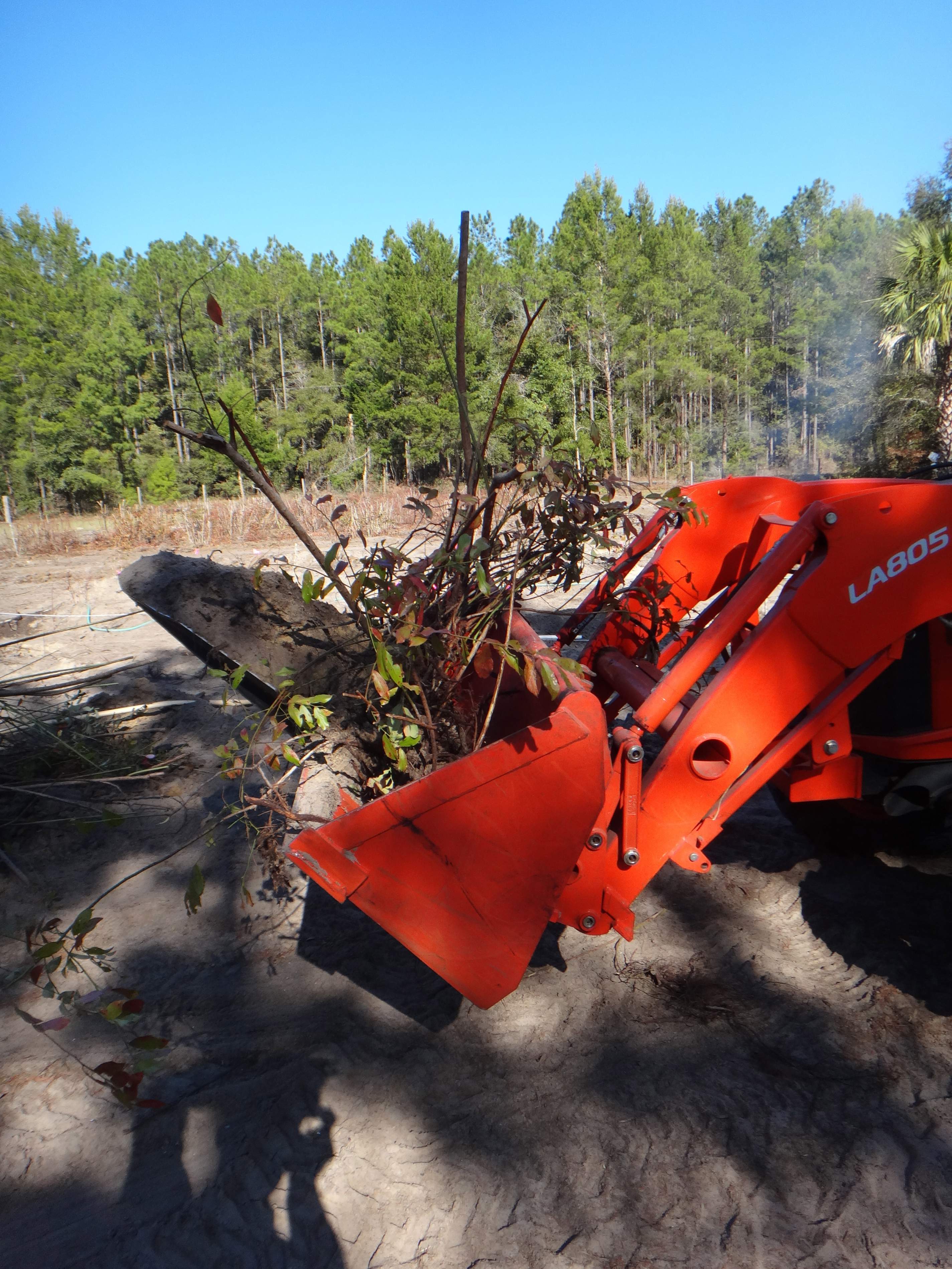

For the price of a Backhoe ($7,000+) you can just about trade up to a Kubota "Grand L" L3560 tractor-loader with optional L2296 Heavy Duty Round Back bucket and a 110 pound Bucket Spade.
A <$400 bolt-on Bucket Spade is NOT a Backhoe. It is not much for trenching. But for digging holes and excavating and planting trees and shrubs it is about as effective as a Backhoe when mounted on a Heavy Duty bucket.
Photos 1-3: Digging, separating and replanting fifteen year old Blueberry plants, taken December 12-13, 2014 in Florida.
Photos: 4-5-6: Planting Bradford Pear
Photos: 6-7: Use, minimal storage space.
More bucket spade info in LINK:
LINK: http://www.tractorbynet.com/forums/...da-planting-sand-pears-kubota.html?highlight=
You need to remember that you are digging in Florida sand, while some of us are digging in black gummy clay and/or rocks. That bucket spade wouldn't be useless in my clay soil, but it would be a PITA to try to use. No thanks.

Bucket Spade is 110 pounds of sharp steel, mounted on optional Kubota 397 pound heavy duty bucket, pushed by 1,279 pound FEL. One thousand seven hundred eighty-six pounds, ALMOST A TON, of force on the sharp edge; BEFORE wheel force of tractor is applied.
Trust me, it will handle clay fine, unless, perhaps, clay is dry as adobe.
I do not recommend it for EXTENDED use on any but a heavy duty bucket.
Bucket Spade is the Rodney Dangerfield of attachments: it never gets any respect.

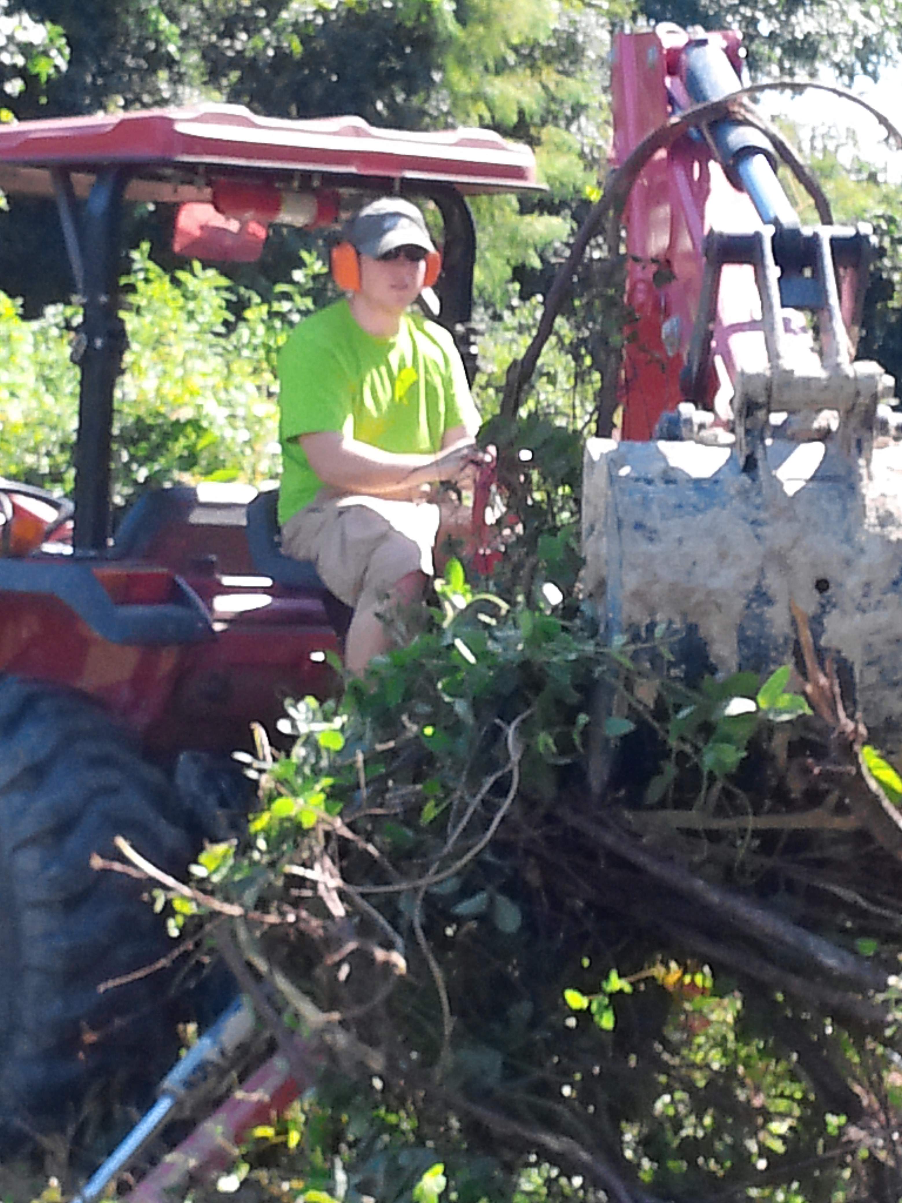

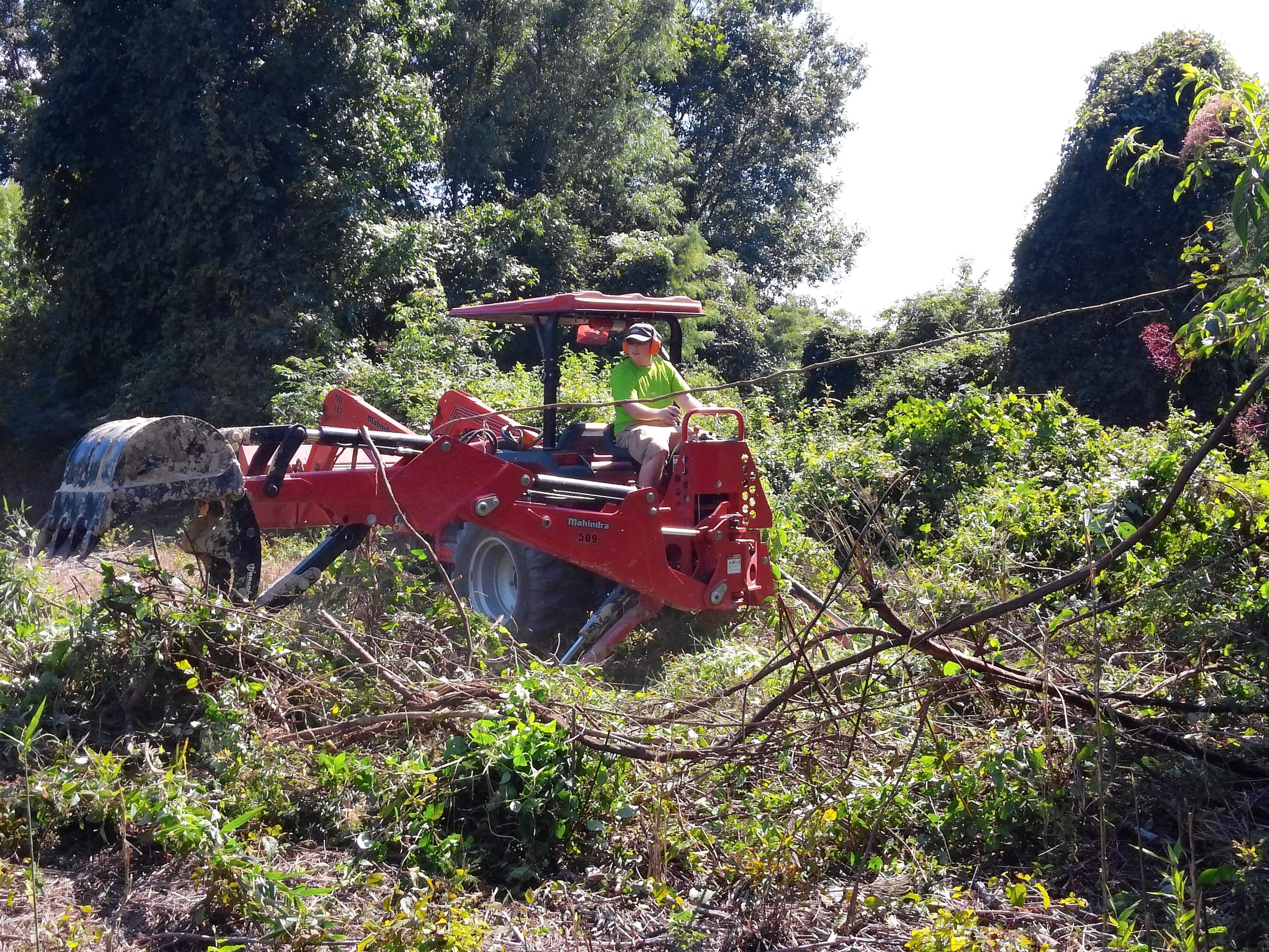

For us, the tractor would be pretty much useless without the hoe. Much of our 6 acres is previously (60 years ago) logged, uncleared land, now densely grown over with alder, cedar & fir. There are many huge old stumps that will require an excavator, but our little hoe makes quick work of the smaller second growth stumps. Not to mention knocking down small mountains of topsoil, left Behind by heavy logging equipment.
We will be putting in new power lines in the spring. That job alone will save a significant percentage of the initial cost.
We have big time drainage problems too, which will need long ditches to fix.
Yes, it's a big expense. If you are asking the question, I suspect you may not NEED a hoe.
I like having it, because I can plan & work at my own pace, not worrying about getting a whole bunch of work ready for a hired backhoe & sweating the cost per hour.
And besides all that... It's good fun!
