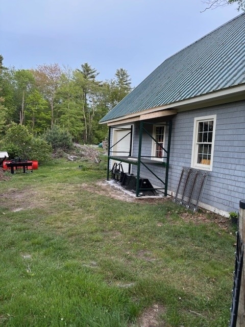

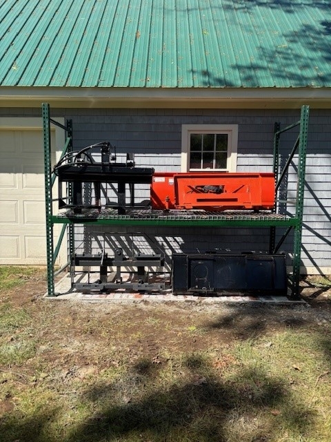

I built a lean-to with a 10' pallet rack off the back of my barn for storing buckets, grapple, forks etc. had a lot of old used brick that filled most of the base except for the ends where the pallet pads are.
