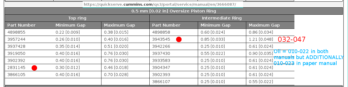

This link (so far alone out of a dozen including 3 emails to Cummins) bore fruit! KUDOS to Rocky Mountain Cummins!!!!
Whaaaaaada a mess, don't know where to begin. The engine number is 44966271 and the CPL is 1550. This was the engine number given to the API piston-kit supplier who sent me piston kit # 111336 inside which is ring-kit #505081 with OEM equivalent Cummins numbers of 3802494 & 3802232 respectively. No one (else) has been able to give me so much as diddly squat including PAI. The problem is that if I want to do a pro job I have to know the individual ring part number as per the Cummins QS web manual @
Cummins QuickServe Online | COLA
(red dots are the closest to paper manual values)
This page shows like 9 different gap ranges for each of that many ring part numbers for top as well as intermediate rings i.e. you don't go ANYWHERE without the ring part number. PAI however were unable to give me so much as the equivalent OEM numbers for the rings in *their* set, so much for PAI!
The hard copy manual that I paid $250 for states
Top 012-018
Mid 032-047
Oil 010-022
If I had gone with these numbers when my instinct first rang the alarm and I posted the originating article I 'might' have OVER gapped to the tune of 2 or 3 times spec which in my book means immediate execution by the shop door. I didn't, went looking instead.
So the gal at Rocky Mountain Cummins said "piece of cake, I can give you the cummins RING numbers that go into that equivalent cummins kit ...my, my, my ..how hard can THIS be everyone out there (not meaning this forum of course)??????
*her* part numbers and QS-based gaps
Top: 3919050 016-030
Intermediate: 3904347 010-024
Oil: 3904349
So after having lost confidence in the $250 paper manual, in PAI, in internet blog sources that do not quote precise sources, I wondered if my kit supplier got me the right set in the first place for my engine? I was so happy to hear the gal give me actual ring part numbers that I forgot to verify with her against the actual engine number. So I called back: the PAI kit number is the correct one for 20 over-bore, but it has been replaced by 3802422 which in turn looks like having a different oil-ring number 3933585.
(I spoke to both girls working there today BTW, I don't feel empowered to name them). I think they desrve the parts-dept nobel award!
I now have half a mind to chuck the entire PAI kit and order me a Cummins kit as maybe I should have done in the first place.
