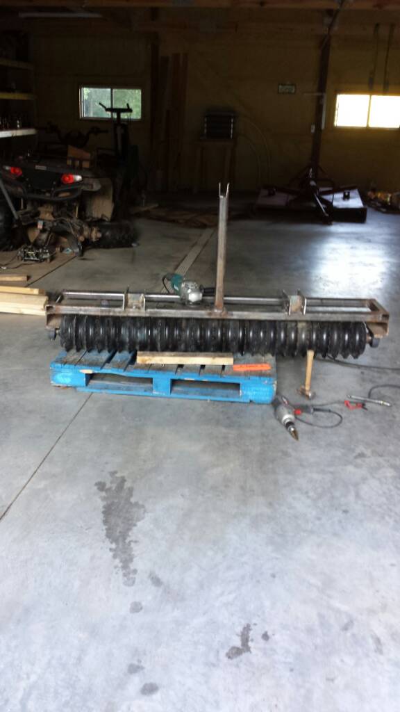

So now I have something to go over the seeds now.
Jul 12, 2016 / Cultipacker build done #1 jack707 Veteran Member Joined Nov 30, 2013 Messages 1,602 Location up North wisconsin Tractor farm trac 555 So now I have something to go over the seeds now.
Jul 13, 2016 / Cultipacker build done #2 B Buty Silver Member Joined Nov 15, 2012 Messages 149 Location Canton, GA Tractor Kubota L3200 Awesome!! Please let us know how it works. Will be ordering my wheels soon to build mine very similar to yours.
Jul 13, 2016 / Cultipacker build done Thread Starter #3 OP jack707 Veteran Member Joined Nov 30, 2013 Messages 1,602 Location up North wisconsin Tractor farm trac 555 Thanks!!! - I took the tractor in for service I'll post a pic when I get it back.
Jul 15, 2016 / Cultipacker build done #4 B Buty Silver Member Joined Nov 15, 2012 Messages 149 Location Canton, GA Tractor Kubota L3200 By the way, have you calculated a total weight for the implement?
Jul 15, 2016 / Cultipacker build done Thread Starter #5 OP jack707 Veteran Member Joined Nov 30, 2013 Messages 1,602 Location up North wisconsin Tractor farm trac 555 I would say about 500lbs but I still has scrap left over so I am going to weld them on top.
Jul 18, 2016 / Cultipacker build done #6 efam3300 Gold Member Joined Jul 9, 2011 Messages 397 Location cental mo Tractor LS4140HC- Kubota b3300su hst-polaris ranger 500-Kubota Commander ZTR Great job. What color will you be painting her?
Jul 19, 2016 / Cultipacker build done Thread Starter #7 OP jack707 Veteran Member Joined Nov 30, 2013 Messages 1,602 Location up North wisconsin Tractor farm trac 555 Maybe the color of my tractor blue

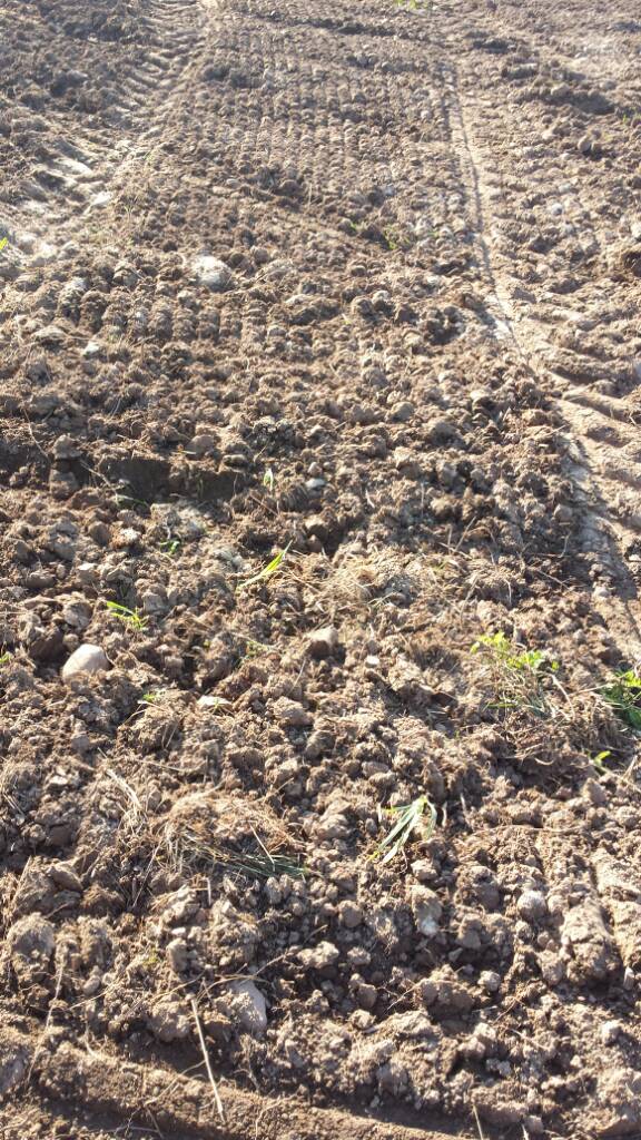

Aug 3, 2016 / Cultipacker build done Thread Starter #8 OP jack707 Veteran Member Joined Nov 30, 2013 Messages 1,602 Location up North wisconsin Tractor farm trac 555 The cultipacker worked!! I wish I made one that covered the tracks .
Aug 4, 2016 / Cultipacker build done #9 B Buty Silver Member Joined Nov 15, 2012 Messages 149 Location Canton, GA Tractor Kubota L3200 How wide did you make it and how wide is your tractor? How fast did you drive?
Aug 4, 2016 / Cultipacker build done Thread Starter #10 OP jack707 Veteran Member Joined Nov 30, 2013 Messages 1,602 Location up North wisconsin Tractor farm trac 555 My tractor is 6 ' wide the packer is 60 " wide. I drove in 1st that crawling! About 2 or3mph. I might make one that's wider to cover the tracks.
