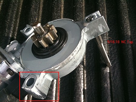

Well, bought the motor from Napa for $30 after core turn in. I had to tap the holes in the new motor as they were smooth bore.....5/16x18 threads........also had to grind off a fin on the case that was in the way, maybe 1/4" max...just used a floor mounted shop grinder. Electrical plug was identical and required no modifications. Took about 1/2 hour from start to finish and the chute is back in service! Thanks to everyone for the replacement part number for the motor! Sure beats the $250 Cub cadet quoted me just for the motor itself!

When you state grind off fin, is that the fins near one of the bolt holes? It appears to me I would need to grind them off so it could get but that chute stop on the bracket. Is this correct. Oh, thanks for the bolt hole tap spec.

I finished it. I had to grind of the fin that makes contact with the metal chute stop on the bracket. Tapped the 5/16 x18 thread into the gear housing on the motor (came with smooth bore bolt holes). Fits well. Now I have a electrical problem. I think I have a bad contact from corrosion.

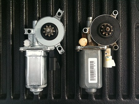

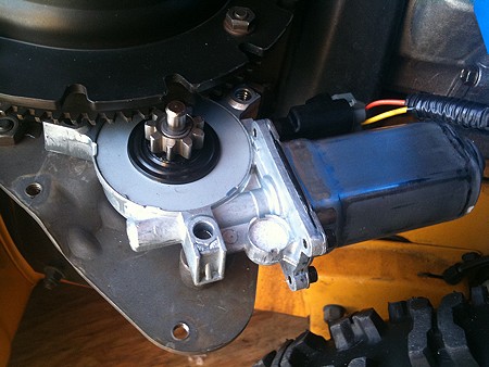

I know this is a old thread that strayed off topic but I just want to say thank you to those who commented as it help me save some $$$ and I now have a Cub Cadet 826 SWE snowthrower with a new electric chute motor with minimal modification that can be done with a hacksaw, hand file and tap.
Even if one purchased the basic tools, he would still be under the cost of a dealer priced motor. Well done guys! Got my Dorman 742-119 from Autozone for about $50.00 though you can get it elsewhere for less if you'd like to wait a few days. I decided to take advantage of a clearing in the weather and get this done. And it worked great!
