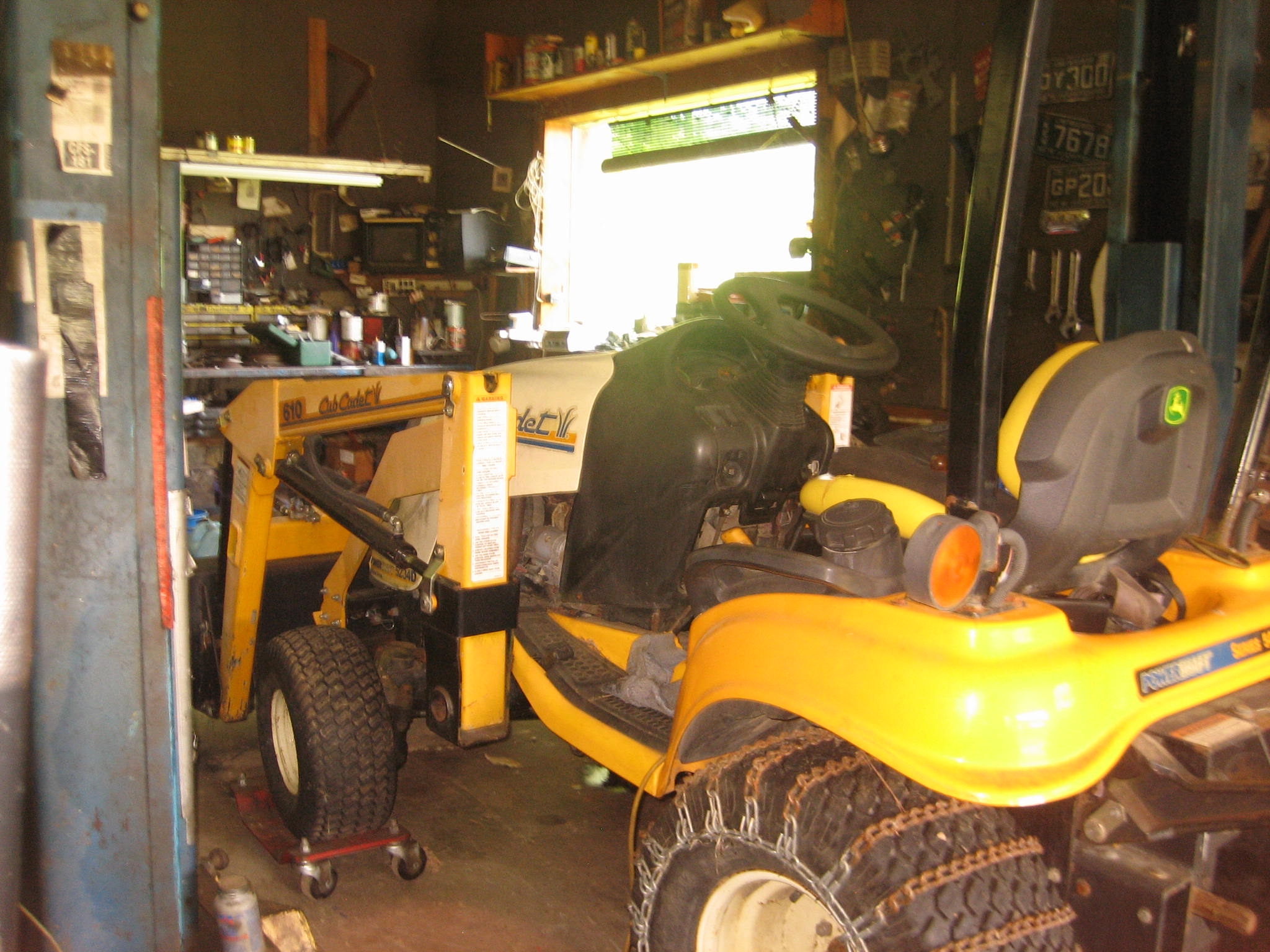

I DON'T THINK ITS AN ALIGNMENT PROBLEM-RATHER THINK TWO REASONS, ONE BEING THE CROSS JOINT IS TOO SMALL TO STAND HIGH R-P-M-S ,AND MAKING SURE GREASE OOOZES FROM ALL FOUR CUPS--AT TIMES YOU MIGHT NEED TO ROTATE THE SHAFT AND TAP THE CAP UNTIL THE GREASE COMES THROUGH, A LITTLE HEAT [JUST A LITTLE NOW] THOSE NEEDLES IN THE CAP WHEN DRY WILL GET RED HOT AND SEIZE, THIS WILL SNAP THE PIN, THIS THROWS THE SHAFT OUT OF ALIGNMENT, WALA--- PROBLEM--THAT'S WHAT I'M UP TO AS WE SPEAK, ONLY I'M GOING TO TRY A RUBE GOLD BURG FIX, ILL LET YOU KNOW HOW I MAKE OUT. GREG.
/ Cub Cadet 5234d problems #5
PERHAPS I SHOULD EXPLAIN, THIS TRACTOR WAS GIVEN TO ME BECAUSE THEY COULD NOT GET ANY ONE TO FIX IT, ITS LIKE NEW, I THINK THEY SAID IT IS A 2O15-- [HOW CAN I FIND OUT]
