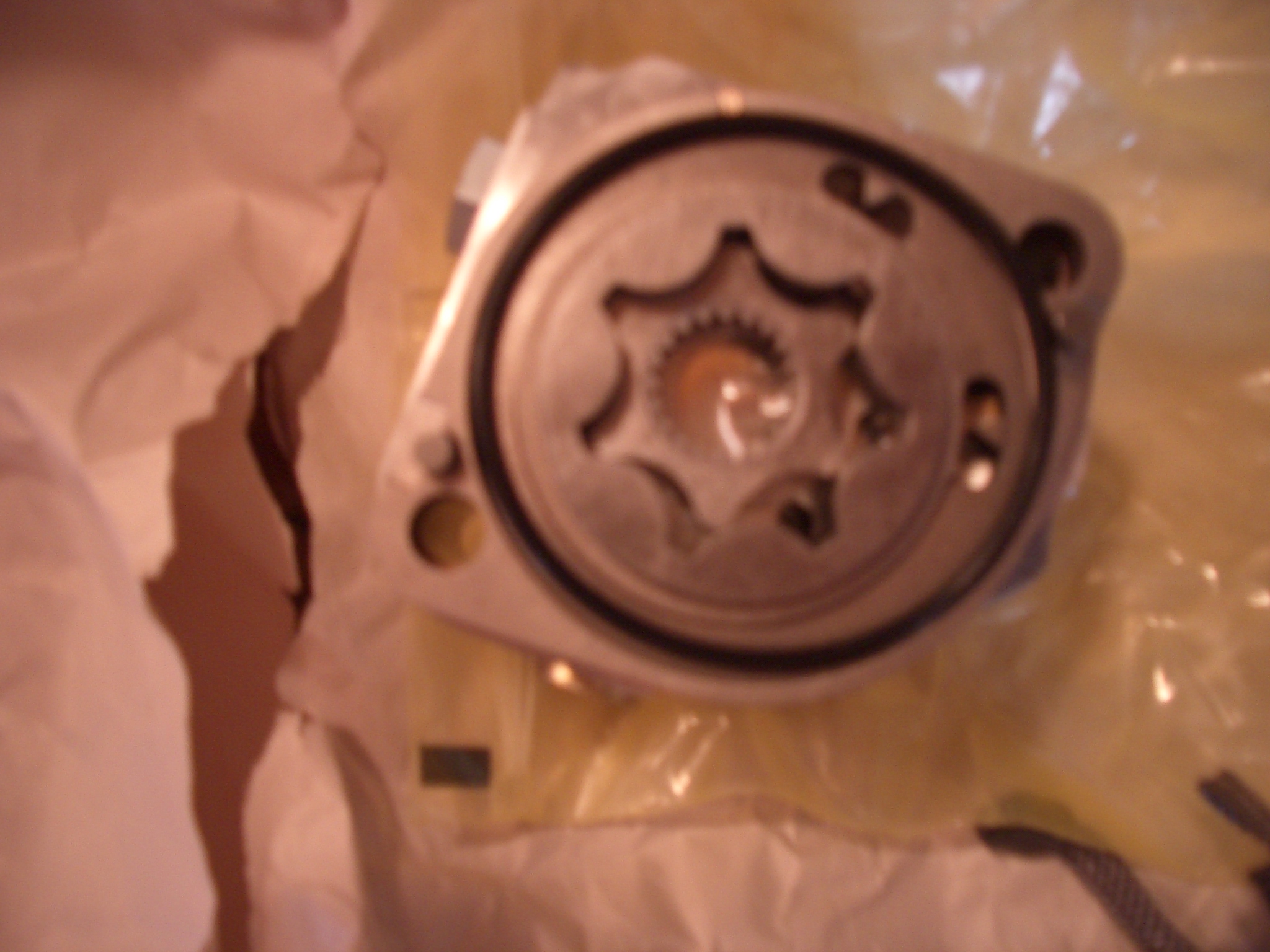

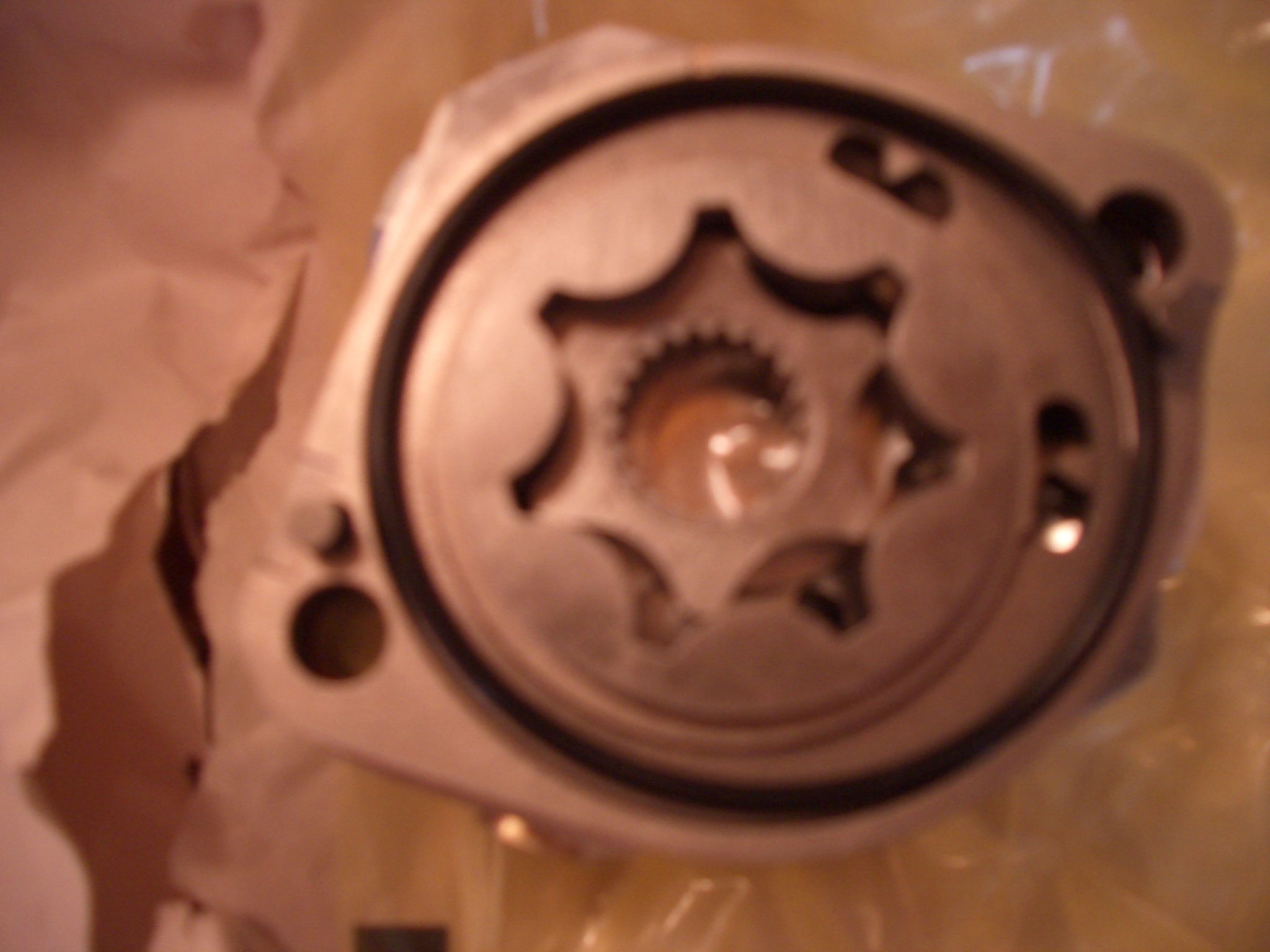

I got the charge pump put on Saturday. I had trouble getting it to pick up oil. Made several phone calls & got different opinions on if it needed primed or not. Tried a few things & still couldn't get it to pick up. Took it out one more time. Inspected o rings on the pick up tube & the o rings on the charge pump. Didn't see anything wrong anywhere. Put it together & this time it worked. Don't have any idea why it didn't work the first two times I put it in. Glad it works now. One other thing to note; the gyrotor gear does not fit in the ring like I show in the picture and there is not a piece missing. I should have taken a picture of the new gear. Nolan, are you sure you got the wrong part?
   / cub cadet 3186
#14
I hope I am wrong but it dosnt look like my broken one-although that was missing chunks. This one only has 6 teeth and the assembly has 7 is that correct? I can't find a clear picture. I have added a picture. Thank you.

   / cub cadet 3186 #15
Looks like all of the rotor assemblies that I have put on. Just make sure it gets put on facing the correct way.
   / cub cadet 3186
#16
Thanks Vince you were right, I got it on an fired it up-works great again! My appologies to Cub Cadet.
   / cub cadet 3186 #17
Glad it worked out for you. That rotor sure looks odd in the ring, doesn't it? I would have never thought that it fit in the ring the way it does if I didn't buy a complete pump and see it myself. I see where Vince said "make sure it is facing the correct way". I thought the one I changed looked the same on both sides.
