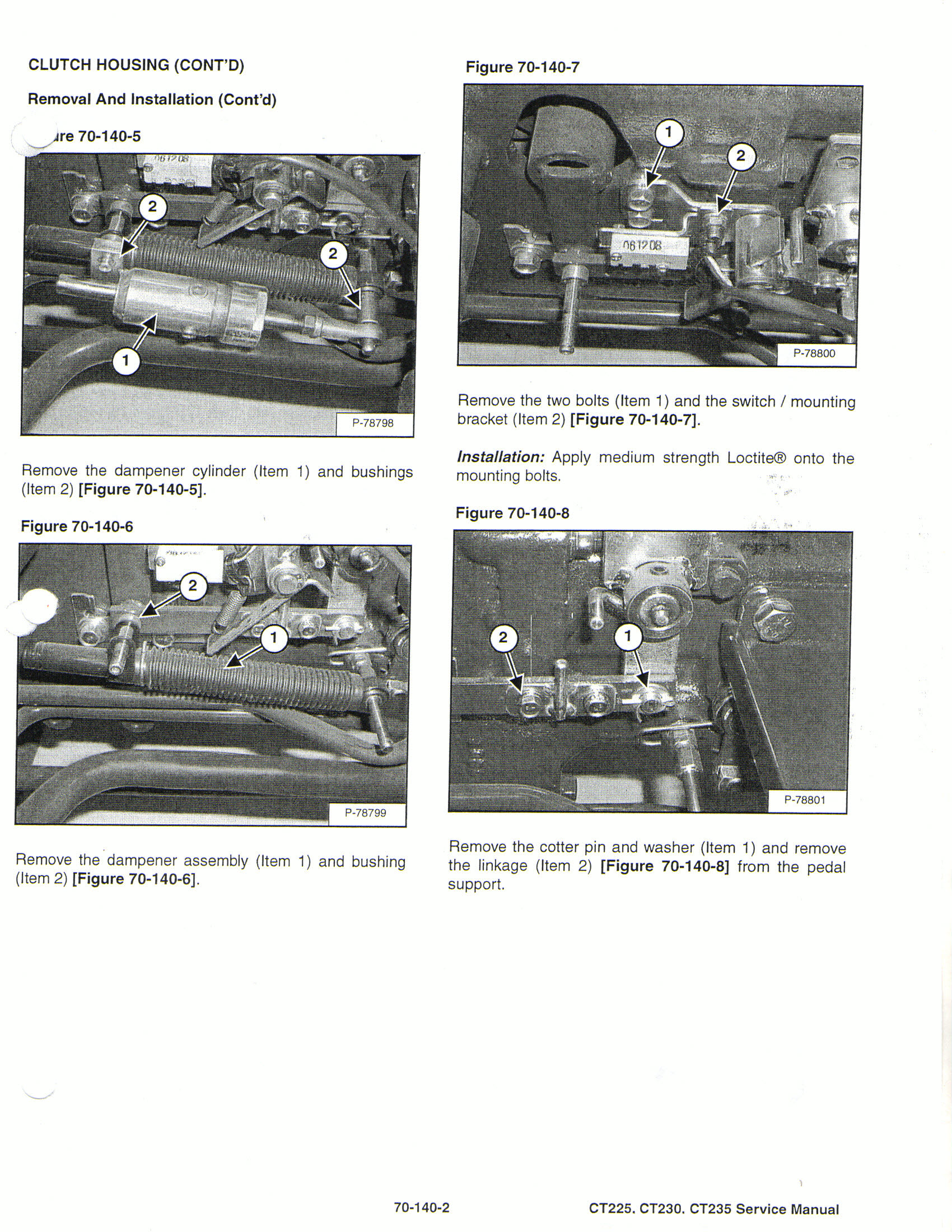

Had a sudden no start (won't crank) issue with my CT225. Discovered travel control peddle was not touching microswitch at any position! I mechanically wedged the microswitch contact closed, and tractor started OK. Puzzled as to what to adjust - looking for a diagram or image of the mechanism so I can understand how it should work. Nothing seems loose or broken, but it will not close the microswitch.
Thanks
   / CT235 Nostart and fix #6
This page actually under the clutch section in the repair manual. No information that I can find. Don't know whether the picture can help or not.
Well, after some more looking I won't go into a long story but I am missing page 10-240-1 which has the instructions for the pedal. All I can say is old age played a part. Maybe someone else has the manual and can scan the page for you. Sorry. :ashamed:
Thank you for the lead - I missed that section entirely - not sure it will be enough but it is a start. I did find 10-240-1.
It is really puzzling to try to understand how it should work and how it shifted with no "event" - just driving between barns, shut it off for a few minutes, then no crank!
Thanks, again
Does the "contact button" of the switch move in and out? There's not a whole lot of travel of the button but maybe it's not traveling all of the way out of the switch due to debris in the switch. Tough to figure that's for sure.
   / CT235 Nostart and fix #9
The L bracket doesn't touch the microswitch button at all - I noticed the images from the post above show the L bracket at a sharp angle - mine is almost horizontal - wondering if something broke? Thanks for the reply
