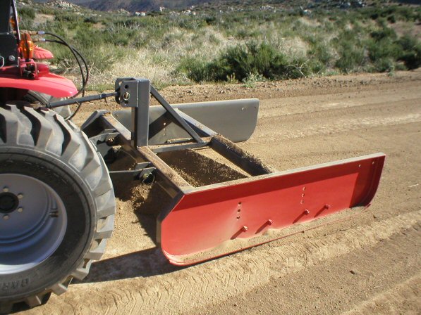

I recommend a rear scraper blade as I use that for a 1000' gravel driveway. Both for gravel maintenance and snow removal. Try to get a good blade which is moderately heavy so it won't bounce up off hard pack gravel. Mine is around 400-450 lbs and works well. It is also offsetable which is a benefit. I'm using the Leinbach S06 from everything attachments.

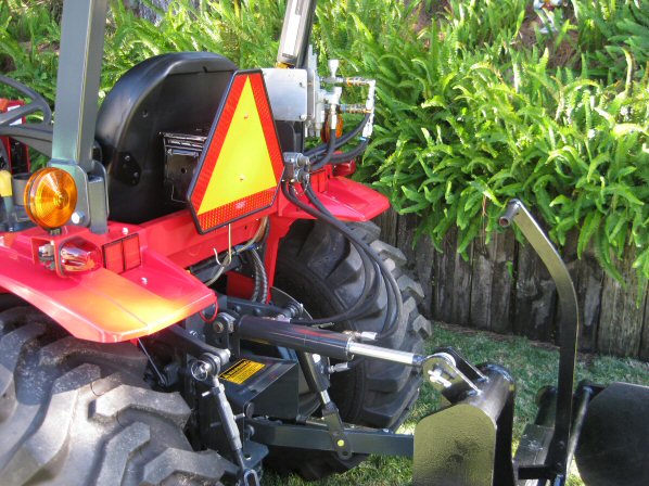

Depending on how much road you are going to maintain, I would highly recommend top and tilt hydraulics for your 3pt hitch. That being said, you would need to get both of the rear remotes that are available. It is way easier and typically you will do a better job of grading your drive when the adjustments are at your finger tips vs having to get off of the tractor to make the adjustments manually. A lot of people use a box blade, but as has been mentioned a rear blade is normally better for snow removal and they work very good for working on your road also. If you have a long drive then a land-plane grader blade along with a rear or box blade works best in my opinion.
Good luck with your decisions.

All of your front to back and side to side tilt adjustments for a box blade are manual. Those adjustments are with the 3pt hitch, not on the box blade. That would be the reason for getting the top and tilt hydraulics. Bobcat has a heavy duty box blade available, but in my opinion is just a tad bit to big for the CT235.

Regarding a box blade for snow removal. I have both a snow blade and box blade but actually prefer the box blade for snow removal. I hate the windrows and the gravel fired up on the lawn over a winters plowing. The box blade pulls everything out to the street and I use my loader to push the snow into the ditch.
The box blade if properly adjusted will NOT pull your gravel out of your driveway. I extend the top link to the max. This lifts the front cutter off the ground by at least two inches. The box blade then drags on the back blade. In the first part of the winter I leave the front blade raised to the max, after a half dozen plows the driveway is now frozen and the snow has been built up because the back cutter has been dragging and packing. I then gradually lower the front cutter to remove the excess and voila, your driveway is perfectly plowed.
I find the box blade indispensible, winter and summer.
