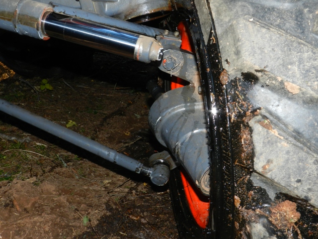

Last summer, I managed to break the RF bevel gear case and shaft working in the woods. I got that all fixed up and working well for a couple of months, until yesterday, when I managed to do the same thing to the LF. This time, I even managed to do a bit more damage, shearing off the connecting end of the steering hydraulic cylinder and (I think) bending the threaded end of the tie rod.

I went out last night and took off the wheel. The only thing holding it all together now is the tie rod (the end of which is bent slightly), since the bevel gear case and shaft are broken and I sheared off the outboard end of the steering hydraulic cylinder. I also noticed that I put a pretty sharp dent in the steel wheel right at the rim. Thi$ repair will be even more co$tly than the la$t.
I'm not sure why this happened once, much less twice, though I have a couple of plausible theories. My latest is that I was pushing and lifting while the front wheels were turned to the side in a location where the tractor couldn't actually turn. This would put tremendous lateral stress on the bevel gear housing. Of course, this doesn't really explain why this should suddenly happen now (twice!) after 8 years of doing this kind of work...just lucky, I guess.

I took this pic Monday afternoon and it shows the major broken parts. I now have the tire off, so can probably get a better angle to document the damages.
Note that the only thing holding the wheel onto the tractor is the tie rod; every other connecting bit is broken!

An update: Out of service for 6 weeks, but all the parts finally came in and we were able to get a guy with a portable welding rig back into the woods to weld the steering mount back onto the end of the cylinder on Saturday. It was kinda chilly getting everything back together out in the wind, but it seems to be functional again...I'm expecting to do a lot more of my work on trails manually in the future, though (under orders from SWMBO).
