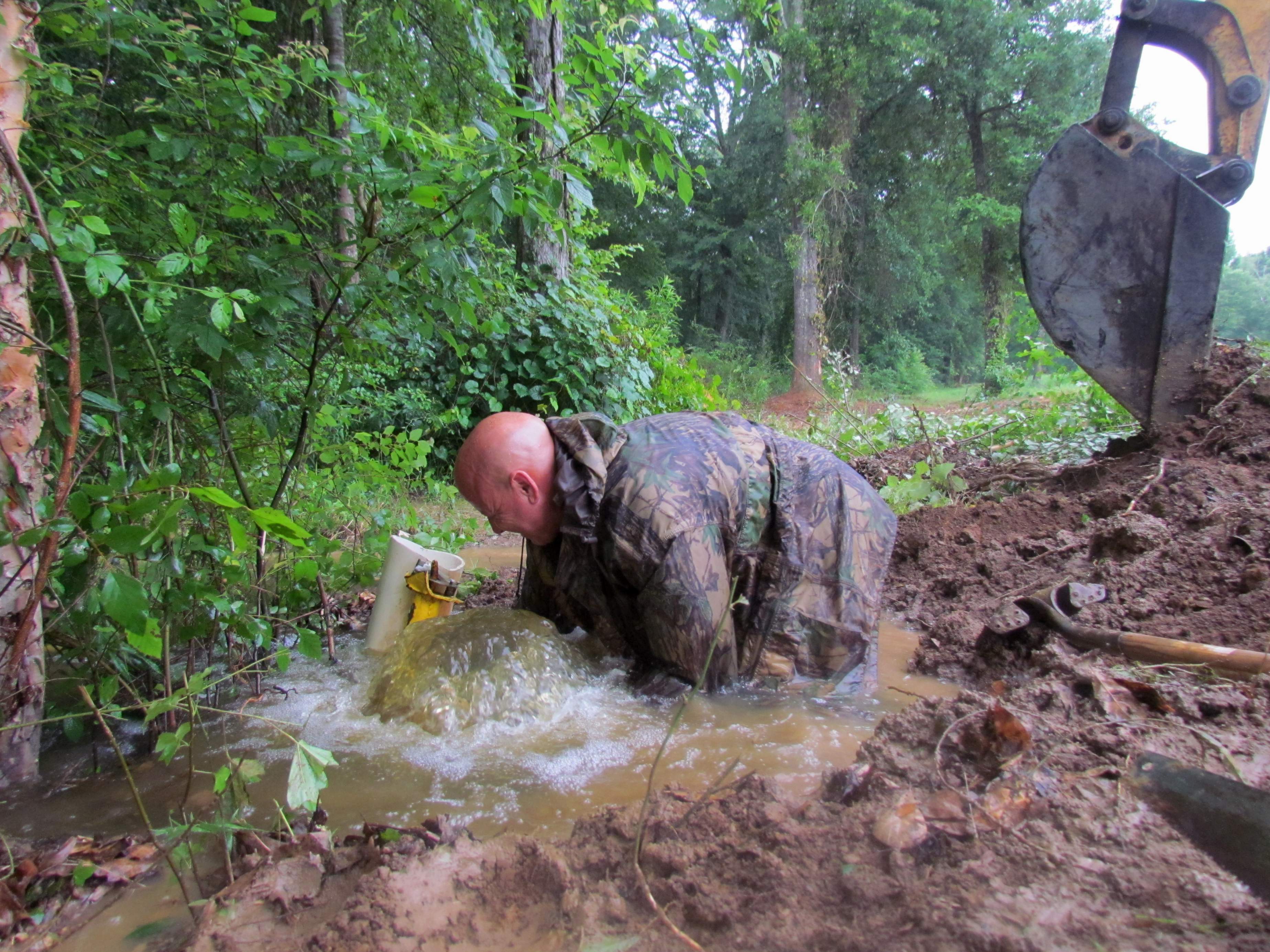

So we woke up this morning to light rain and plans to go to a friends house and get to know the horses they are giving us. They where born the end of May and we will be taking them home in November, but that's going to be another thread. While at their place my dad called and told me that he had run into the drain line and valve handle for the pond. When digging the pond I installed a six inch pipe through the dam so I could drain the water while digging, and to have the option of lowering the water to mow along the shoreline if I wanted to. This has proven to be a VERY DUMG idea and a total waste of money.
During a break in the rain, he was in the area of the drain line with the backhoe cleaning up some trees to make it nicer for the wedding. He is pretty good at this, but forgot where the line was and when he hit it, he just snapped off a six in pipe.
He called me at 4. We where home at five. He was at Lowes buying a length of pipe and a rubber coupling. I got on the backhoe and cleaned up the area, then used a hacksaw to cut off the broken pipe and get a flat edge. With Karen's help, we slid the new pipe over the broken pipe and I clamped it down. The leak stopped.
In two hours the water level dropped 4 to five inches.
I cut the pipe and poured 4 1/2 sacks of readi mix concrete into the hole. In a few days, or weeks, I'll remove the pipe we added and fill it up with more concrete, then cover it with several feet of dirt. This can never happen again!!!!

Eddie,
Don't feel bad about the pipe. My dad installed the same setup when building his lake with thoughts of using it to fill up a tank for watering trees. Well, it ended up freezing and breaking the pipe and now his dam seeps water all year with no good way to fix it unless he drains the lake and digs out the pipe in the dam. At least you stopped your leak.
