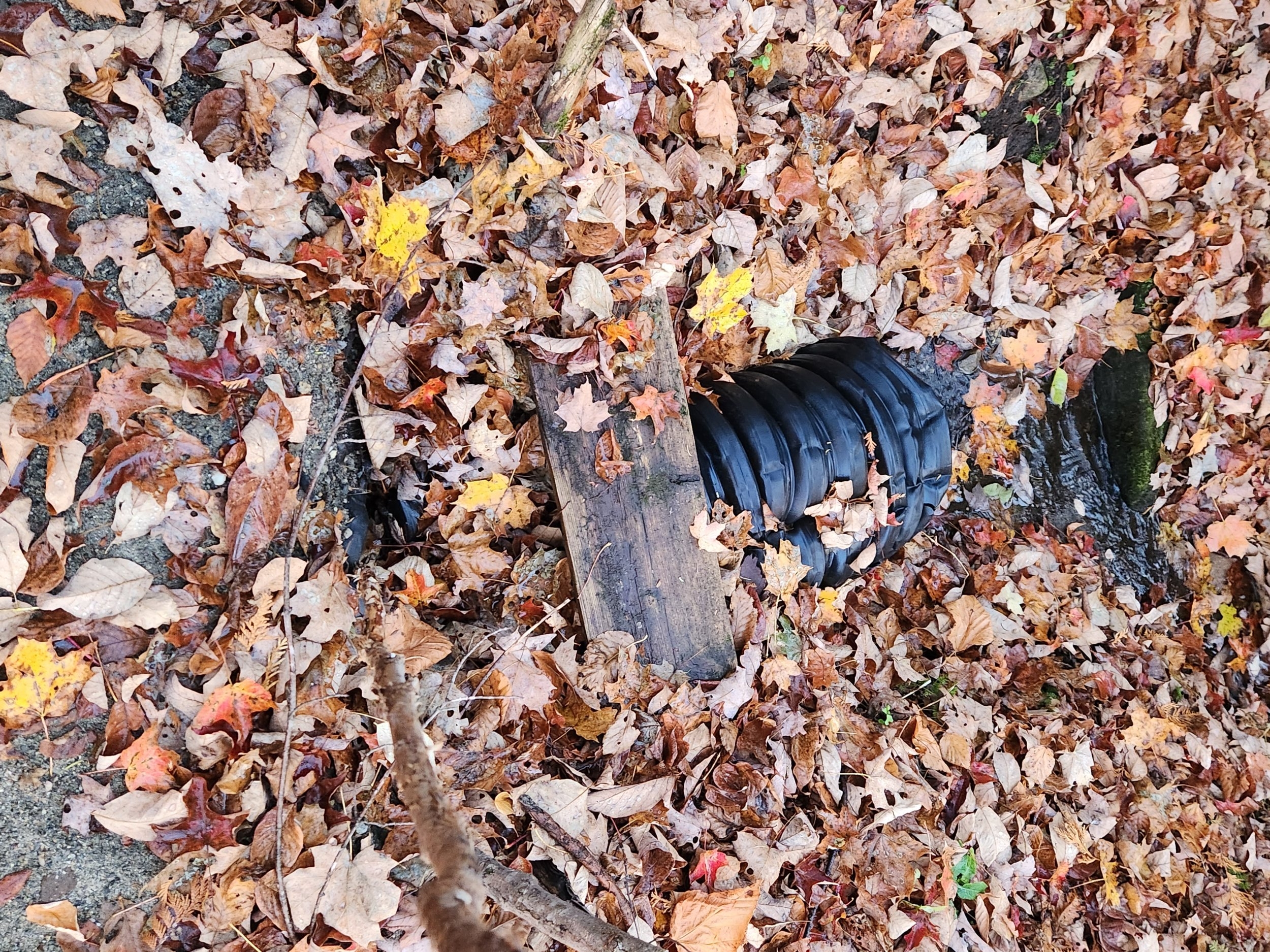

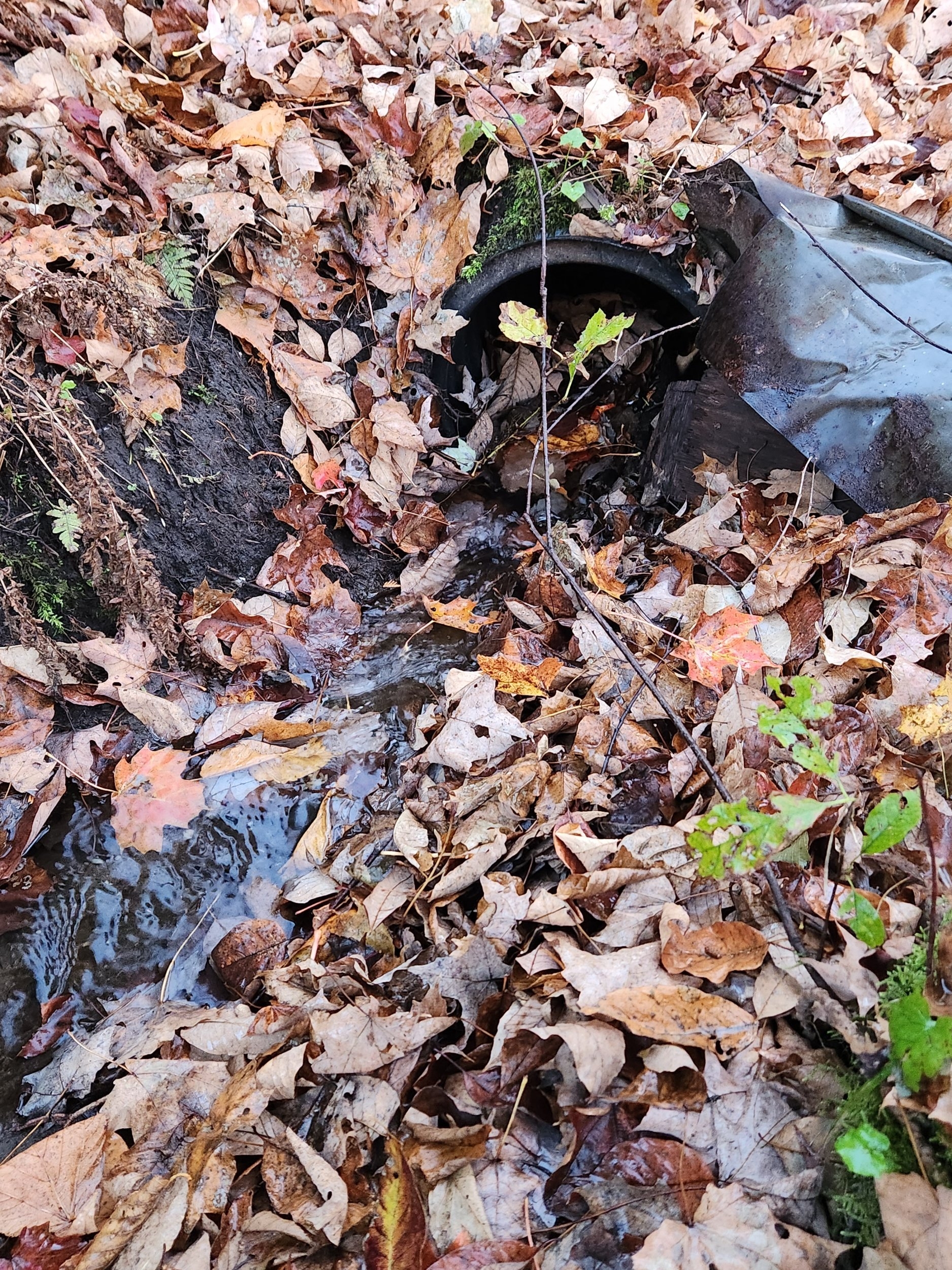

Ok, got some pics. Tons of leaves make seeing it difficult. 1st pic shows path. right to left id 8'
2nd pic shows left side of culvert, board is just to right of crushed/split pipe.
last pic shows leaf clog.. ugh

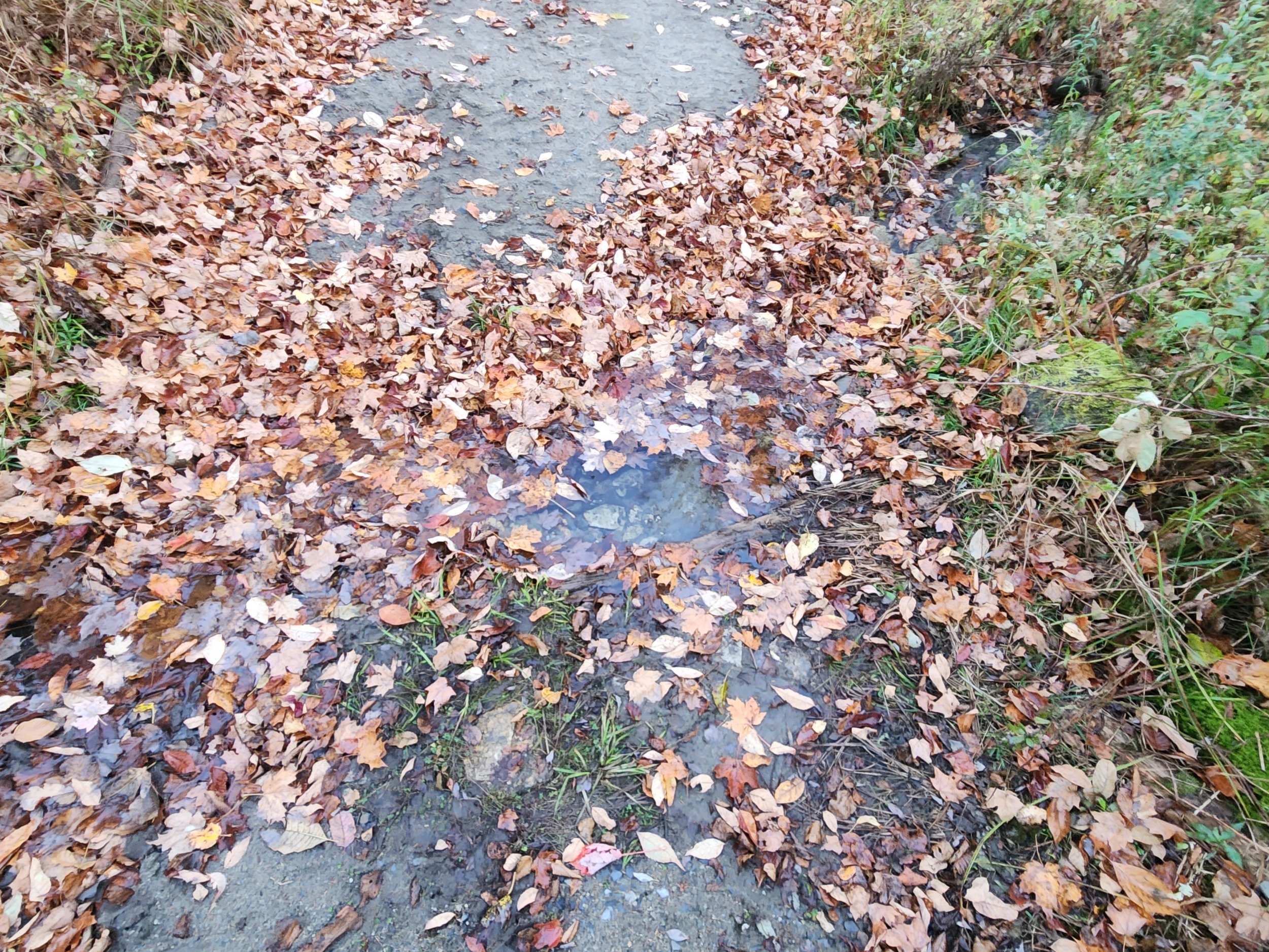

1st pic shows swail? where I cross with tractor. Description in previous post.

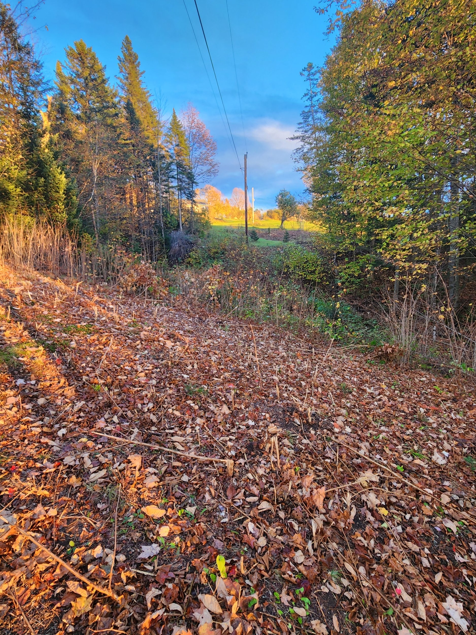

2nd pic is the electric companies ROW. No way anything getting through that. I only brush hog as far down as I feel safe. Deer, bear and moose have no issues though.
last pic is the just before swail I cross, to show not wide or deep of a stream.
