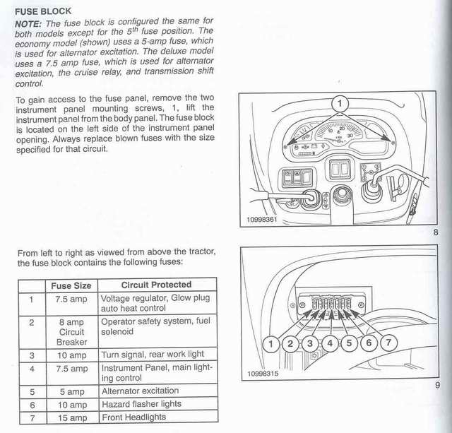

/ Crank no start #7
I can't say your TC40DA is the same as the diagram shown... but if it is the fuse would be Fuse #2 but I don't think yours is bad; usually if Fuse #2 is bad the tractor won't crank at all... but worth checking

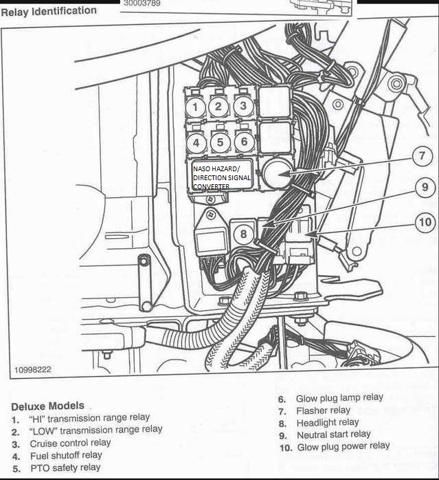

You can also check the Fuel Shut-Off Relay... Again, I can't say your TC40DA is the same as the diagram shown... but if it is, it would be Relay #4.
You can swap it with a like relay to see if that is the problem...
Just wondering.... How did you test the Seat Switch??
/ Crank no start
#9

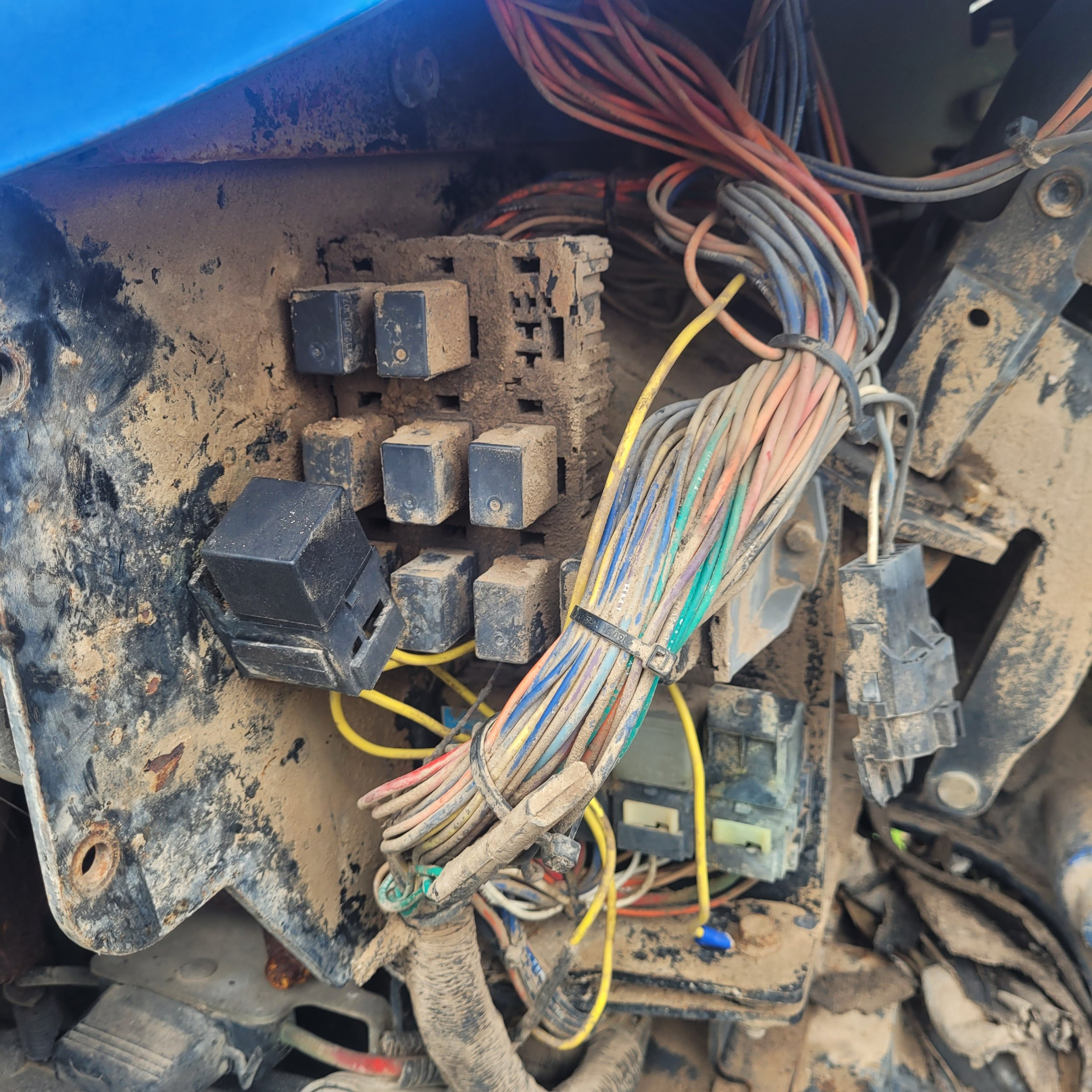

This is what mine looks like

If it were me I'd pull out 1 relay at a time and clean the sockets with contact cleaner . And reseat ur relays to start. lots of dirt there that can give you a bad connection.
/ Crank no start
#11
I actually just did that, I am searching for the bleeder screen for fuel now , all the videos I'm seeing are different than mine

This might be a referance for the relay locations as well:
  • Relay locations.pdf
/ Crank no start
#13
That looks like what I have. Thanks, I will try and replace the relay tomorrow.

/ Crank no start #16
On the number 6 relay in the picture (Fuel shutoff) while turning the key to the on position see if the relay clicks by putting your finger on it. If it doesn't I would make sure all fuses are good and if they are it could be a defective ignition switch.
