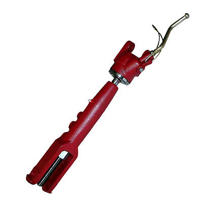

I wont be having a rear remote but thanks for the idea.
Thanks for all the other great ideas as well.
Maybe something will come along in time.
I used the crank style side link on my old L3430. In my experience it loaded up with debris frequently and was difficult to lube & clean. I much prefer the newer type which came standard on the L6060. I now use one on each side for a greater range of adjustment.
I'm not sure if it will fit the smaller L's though. I can provide dimensions if you need them.
Here's a link to the Messicks parts page. Kubota L6:cool:HST Parts Diagrams
I paid around $200 for it.
Here's a link to the Messicks parts page. Kubota L66HST Parts Diagrams
Sounds great.
Thanks for the reply.
I think I can run that idea by the dealership and see what they say.

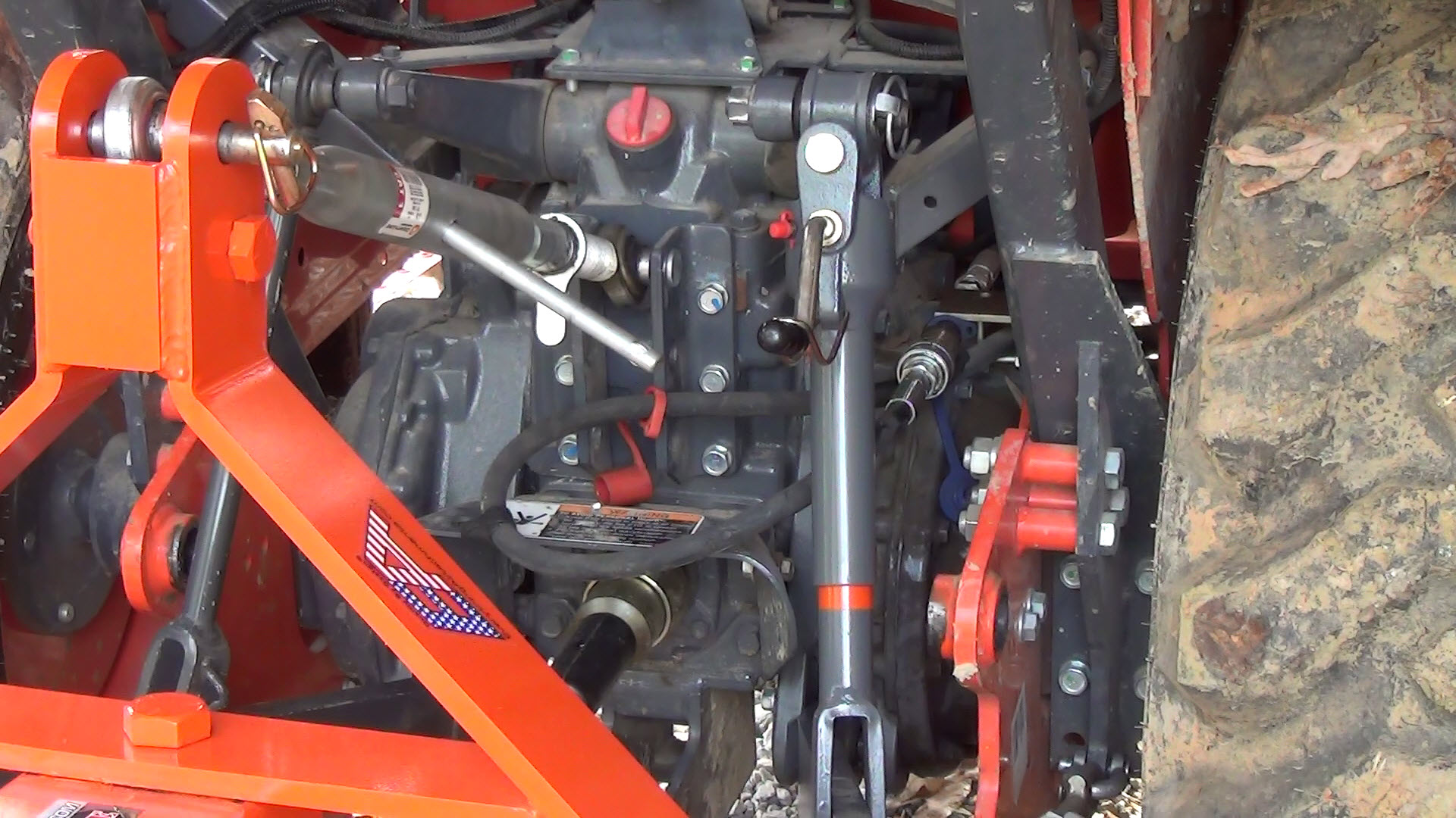

My JD 1070 has one. No matter what the crank handle position is, the end of it will hit me in the head when hooking up an attachment.
   / Crank Lift Arm Leveling Assembly #14
Liked the one on prior tractor (64 David Brown 990). with crank handle similar to this one.
Would not work well on current Kubota since the ROP makes accessing the lift arms cumbersome fro the operator position and I have long arms.
Would like top and tilt, but can't convince myself to spend the $$s on adding rear remotes.

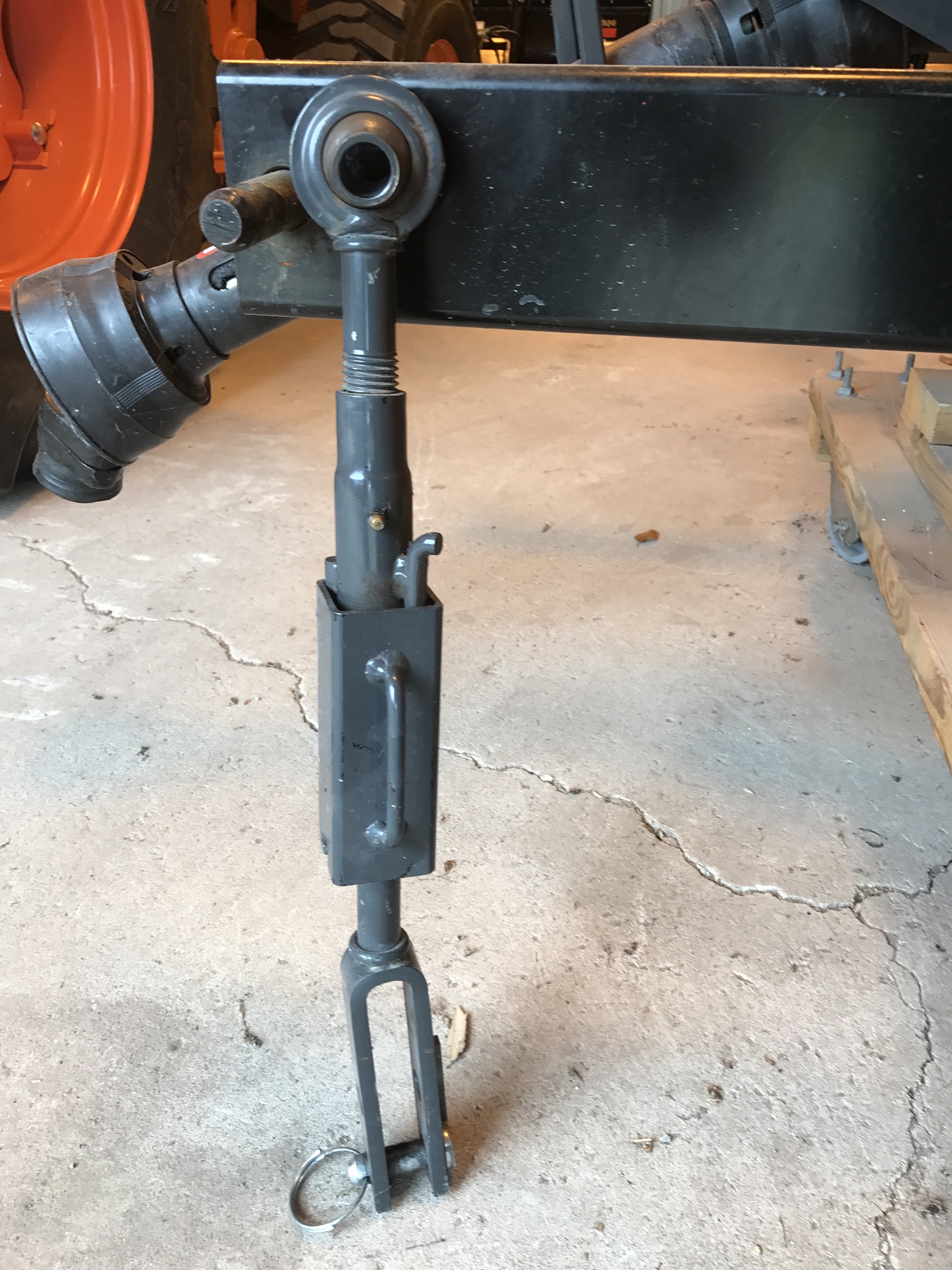

I was looking for a leveling box for my L3901 and found your post which led me to Weaver's Compact Tractor Parts as well. I bought one but had to make some modifications to it for it to fit. It has really worked well for me. I have attached a picture of it and here's a link to a video on how to modify it to fit a Kubota L Series tractor.
A Leveling Box for My Kubota - YouTube
Sounds great and thanks for all the help.
I really like that Youtube link with info. I believe Im going to check into this.

The Kioti side links that are from the same frame size as your tractor have clevis tops, not ball swivels like the Kubota. To get a side link to actually interchange properly, you need the same or similar working lengths, same top type connection and same lower clevis and angles. To get all of these things from a different model is unlikely let alone from a different make.
My guess would be no matter what you find, some sort of modification will-should be made.
