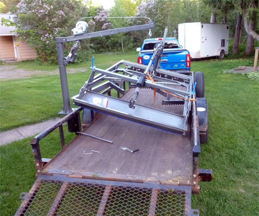

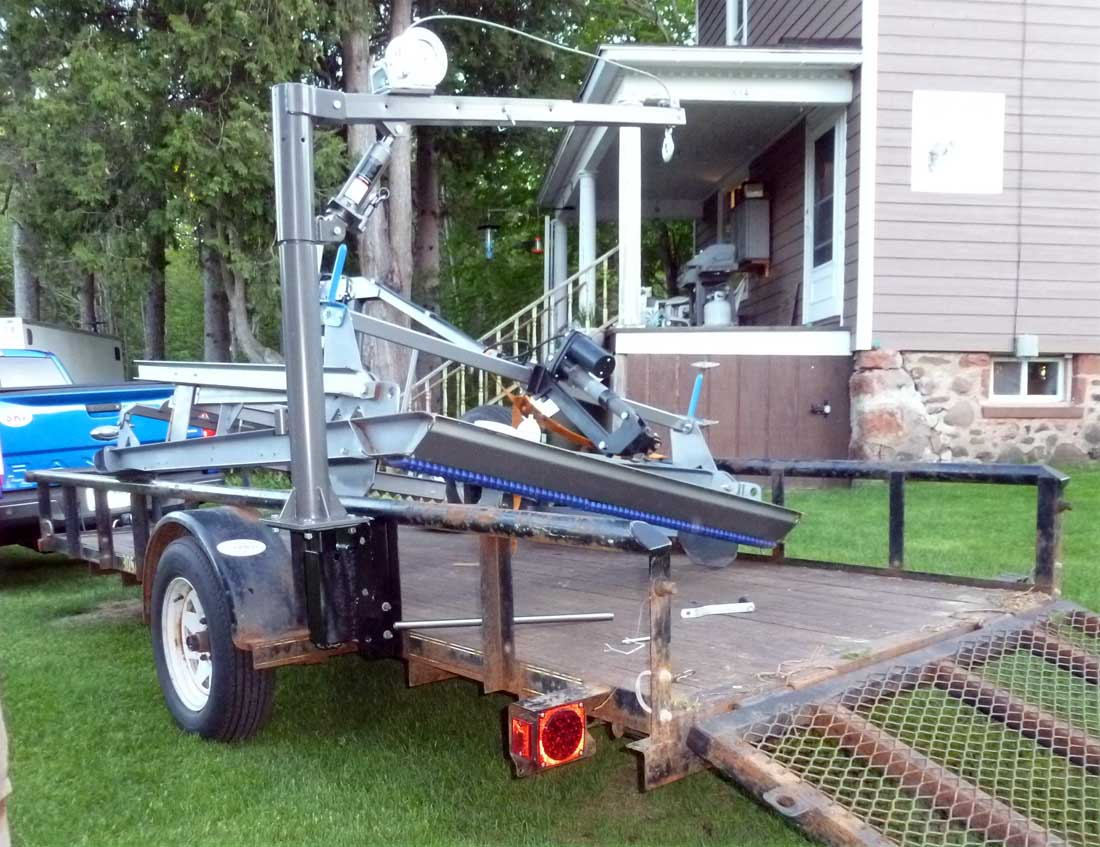

After loading and unload implements from our utility flatbed trailer many times, dearest suggested I add a crane to it. The crane is a inexpensive HF 1000lb max version. Receiver is a 2" hitch type I built so as to readily remove and add the crane and it will not be normally be installed on this trailer.

I have a short version of that crane in the back corner of my truck. wonderful back saver.

That will be handy. Most likely by next week you will be asking how you got by without it.

As of today the little crane has been used three times in three days. (y) Ironically dearest now says we need a wider trailer. I'll put this one up FS with or without the crane option. I was thinking $400 extra for the crane. What do you guys think?

I just attach the cable to the trailer and snug it up, so it doesn't rattle at all. The trailer is 5x12.

Now we are looking locally at a wider (important) and longer PJ trailer to replace it with. Might be moving the crane to it.

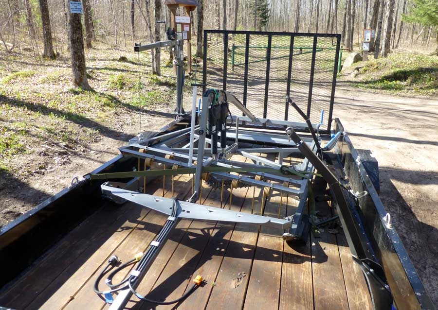

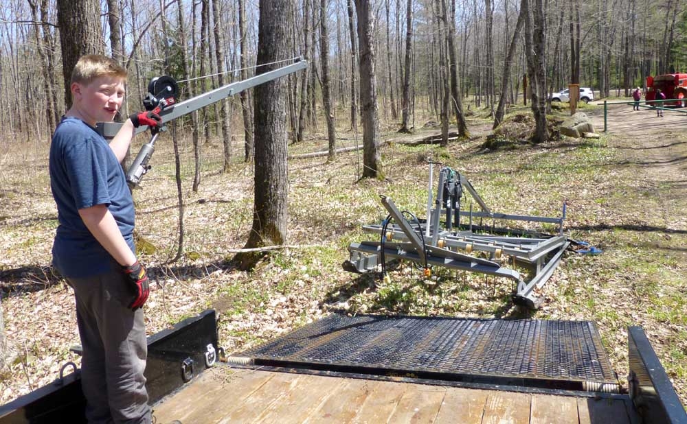

Here is the trailer with lift crane added promised some time ago of it in action. Got drag off the trails yesterday. Did have to reinforced the trailer sidewall twice to make it rigid enough. This crane addition reduced the labor of getting in on by 70 or 80%. We didn't lift all the weight, but with the front off the ground, its rear was easily moved.

Love this. I've been debating awhile on how to do something similar on one of my sailboat trailers, as it's an old woodie that always travels with a heavy fleeced bottom cover installed. That bottom cover has prevented me from enjoying that boat it as frequently as I'd like, as I can only get it on/off with either a hoist (which not all boat launches have) or the help of a few other adults to lift the boat and slide it off.
A gantry beam over the trailer wouldn't work, as it would interfere with the mast when launching, but I think this hoist looks like a perfect solution, if I can manage to beef up the trailer side rail sufficient to handle that torque load. The boat has lifting eyes and a bridle, but does require a good bit of height at the bridle connection point, meaning a rather tall mount for a crane like this.
