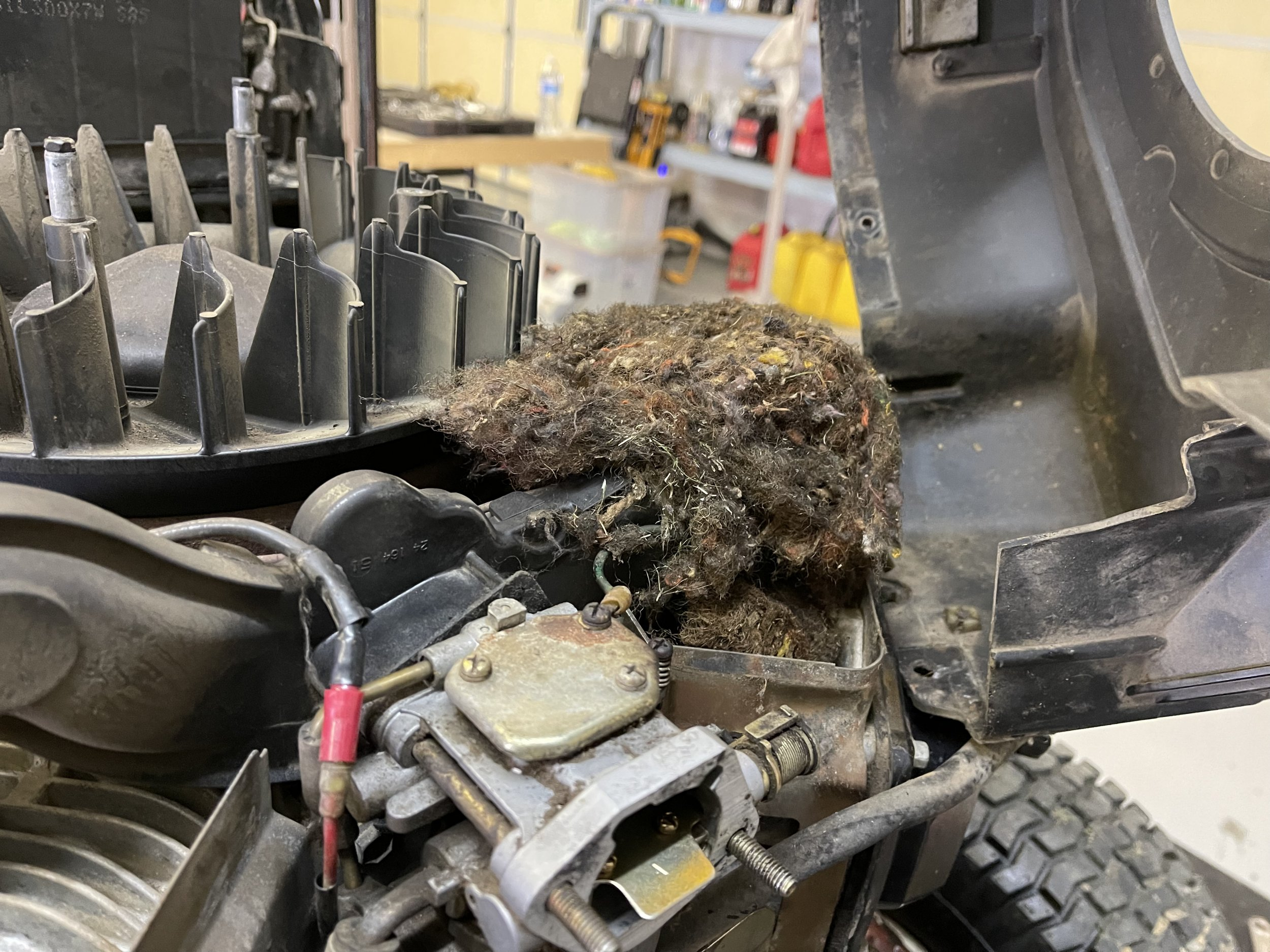

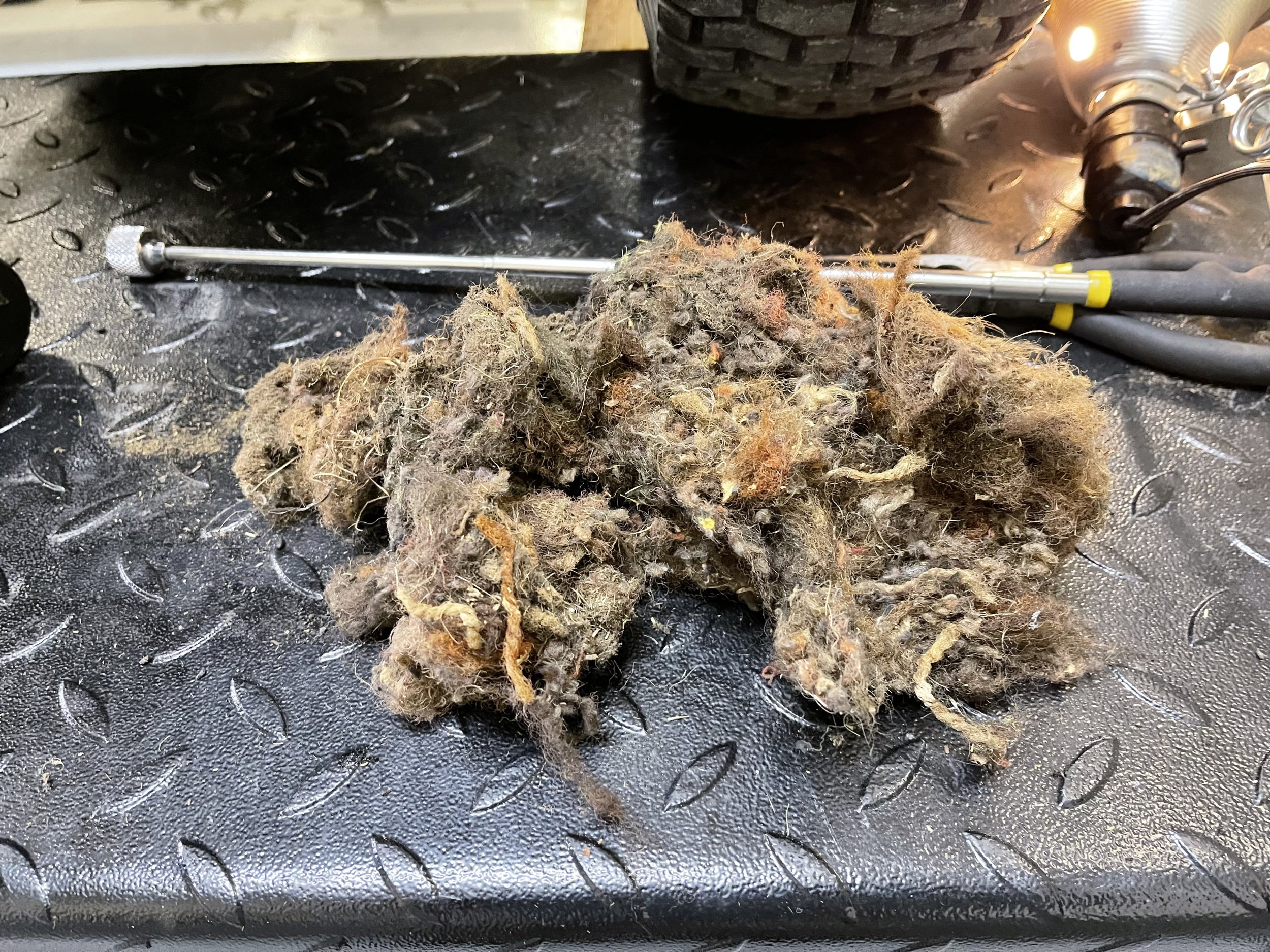

Oh, yes...you will love this. Along the way I saw more evidence of mouse infestation. We'd already removed a LOT from outside the engine with a shop vac and air compressor - this is mostly old carpet she also kept near the mower. My mother in law had kept her mower in an old wooden barn these last seven winters. She thought the shop that worked on her mower in the fall of 2020 had taken care of this - she had asked them to look for and remove mice evidence. They really ripped her off, which sadly happens to lots of elderly women in our marvelous modern world of "if you aren't cheating you're the sucker". But I digress. I shouldn't paint with broad brushes, but she sure seems to run into problems. Check out these photos - and the earlier thread comments about the fuel solenoid maybe acting up when getting overheated comes to mind. At least her engine fins are clean now.
