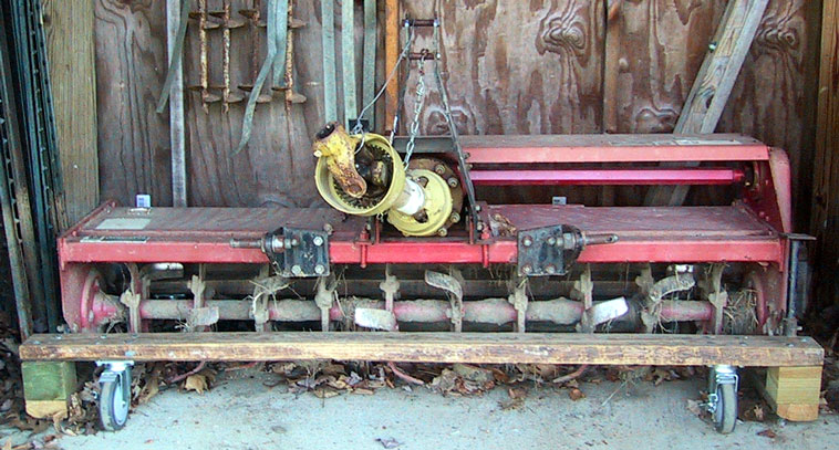

Here's my tiller sitting in it's dolly:
It sits on it's skids on the 2 by 4 laying flat at either end, which keeps the tines off the floor and leaves it stable. The blocks at the corners are to keep the tiller low while allowing clearance for the casters.
I thought the very old, very hard, 2 by 4s laying flat across the front and rear would be stiff enough but they weren't, as you can see from the bow in the front one. I added another 2 by 4 on edge on top of them after this photo was taken.
No need to bother with the silly little stand, as you can see.
This looks almost exactly like the cradles I made for my flail mower and box blade. Simple is fine.
