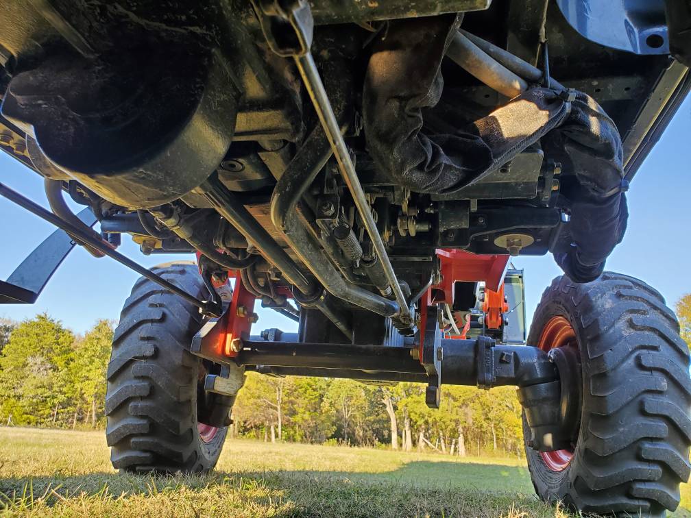

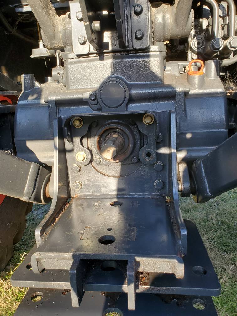

I checked my 2018 CK4010 SEHC backhoe (KB2475) installation bolts and the subframe today for any issues. Everything looked good and saw no evidence of stress fractures or cracks around the case. No visual evidence of any hydraulic leaks. I now have 320 hours on the tractor, and about 150 hours using the Kioti backhoe for mainly culvert installation on the ranch.
My backhoe install has a total of 10 bolts; 4 bolts under the case and 6 bolts near the PTO, which secures the backhoe subframe to the transmission case. Photos are attached.
IMO cracks would indicate high stress has been applied to the mounting. Perhaps the stabilizer legs were not always supporting the backhoe during operations, and torque was applied to your mountings on the case, inducing stress fractures, which are now the cause of hydraulic leaks. Working "aggressively" breaking out a concrete pad with the backhoe may also create stress on the mounting.
   / Cracked Transmission case between bolts attaching backhoe #17
I looked at mine yesterday and everything looked good. I wonder if the rear mount is twisted, putting uneven pressure on the case when the bolts are tightened? When the mount was fabricated maybe something was misaligned or not properly in the jig.
