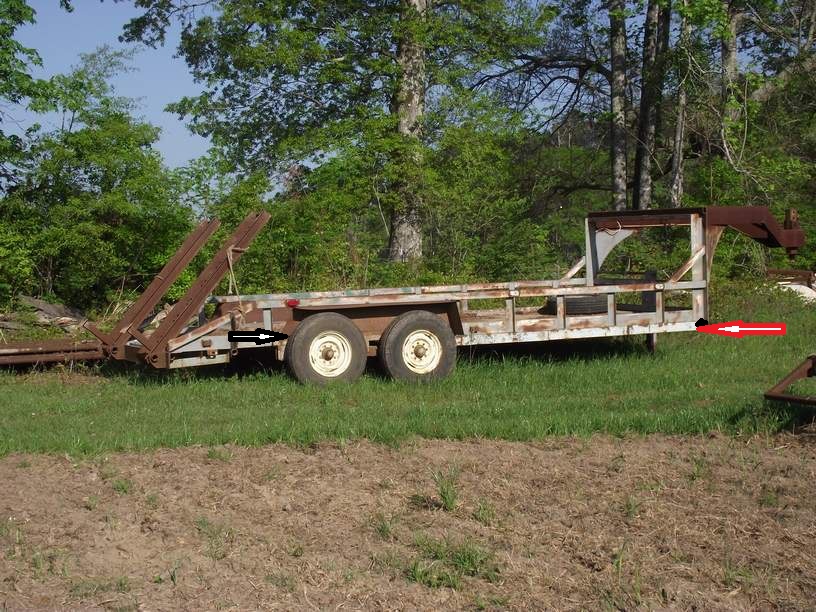

The trailer I got with my last truck purchase had a similar problem, and flatbar was welded down the bottom edge of the frame to strengthen it, it worked, but lowered the amount of clearance. I understand teeter toter, but think when the truck is being lifted, it would try to rip the welds at the front of the tongue and compress the rear of the tongue welds which would not likely crack them. David from jax

This is the trailer I was referring to, with the adding 3" flat-bar below the tongue to the front wheels area. That flat-bar added quite a bit of strength to the trailer. It isn't real easy to see, just look for the different shade of rust under the front of the trailer and that should make it clear as mud.
David from jax
Is where the black arrow is or the red arrow? Or am I in right area? Kind of hard to see

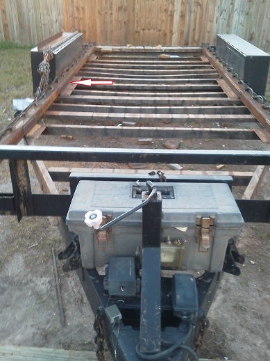

Got all the bracing welded in today, its stout like a 6" channel box with a 6" full wrap tongue trailer stout! Whole lot stouter than when I got it..
