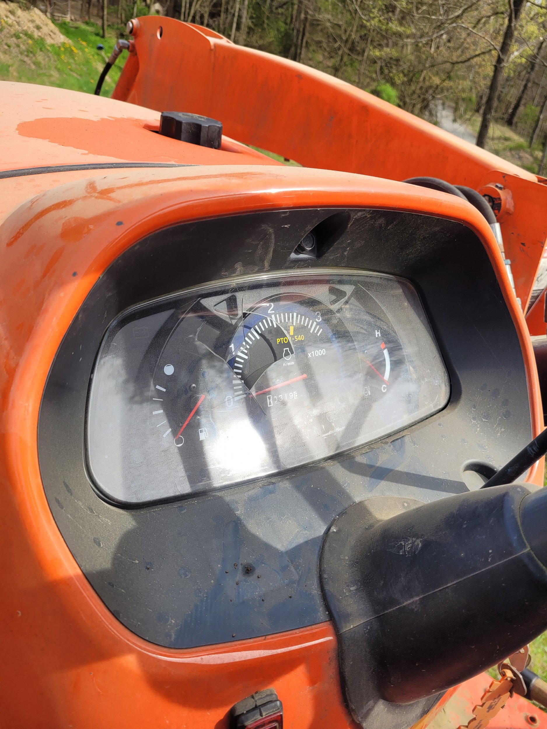

How and where can I find a new BEZEL for the dash or how to repair the plastic cover on the dash of a 2014 L3200?
A young man had an "incident" involving a dropped ratchet now we need to repair or replace the dash.
Not having luck at the usual Ebay/Amazon/Craigslist for used stuff and parts.
Any suggestions? Thanks!

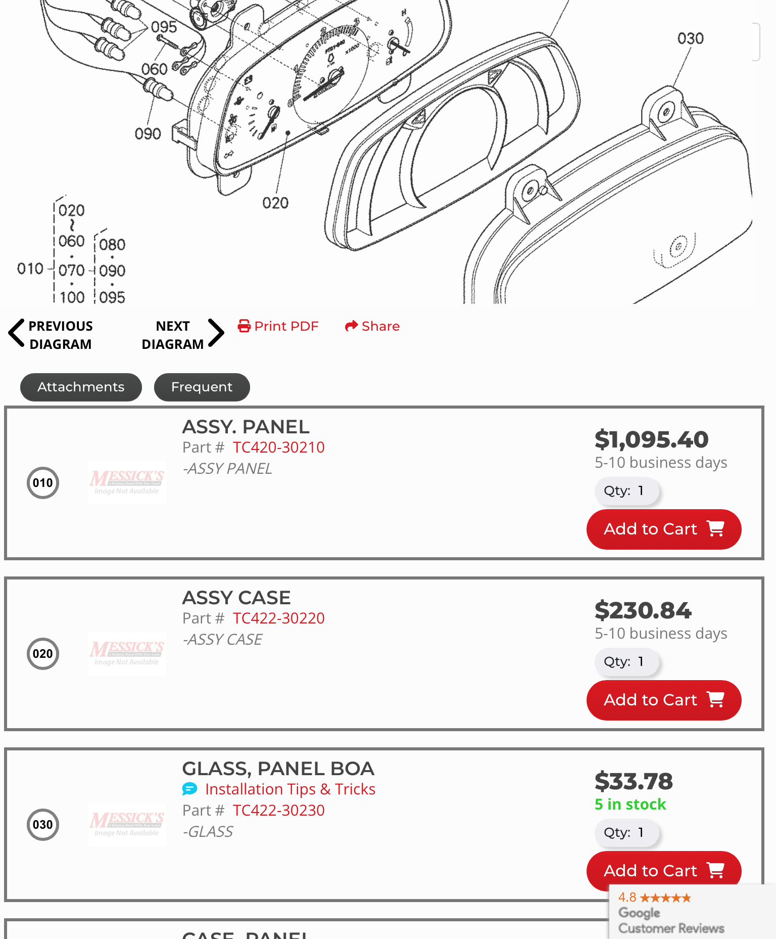

Looking for a part number or a source. I can't find squat. Don't know the part number, searches are not helpful. Any help with part number or where to look would be most appreciated.
/ Cracked broken dash plastic for L3200 (2014)? #4
From Messicks (they do online parts sales)
L3200 HST
/ Cracked broken dash plastic for L3200 (2014)? #5
Not really glass, it's (I believe) some type of hard plastic. 33 bucks ain't bad, wonder what the ship cost is? Knowing Messicks, 33 bucks...lol
/ Cracked broken dash plastic for L3200 (2014)? #6
Yeah, their shipping is always expensive. But I will say that they have an easy to use ordering system, and the correct parts are delivered fast.
/ Cracked broken dash plastic for L3200 (2014)? #7
Stated on here in the past that their shipping is exorbitant. Why I quit buying from them when I can get the same stuff from my dealer and no shipping cost, plus my local dealer will deliver to the farm as well.
/ Cracked broken dash plastic for L3200 (2014)? #8
I might add that Coleman's in Kansas City, their ship cost is much less if you want to go that route.
#9
That's great info, thanks! It's not HST, but I have to get the submodel info. Do they use the same panel and bezel?
/ Cracked broken dash plastic for L3200 (2014)? #10
It's the same part number for the L3200DT, F, or H
/ Cracked broken dash plastic for L3200 (2014)? #12

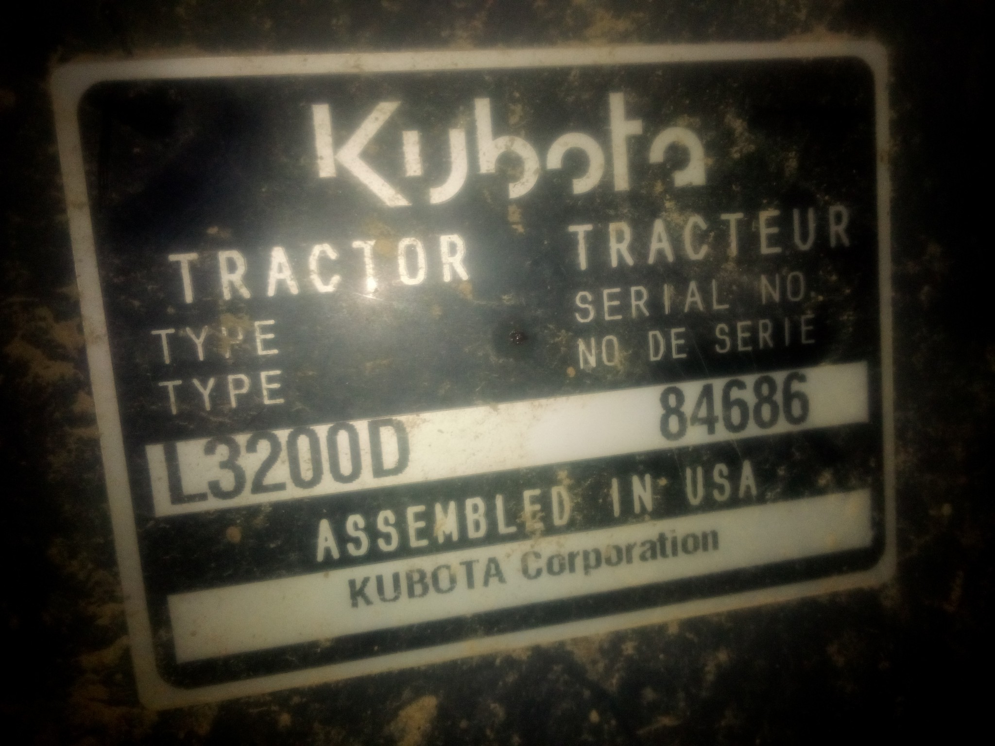

Thanks. I just got the plate info. It is 2013 L3200D. Same part?
D and DT are the same, although I'm surprised the plate didn't have DT on it. I believe D/DT is the 4wd (Dual Traction), F is 2wd, and H is the HST.
You could always call Messicks to confirm that the plastic lens is the same for all 3, but every L3200 variant they listed took the same lens.

Thank you! That does sound odd. Here's the plate

I ordered one from our local dealer. Thanks again!
