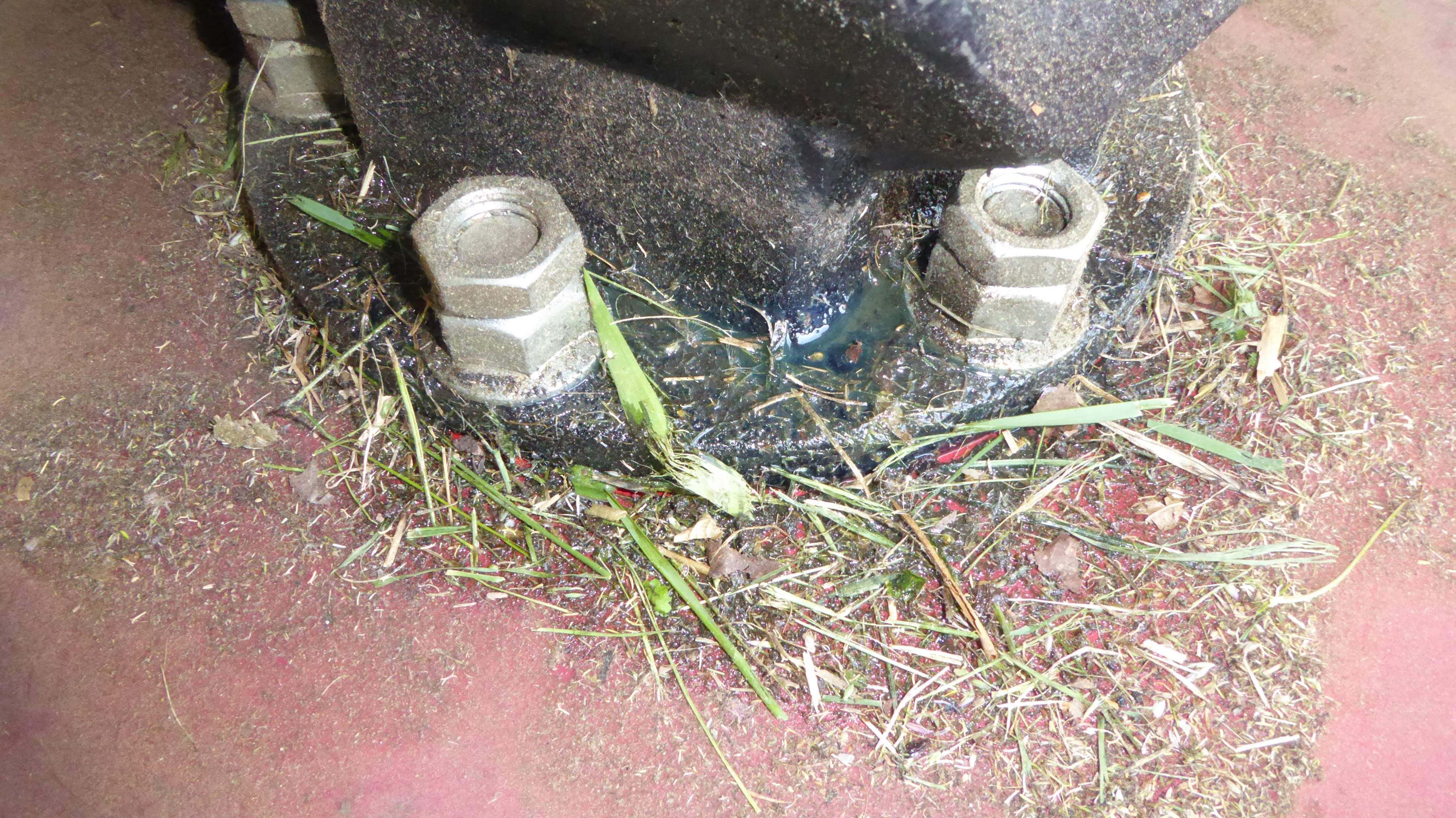

Model 297 Bush Hog brand. Normal pasture clipping and some brush but nothing huge. Might have 50 to 70 hours on it. Using 81hp tractor to run it, well within specs on everything. Never hit anything catastrophic (like a big stump or boulder...) Found a horizontal hairline crack in the gearbox housing maybe an inch or two above the bolt pattern. Only noticed due to oozing gear oil.
Anyone else seen this ?

manufacture defect maybe? improper setting of the slip clutch? slip clutch was not maintained to slip like it should.
if under warranty get it replaced. there is a good after market for gear boxes out there. double check hole pattern, and spline sizes for going to slip clutch and then down to stump jumper. and bigger issue make sure ratio is correct. and if using 540 vs 1000 rpm setup.
http://www.bushhog.com/uploads/documents/RC295-297-SPEC.pdf
showing 1 year limited warranty with a 5 year gear box warranty.
50-70 hours i would imagine you would be within warranty. even just running it 15 hours a year...

This was bought as a brand new unit and the slip clutch appears to be set right and working well. It was adjusted. I don't have a high rpm pto, just the std 540. It's under warrantee, not worried about that. Just wanting to hear if others have seen this problem and if there are theories about the cause. The mfr says they have seen it before and cannot explain it. As a mechanical puzzle, I cannot see how anything done with that bush hog could create a force to split the thick heavy gearbox casting like that -- at least not in that location. This is just a hairline crack at the left rear corner of the gearbox. Seems to me like it may be a casting defect.

Was it right above a bolt or somewhere in the body? If it was right on a bolt head there could be some pressure from a corner on the casting, but I would guess they are saving some weight on the casting or using some rough stuff. I think most are coming over in ships. What is the thickness of the gearbox flange and casting area that cracked, do you figure?

In this photo the hairline crack is at the corner of the gearbox halfway between the two bolts. Note the lube that has seeped out. The crack cannot be seen even when this is blown up, but is horizontal and about an inch above the flange. The crack is maybe an inch or 1.5" long and wraps around that corner. I can't tell how thick the metal is but from the overall shape/size of the gearbox I'd think it is at least a half inch thick. Seems to me to be a casting.
The spec sheet says it is rated at 130hp with min recommended of 55 hp. I use a MF2660 with 81hp.

The manufacturer is backing it. Just downtime, and expense of time & transport to the dealer. Bush Hog has been very good about it AND admitting they have had some of these failures and do not know why. Say their supplier does not understand the cause either. No idea where it was made but has the Bush Hog name in raised letters on the gearbox.

OK, here's an update: BushHog responded to my email, said they would back it. I took the hog to the dealer where I bought it, the company shipped a replacement gearbox to him and he put it on. I have put about 5 or 6 hours on it since the gearbox was replaced and had no problems. It took a while to get all this done but I am only able to work the equipment one week a month so it was not a big deal. I would still like to hear from others who have had the same issue (e.g. a hairline crack in the BushHog gearbox an inch or so above the bolt pattern on the deck, leaking lubricant, no apparent cause.) I have had no feedback from anyone with the same problem but Bush Hog said they had some of these and I was not the only one.

JWR, I know this is an old thread. Just wanted to let you know that my BH296 cutter has failed in the same place and in the same fashion. I own a fab shop so I have already repaired the casting with nickel rods but I can tell you and Bush Hog exactly why it failed...... Although, from the outside, the casting looks very beefy and thick, the lower side wall of the box is less than 1/8" thick in some places. Way to thin for this application!!! As you know, the base mounting flange on the gearbox is about 7/8" thick then it immediately transitions to 1/8" thick up the sides. When welding a crack in cast iron it is standard practice to drill a hole at each end of a crack to help prevent the crack from continuing on after the original crack is repaired. I was expecting the sidewall to be at least a 1/4" to 3/8" thick when drilling but the bit unexpectedly punched right through the side with no trouble. I doubt they will make my gearbox good after 4 years but I bought a Bush Hog brand cutter simply because I expected the best quality from them. The other posters above are correct about these gearboxes being made in China. My gearbox has a Bush Hog ID tag on it that clearly says MADE IN CHINA. I had not really considered contacting them until I read your thread but now I think I will since it is a known problem, especially after getting a quote of $1200 from the dealer for a replacement. Now I wish I had waited about welding up the crack. I'm sure it is just a matter of time before it cracks again somewhere else.

Looking at the photo of the location of the crack, The defect is in the casting thickness at the intersection of the gear box and the mounting flange.
The flange is the member that takes the torque reaction from the transmitted power. It would be interesting to know if the crack appeared on the drive Tension side, or the drive compression side. That might give an idea as to the nature of the load that caused the failure. Shock load or other.
The design weakness is not enough material at that corner. As a sand cast part, it would be easy enough to shave off a little from the mold to add thickness. But since the supplier is "over there", That's going to be like pushing a chain up a hill.
Still, It's good to know that the internals of the gear box can stand the beatings, while the case can not. I have never heard of a reputable maker not standing behind the box that the dear parts are housed in,
Think of it, If you had not noticed the lube weeping out, and run the box dry. Seizing the bearings and burning up the shafts etc. The defect would go unannounced, and you would be buying the replacement box.
Good for you for PAYING ATTENTION! ;-)
