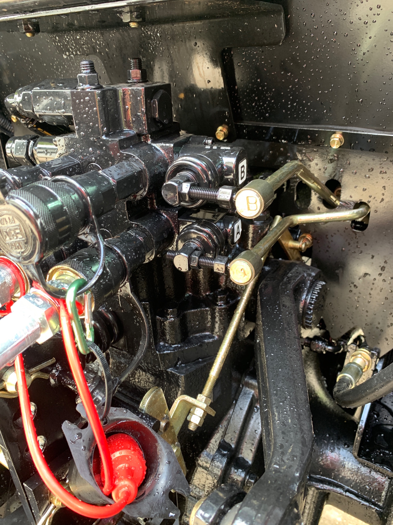

The only complaint I have with the hydraulic top link is that when you switch to another implement you have to get out and back in the tractor to move the top link in or out for your adjustment just so you can hook up the implement. On the manual top link you don’t have to get back in the tractor. Wish there was a way to do it from outside the tractor.
Look at the linkage from the remote's levers to the actual valve body, which is probably under floor or behind the cab. You may be able to make an extension lever from there to the back so you can operate it while hooking up an implement.

My Branson has the remotes in the same place but the linkage is not as straightforward as that. Looks like it'd be easy to fab up an extra lever there. I'd use a locknut and a tall nut on the threaded part and weld a lever to that.

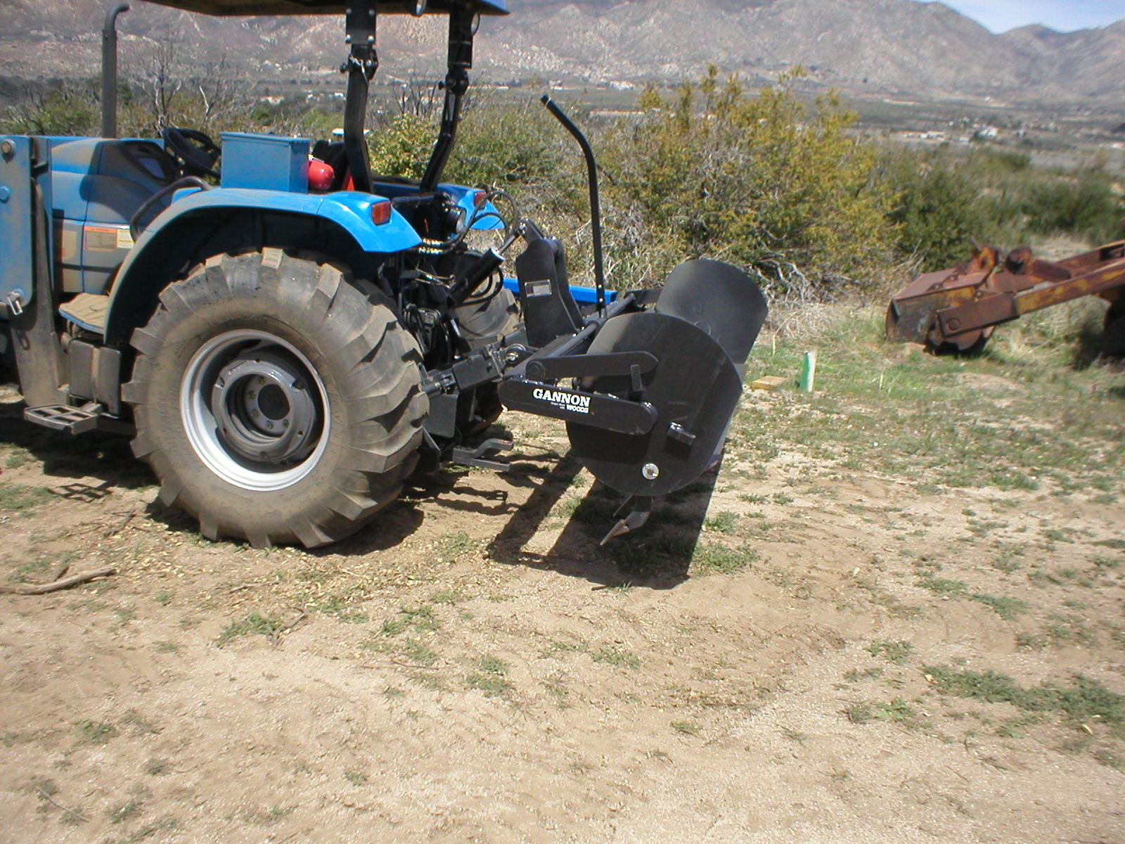

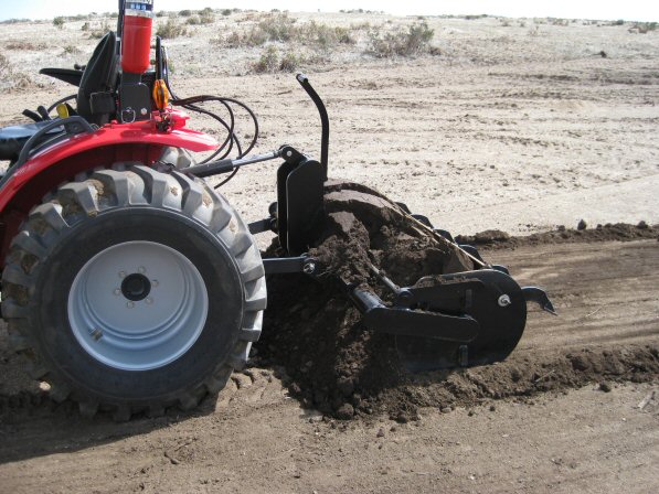

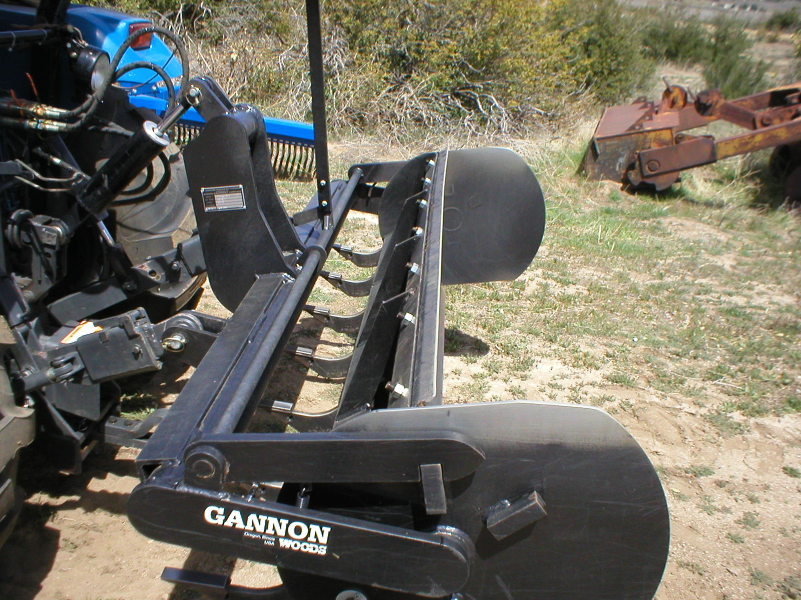

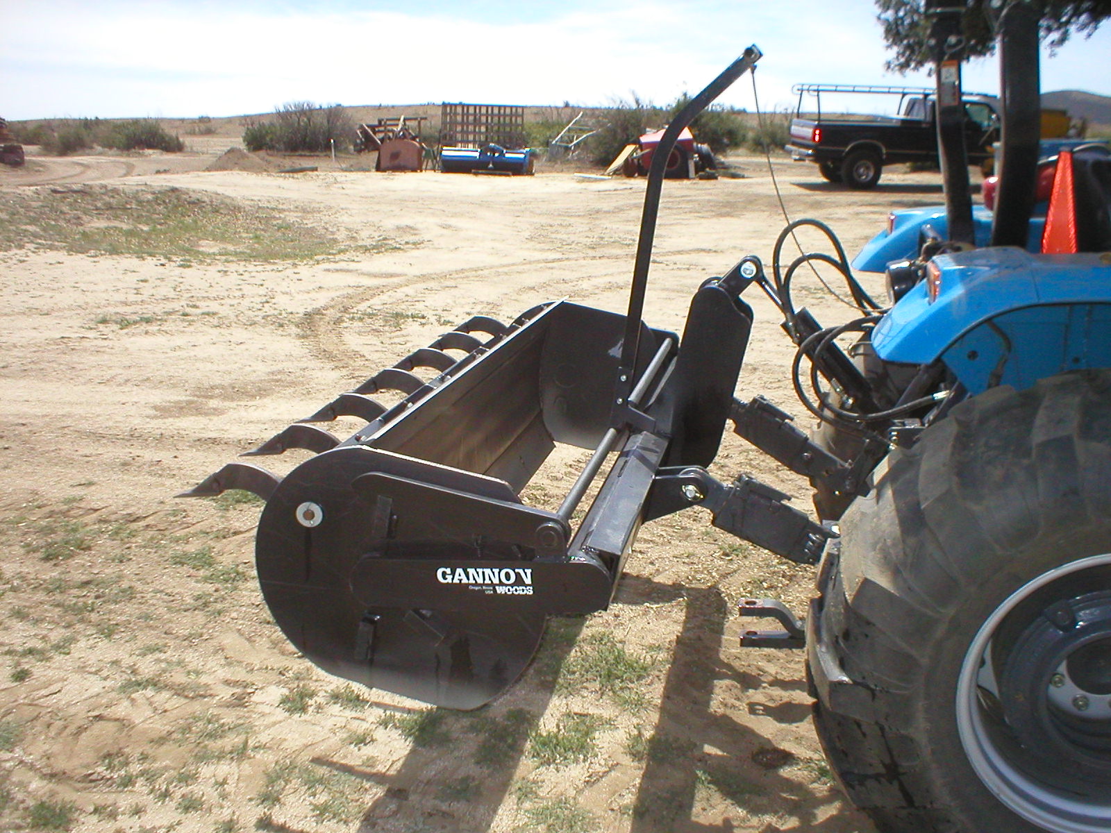

I have a heavy ROBB( roll over box blade ) and LPGS( land plane grading scraper ). Both have manual shanks. If I could only have one - the ROBB. It does tasks the scraper can not do. The ROBB will crown the trail/driveway, clean out the ditches, move material from here to there, etc, as well as smooth things out.
The hydraulic top link is much more useful when coupled with the ROBB. That's because the ROBB is capable of so many varied jobs.
Just so that Bridge4 knows what a ROBB is. It is a roll over box blade I highly recommend a 65" unit for use with your 2638.
I have and use Gannon ROBBs myself, an 81", 65" and 36" units. Unfortunately Gannon stopped building them back in 2005-2006. :(

So I figured all I need to do is pull on the connecting rod just a bit and I can move it. I’d love to weld a lever on it, maybe this weekend.
