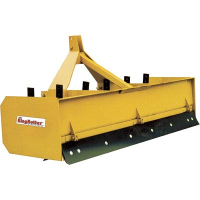

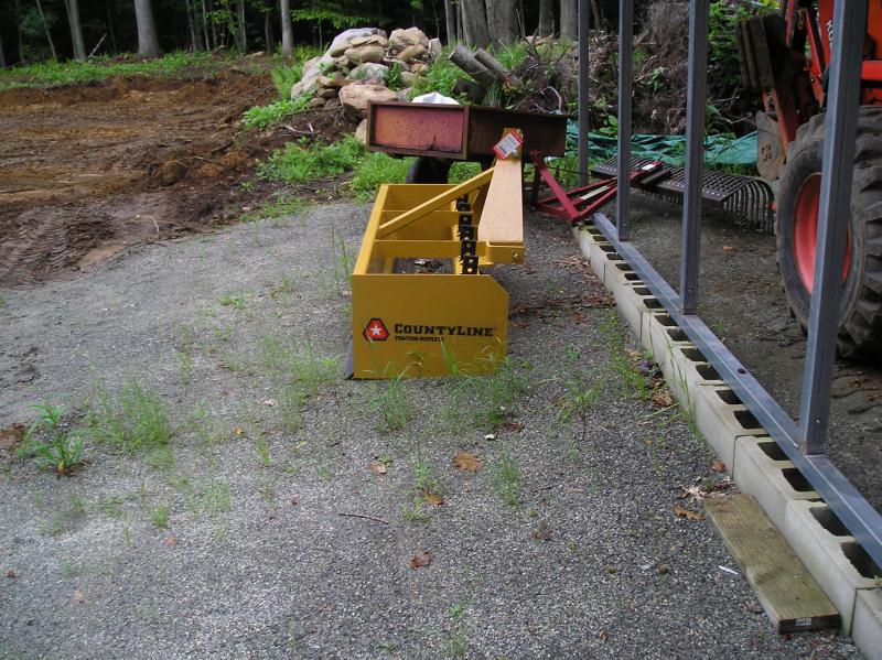

Very good question Mark. I ordered a HD KK box blade from my local TSC last year.. it took a few weeks to show up. Durring the wait the KK BB is removed from the on line catalog. Finally shows up, looks like a KK, but has a CountyLine sticker on it... this is one heavy duty box blade so I'm happy, but it doesn't appear to be offered in this HD version anymore? first pic is mine, second is the picture from the on line TSC catalog I ordered from.
