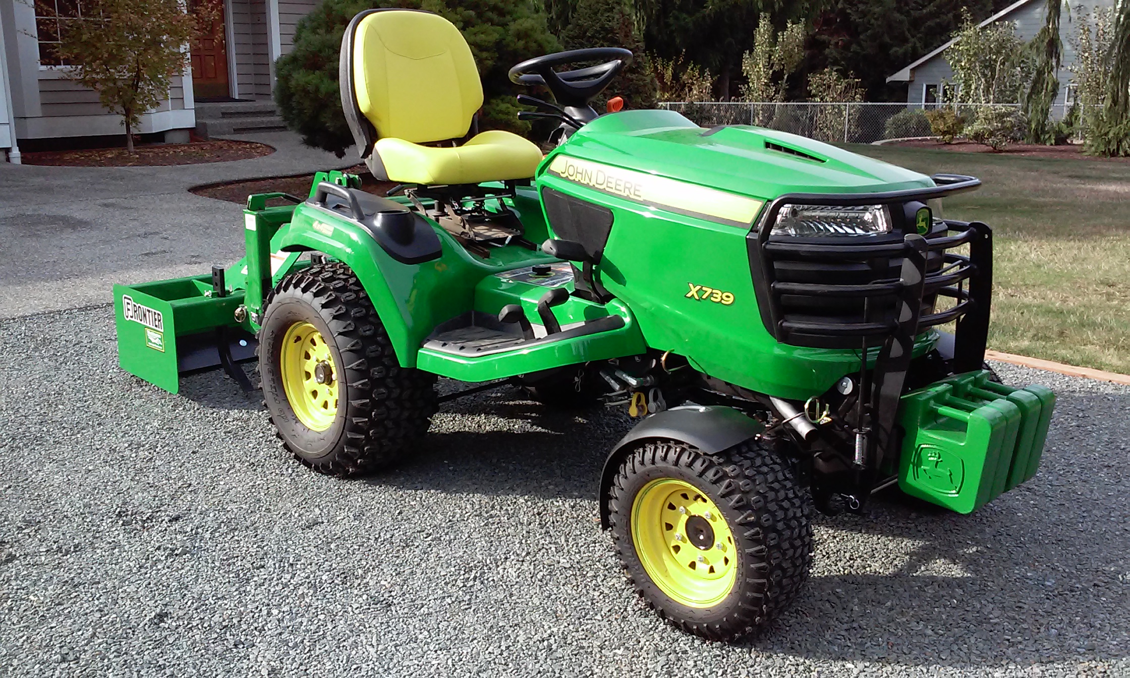

I'm looking to make a frame for the back of my X738 for a sprayer. I have not yet pinned down the model of sprayer, but it will probably be a 16 or 26 gal unit from Northern. Filled with water that comes in at 128 or 208 lbs plus the sprayer which looks like 25ish. Then add a stainless frame out of angle which might be another 50 lbs at most (more likely in the 20-25 lb range), and I'm looking at a total rear load of 200-300 lbs. Obviously things are still in flux as I have not bought anything yet (other than the leftover SS I have from earlier projects) so I am open to suggestions. Spraying would be primarily for weeds, prob a 2-4-D variant for the most part. So that's the first part I am looking for any advice on.
So the second part is front counterweights. I have some very steep areas I mow, which is why I ended up with the 4wd mower, so I need to make sure I am not going to get tippy with that extra weight hanging off the rear. I could certainly make weights from concrete to hang on the front frame, or I see Deere has them available for like $60 ea for a 42 lb weight, but I may need to buy some additional overpriced bracket to hang those. So how much weight should I be looking to add? I would expect the sprayer is going to have a bigger moment arm as it will stick out more than the front weights. It looks like the overpriced bracket can hold 9 so 378 lbs there. I am guessing that is overkill but really don't have a feel for how much to aim for. Thoughts?

But for the OP, just hang some 40# suitcase weights on the front weight bar.. should be no problem then. Appears that some 42# weights will slip on the front without the addition of the purchased bigger weight bracket.
A close-up pic of what you have would answer that..

The front looks just like the main photo here:
Lawn Mower Tractor | X738 | Signature Series | John Deere US
No extra brackets on there right now, but i know I can give the Greene people $200 for a weight bracket that mounts there. Or I can just hang homemade weights directly on it, as is. The question remains - How much weight?

Deere recommends four 42lb weights when using their 25 gal sprayer. I would start there since the X738 can hold four without buying an additional bracket.

Excellent. Thank you for that info Eric and Ruffdog. I looked into the Deere sprayer a bit from your recommendation and that helps out a lot. I see better how the "click and go" works now. I wasn't aware of their sprayer previously. And 4x42=168, so I can figure out how to get to there either with the Deere weights, aftermarket or DIY.
