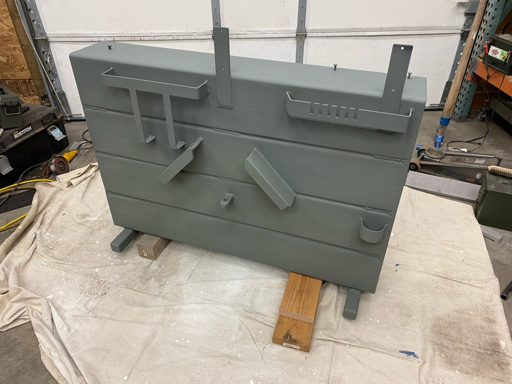

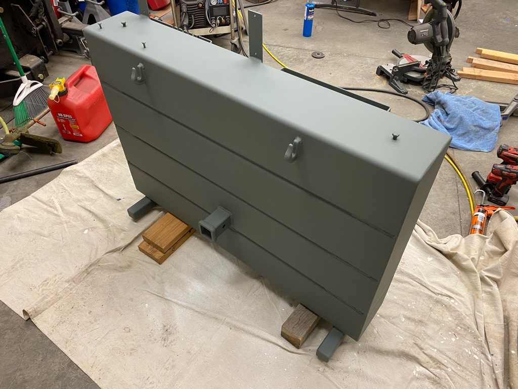

#22
All done! (Well, just about)
I’m actually am going to try to get a Branson decal to slap it on for the finishing touch,… maybe come up with a “Model Number” to make it look like it’s from the factory?
Thanks to Texasmark, color is Rustoleum Cherry which I had to buy from Amazon since no one carries it locally. I got pieces of stainless steel plates for the heavy wear points. Double sided automotive tape was used.
I’m going to get a small trama kit for loggers to store either on the tractor or the ballast.
/ Counterweight build #26
That looks fantastic and functional. Is that hand screw just putting pressure on the chainsaw bar to keep it from sliding out?
#28
Yessir, it’s a bolt with the head ground down thin and thru a T-nut countersunk slightly on the inside. A T-handle with a jam nut completes the assembly.
/ Counterweight build #30
And it comes in any color you want, as long as you want RED!!!
Go out and put a scratch on it...to break it in and just to get that over with
Nicely thought out build!!!

That’s why I installed stainless steel plates over the wear points of the delta quick hitch! . Currently it’s still on the Brandon, but barely off the ground so I don’t scratch the paint on the skids.
/ Counterweight build #32
See ..... It's like I said. Now it's time to install on your porch. Put small carpet pads under the skids and the paint won't get scratched. :)
