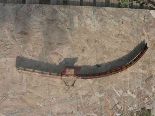

Well I Dunnit now /forums/images/graemlins/frown.gif While brushing I ran over a steel fence stake. It was laying flat on the ground and the front tire went over it and the pressure caused the stake to point up towards the back (underneath the tractor). It wedged against the transmission case (after breaking the steel line going to the tranny filter) raising my B1700 back end off the ground /forums/images/graemlins/shocked.gif /forums/images/graemlins/crazy.gif /forums/images/graemlins/shocked.gif. The stake bent until the weight of the tractor finally caused it to snap forcing one end of the shorter piece about 8" into the ground and the other end punched a hole in the tranny case /forums/images/graemlins/frown.gif. HOT OIL shower anybody.. I made it to the Kubota dealer Saturday and got a rough estimate to fix it. The new tranny case was only $217.00 but they told me that with labor it would be around $1,500. They were up front with me and that's great and also recommended trying to use JB Weld 1st?? I've never used it but everybody seems to swear by it. If that doesn't work I may try tapping it out and making like a oil drain plug. Any suggestions?? Pictures to follow if I get it right.

Pic #1 of the culprit (Larger portion before it snapped)

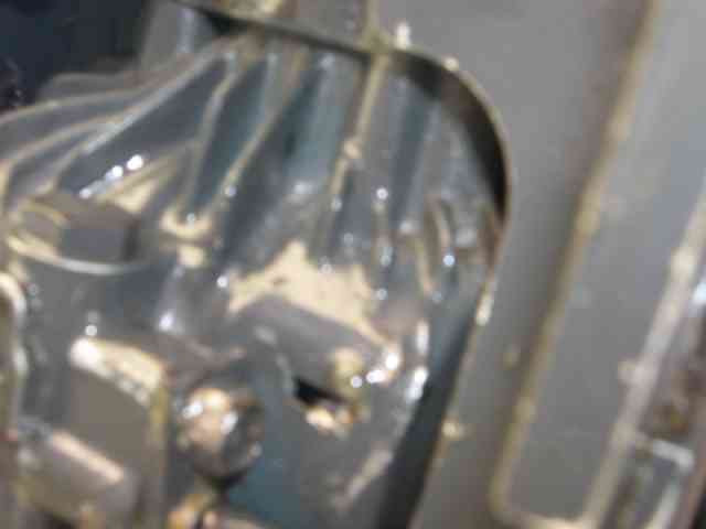

Pic#2, sorry for the blurred picture (trying to dodge hot oil)

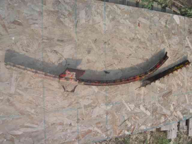

Pic#3. The shorter piece that had to be removed from the ground/tranny case.

Absolutely you can weld aluminum. If you can pull that part off it would be better. You should be able to fab a patch and weld it on, should be good as new!
BTW, DO NOT put a bunch of JB weld or epoxy on there if you hope to ever weld it, aluminum has to be really clean to weld properly.

If you can, I'd try taking the whole tractor down to a very good welding shop and see what they say. I bet they could weld a patch over the hole for a couple hundred bucks and you'd be as good as new.

It looks like a clean break. A good welding shop should be able to get you fixed up ok.

That hole in your case can be fixed. Take the tracker to a good welder that welds alum. When you call around to find this welder tell him this case is alum or it could be cast alum. You shouldn't try to clean the the hole yourself let them. Thiers alot of chem. that react with welding like break cleaner and other cleaners.They'll have the right alum cleaner,just wipe clean with rages for them.Hope this helps you.
