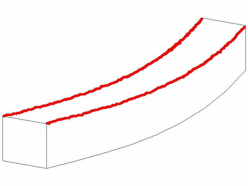

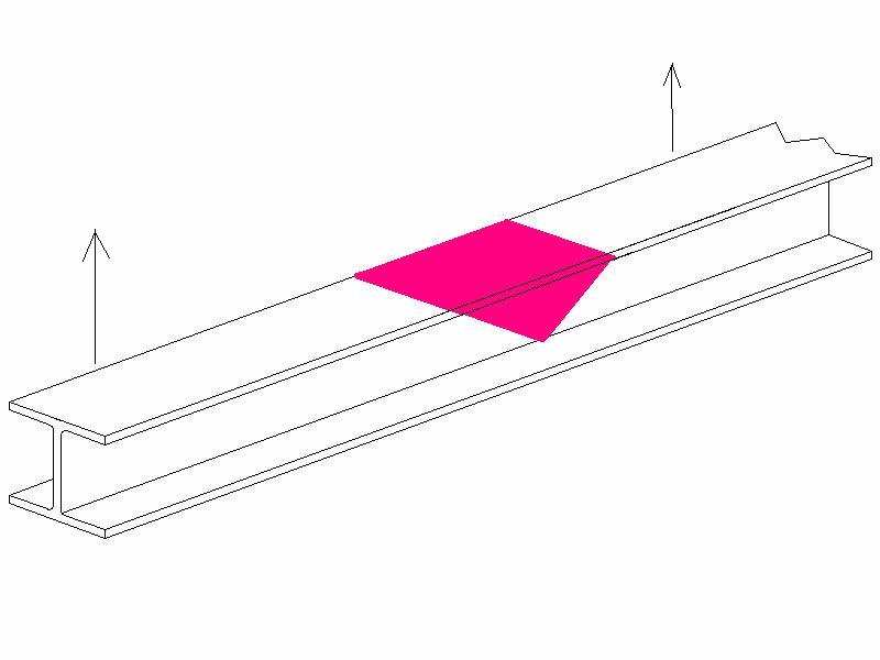

Without a torch, the chain and jack will work. But be careful I have a scar right between my eyes from doing something like that with a port-a-power years ago.
I can't draw on your pictures where you could really understand what I'm trying to say. If you had a torch I would heat on the bottom of the box tube like this first picture, it most likely won't be enough so then I would heat a V wedge like the second picture, with the wide part of the wedge on the bottom of the box tube, right under the C. And then a circle right in the center of the bottom on the box tube under the C. The bent angle iron I would also heat a V wedge with the wide part of the V on the bottom toe of the angle.

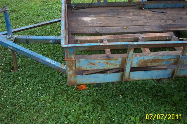

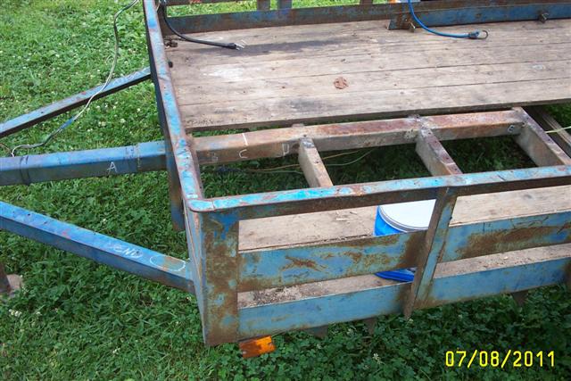

After bending with a chain and a bottle jack, it looks like most of the bend is gone, but the channel has bulged out unevenly on both sides as shown in the photo.
Since the trailer is sitting in my unlevel yard, I'm not sure if this has introduced a twist to the frame or not. I may have to tow it a bit and see how it tracks and maybe park it on my neighbor's concrete pad to see if it appears twisted.
Do you think I should hammer the bulges back in or leave them alone?

/ correcting bent trailer tongue #27
I'd hammer them back in. These little projects are so much harder with out a torch.
