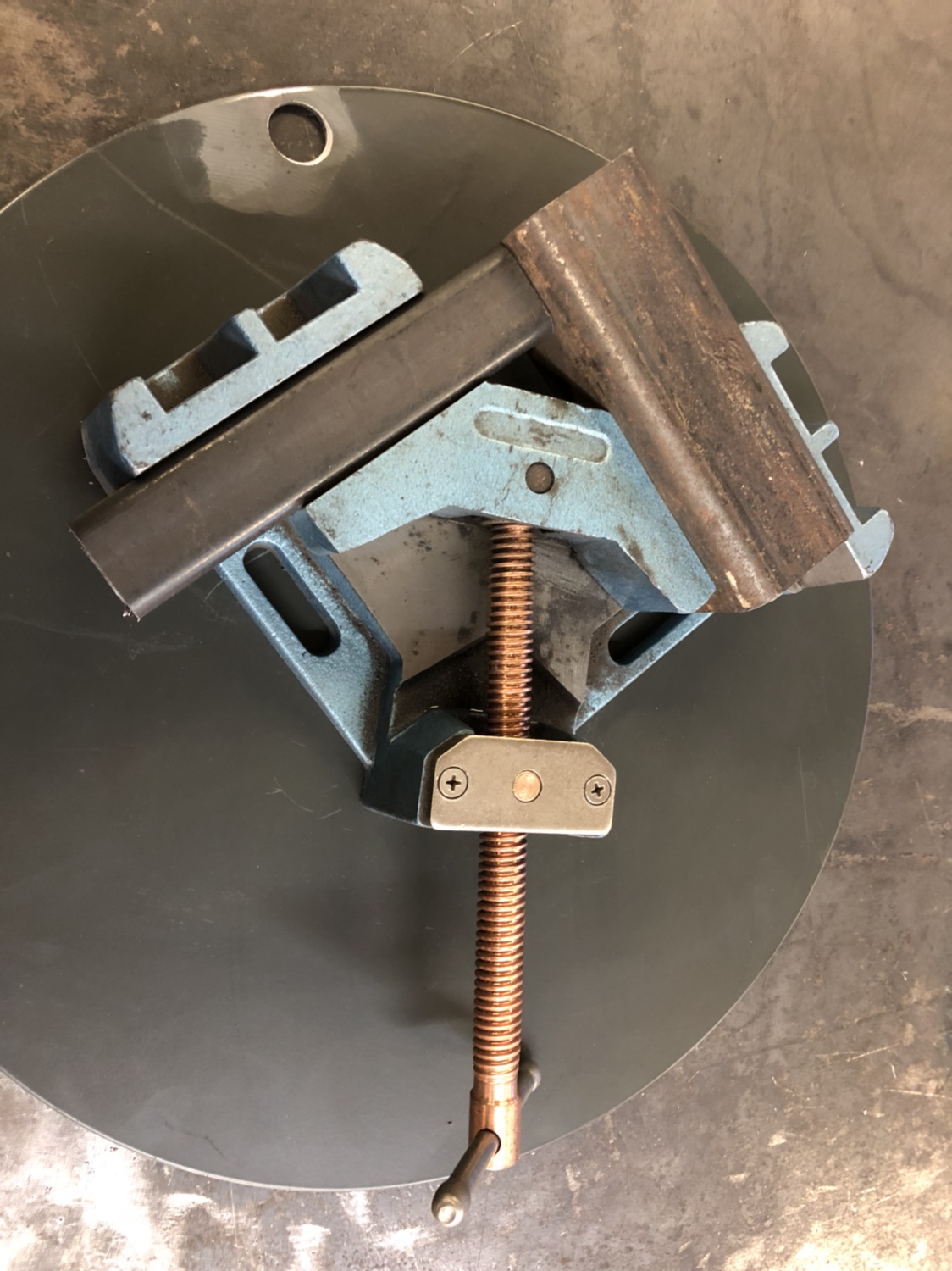

I find the corner clamps with just one screw too much trouble and haven't used the ones I have in decades. Trying to get both pieces of steel the right depth and level so you can tighten up the one screw can be frustrating. I have a couple of the Shop Fox corner clamps that are machined cast iron. They work good but you need to be careful with the splatter. It'll stick to the cast iron and the steel threads of the screw (like it would a C clamp.
/ Corner clamps #27
I tried the fireballtools clamps and they are simple and nearly idiot proof (which I needed). They are not cheap however.
/ Corner clamps #28
This is about true. Big supply of 11R and common Cclamps and I never use that kind of stuff. Clamp it to the bench, square and tack.
